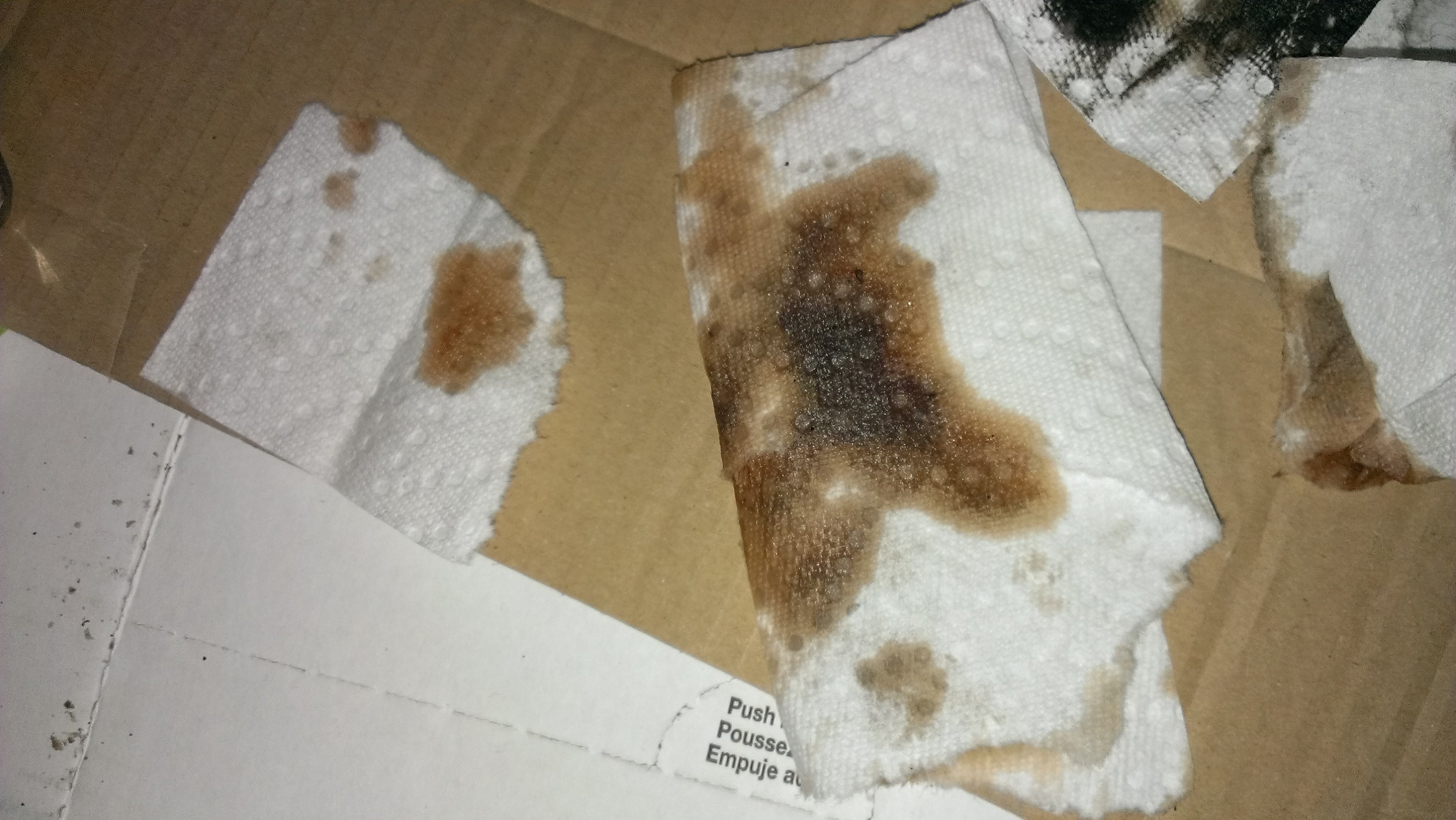

About to drive ~8hrs tomorrow. I just checked the car after it sat for ~1wk and noticed a puddle on the ground. Photos of wetness are attached. The puddle is oily and slightly red, and does not smell strongly. The picture with two napkins shows on the left a few drops of PS fluid from the reservoir, and on the right a swipe from the ground.
The PS dipstick shows it's low, though there's fluid in the reservoir and no lights came on while I was driving. I tightened the hose clamp to the top of the reservoir, which seemed to be a little loose. The bottom is one of those infernal Oetiker clamps. The whole reservoir is slightly wet so if it's PS fluid I don't think it's the bottom hose.

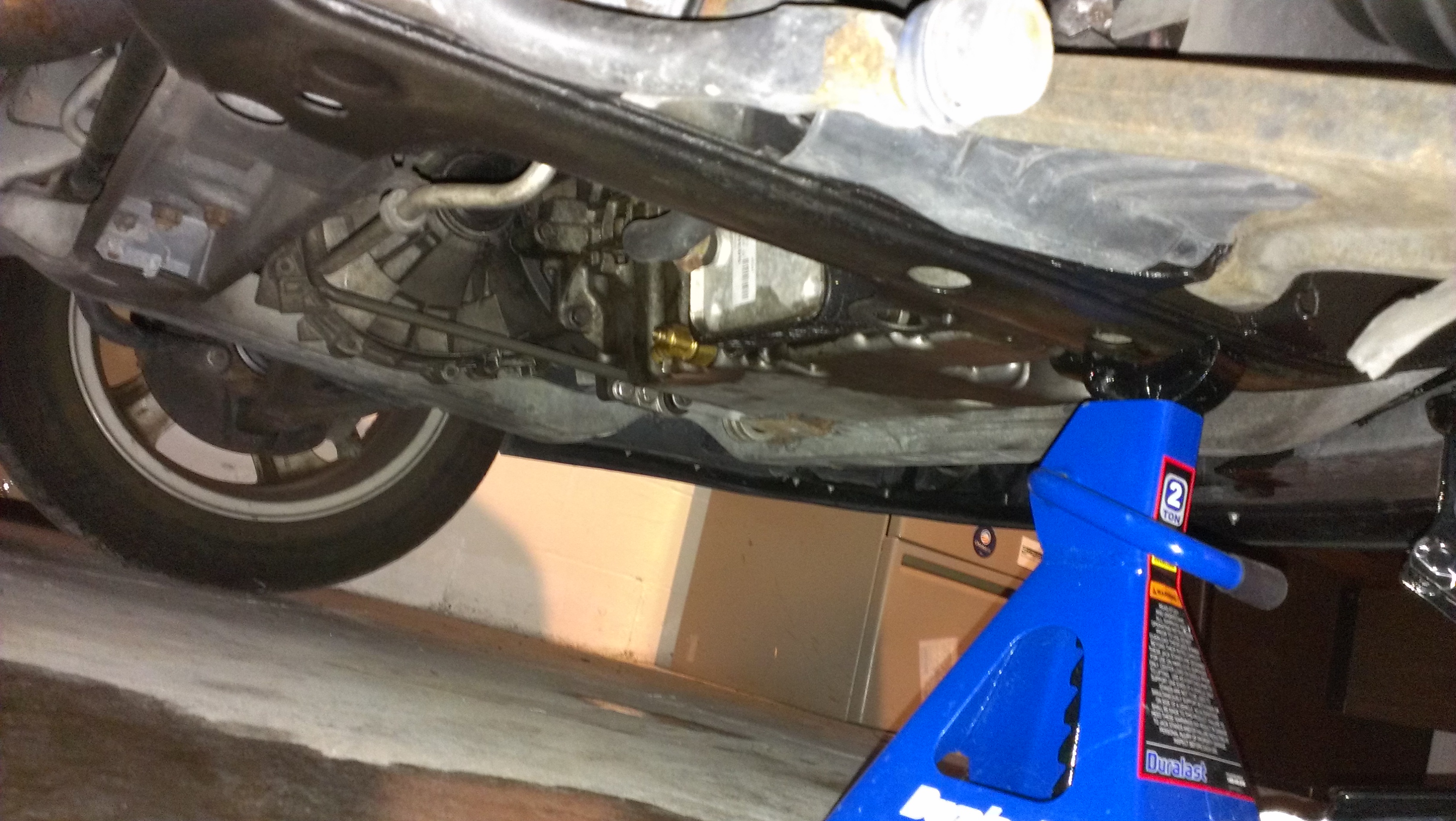

A picture of the underside is attached. I think it's all on the right side. Certainly the puddle I'm worried about is only on the right side under the car.
If it's a PS leak, can I just top it off? It's apparently not a huge leak, though that may change under pressure. I feel like I've seen the reservoir being sticky before, but I've never seen a puddle under the car.
EDIT: The right side of the transmission is totally dry. So it's almost certainly not trans fluid.
Big sigh of relief, though a failed steering rack isn't my idea of a good time either.

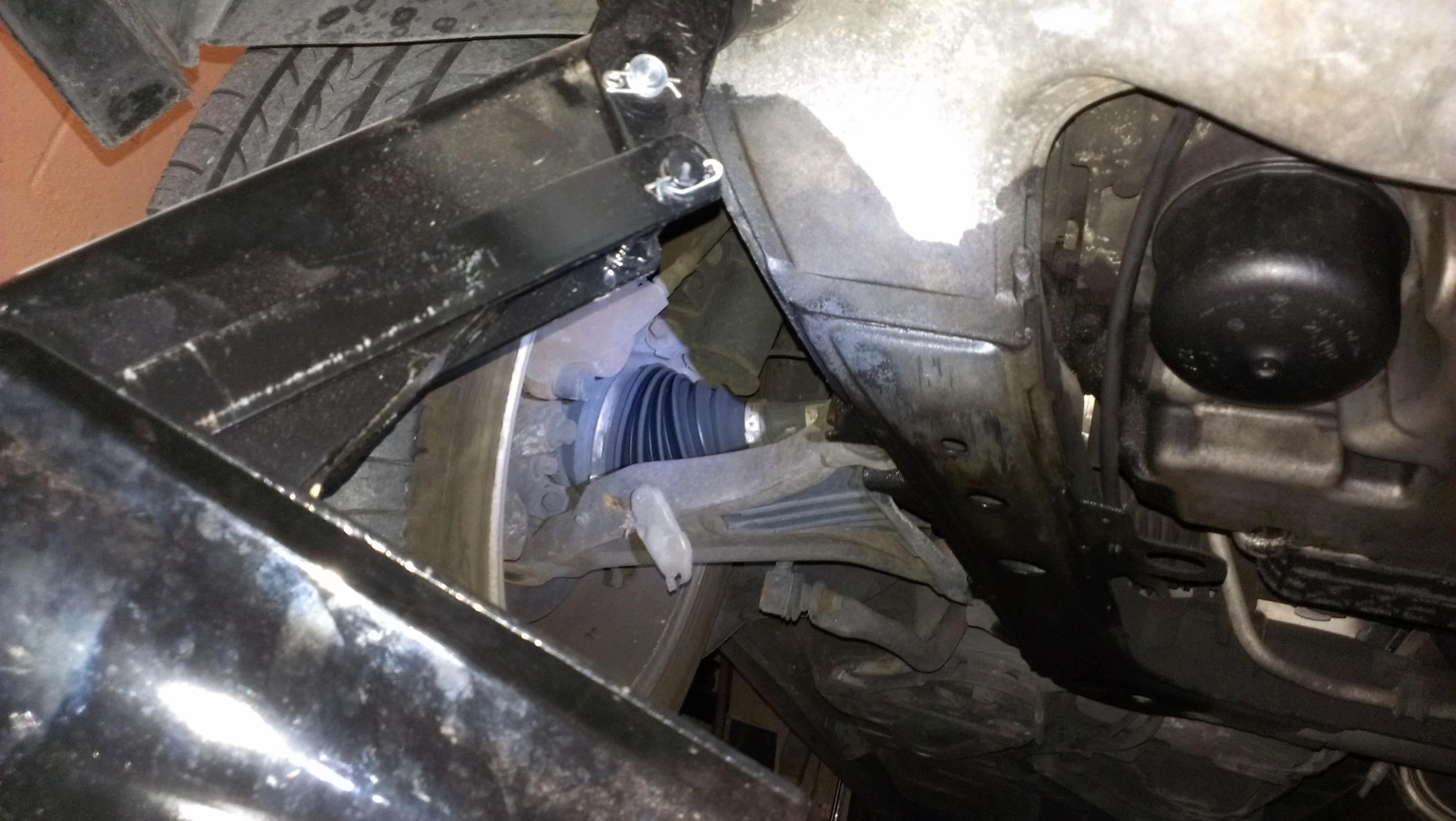

Go to the black pan in front of the trans between the rad and the pan. follow the lower rad hose from
the rad to the engine and you will touch the trans dipstick. All 5 spds (auto)have dipsticks.
I se fluid on the oil cooler on the back of the engine oil pan. Clean this with carb cleaner, dry the area and start motor to see if it leaks. dirt on cam belt side of oil pan suggests long term power steering leak but oil cooler must be ruled out.
Start cleaning up the entire area so you can start car and distinguish source of leak. carb cleaner, paper towels etc are your friend here.

nothing stronger than dish soap in this house, i'm afraid. I did my best to clean it up but I can't start it now as I will wake up my housemates .. and the whole neighborhood actually
That said the stuff on the pan is old and saturated with dirt. The leak on the subframe is wet. I also see a wet trickle down the tbelt cover from the PS reservoir so I am feeling confident that it's that. Nonetheless I'll take your advice tomorrow morning before heading out - let it idle a bit, warm up, and check for wet spots or leaks.
