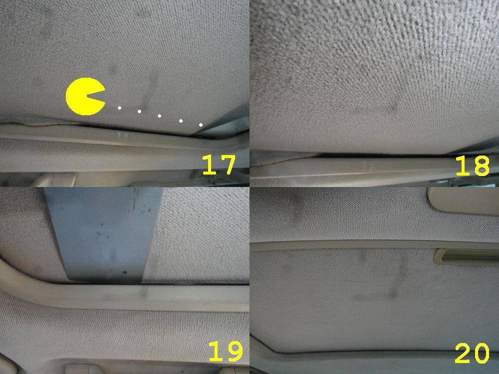

16. Pivoting one corner in an area already tucked, tuck another small section, and repeat working your way to the corner. DO NOT SLIDE THE TOOL STRAIGHT DOWN THE EDGE.
17. Again, the key here is taking a lot of little bites.
18. Work your way back to the corner being careful not to create a wrinkle. Once there, it's almost impossible to pull it out due to the adhesive without pulling all the fabric free again!
19. Work your way to the front in small swinging bites to tuck the other end.
20. Now you can press firmly (but not enough to damage the board) all along the liner. It should slide easier now without the sagging fabric dragging on the back edge of the trimming.
