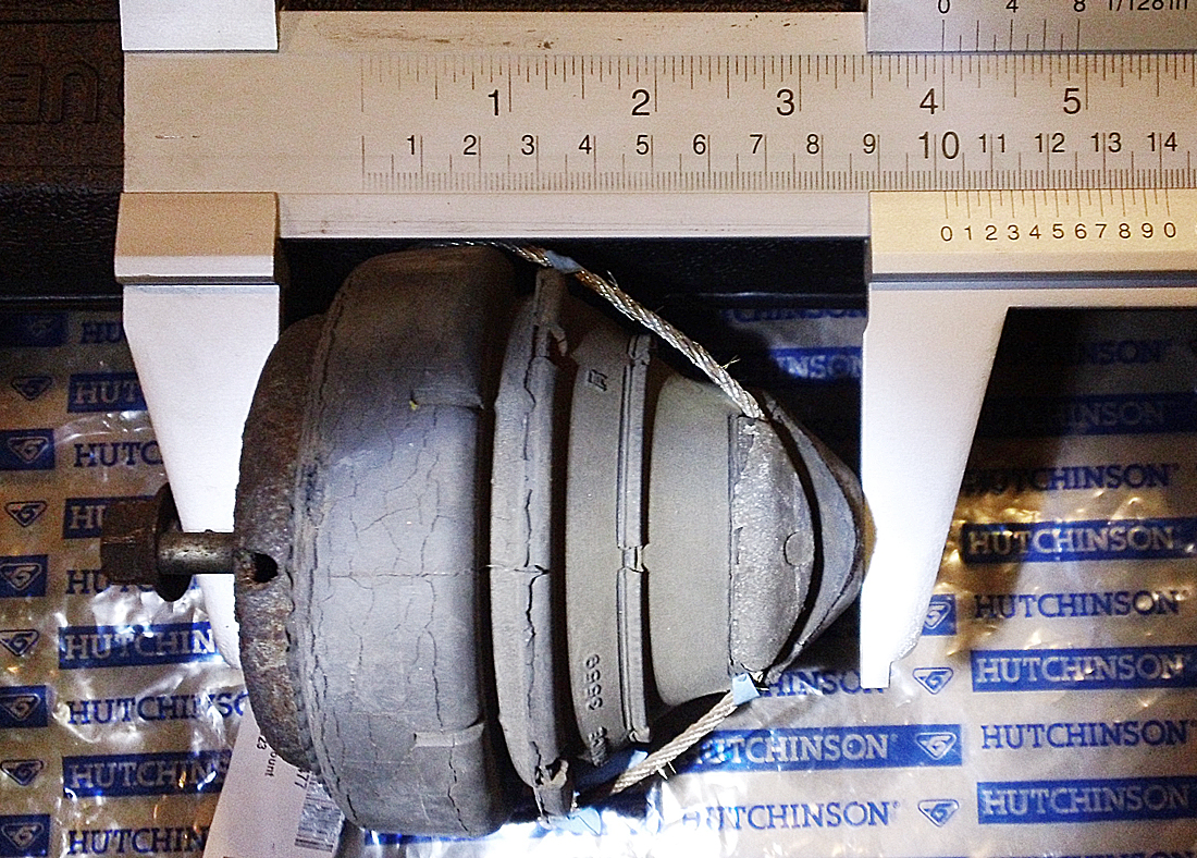

All engine and transmission mounts were replaced within past 18 months. Joy of driving is returning at each take.
Next, working on front and rear engine pad - buffers subframe. I have new Hutchinson (OEM) for front installed yesterday. Meanwhile here is how the original looks after 16yr/5mo with 130,000 miles on it.
Front engine pad - did it shrink a little
Front engin pad - up close

Nice close-ups. It looks like the original pad is about 4 in / 100mm tall. Out of curiosity what was the height of the new pad?

jreed wrote:Nice close-ups. It looks like the original pad is about 4 in / 100mm tall. Out of curiosity what was the height of the new pad?
Replaced the rear this afternoon.
Rear engine pad -
Rear engine pad -
Rear engine pad - up close
