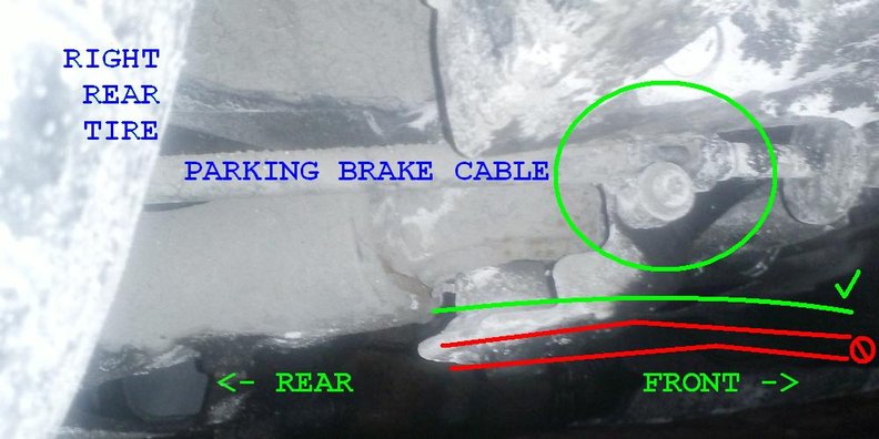

Posted this recently:
DIY: Parking Brake Failure Inspection ('98 S70 as ref')
If you're already down this far, might as well pull the shifter console so you can see if the cable pulls smoothly and freely both ways inside the sheath.
Also, at the very least, that brake assembly needs a good, thorough cleaning, rust brushed off (brass or steel brush), bearing cap installed, parts cleaned and greased on slide surfaces, backing plate/dust shield cleaned polished (to remove any high spots) and painted (corrosion barrier, inhibitor), and would do the same for any hub-to-drum/disc and drum/disc-to-wheel contact areas or you might find your wheel or disc cold-welded (rusted) to the car, "nearly" impossible to remove requiring a TRACTOR to get it off!. :shock: :lol:
Example from above DIY article:
burnout8488 wrote:This price seems too good to be true: http://www.eeuroparts.com/Parts/8771/Pa ... e-9485386/ $16 a piece… I'm still leaning towards Genuine Volvo cables, but 16 bucks….
Says for 1998 S70, but the drum-side end (both cable stop and sheath end) does not match. See photo showing both ends in the DIY link above.

I should have mentioned first, the picture I posted is not of my car. The picture above is from another thread on this forum. Mine are clean :-)
I totally serviced my parking brakes a few weeks ago, and they're still "sticking." I've pretty much ruled out everything but the cables at this point, it just makes sense that they're hanging up. Gotta get outside and pop the console off to see if I can push the cables back after yanking the lever up….
