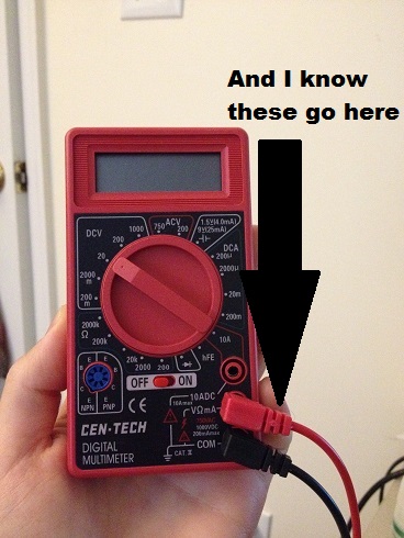

I have this:
As to where these go:
I'm open to pain-less suggestions.

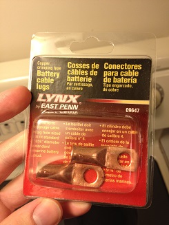

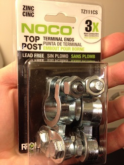

A: Building better battery cables.
I am an electrical novice, so I want to be sure I do this correctly.
I have these:
and these:
Now from what I can tell thus far, all I need is the proper gauge wire.
Summary:
This is my primary question: I have no idea what to look for (or even where to look for) in proper battery cabling. I figure 100% copper is good.
I would really appreciate knowing:
#1: The wire gauge (what you recommend, I think stock is 4 gauge?)
#2: The lengths, if you know it
#3: How should I go about connecting the block ground to the chassis/battery ground wire?
- combine them into one "cable lug" and crimp it?
- use a separate "cable lug" for the end of each wire and then stack them on the chassis ground point?
#4: Anything else I should know about making my own battery cables?
