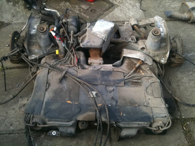

Thanks for replying . I must be short of parts or I must have connected some hoses wrong. Added a picture
of the fuel tank . could you mark out where the return line should be connected to the tank ?

Ahh, now that you added the pictures I see that you were actually asking about the XC tank, not the 850 tank. My guess is the return line is the second line on the transfer pump which is on the left hand side (right hand side in the picture) of the XC tank. The second line there wouldn't really have any other purpose.

yes , but i am using a tank from a v70 awd 98 mod, it is pretty much bolt on on my 95 mod 850.Ozark Lee wrote:Ahh, now that you added the pictures I see that you were actually asking about the XC tank, not the 850 tank. My guess is the return line is the second line on the transfer pump which is on the left hand side (right hand side in the picture) of the XC tank. The second line there wouldn't really have any other purpose.

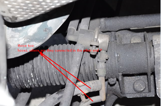

only fuel line i have with the v70 tank is a dobbel hose that goes into a valve just before it is connected to the fuel pipes on the engine, and i can t seem to find any other connections on the tank.
it is the valve on the pics , two fuel hoses in and one out to the fuelrail. But there is also to hoses on the top of the valve..... looks like vacum hoses to me
can t find any better pic then this of the valve
the biggest hose with the clamp on, is that the fuel return Jon

At the fuel tank the return line is the one that can be traced to run across tank to the driver's side sender unit. The return line flow goes there to run through the ejector pump and then a line from the driver's side goes over to the RH side sender/pump.
Hi Jimmy, thank you for replyingjimmy57 wrote:At the fuel tank the return line is the one that can be traced to run across tank to the driver's side sender unit. The return line flow goes there to run through the ejector pump and then a line from the driver's side goes over to the RH side sender/pump.
ok, but where is it connected to the fuelrail, i don t have any connections left on the tank
