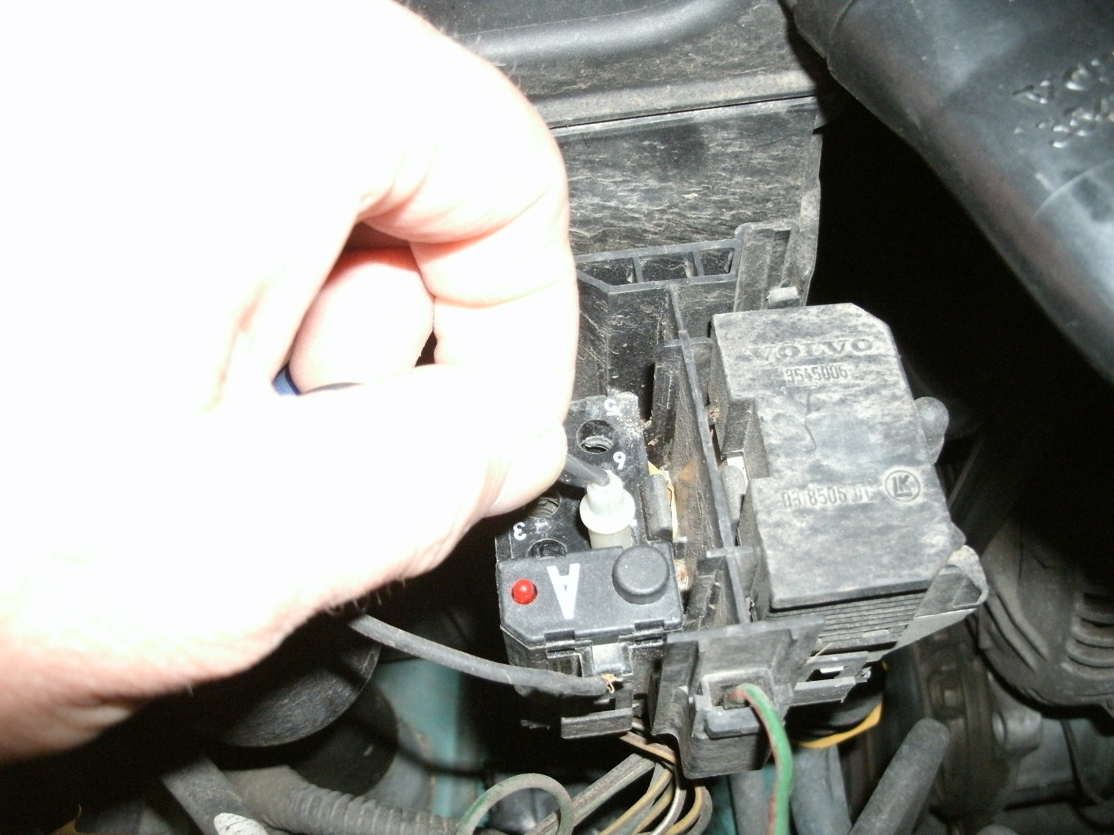

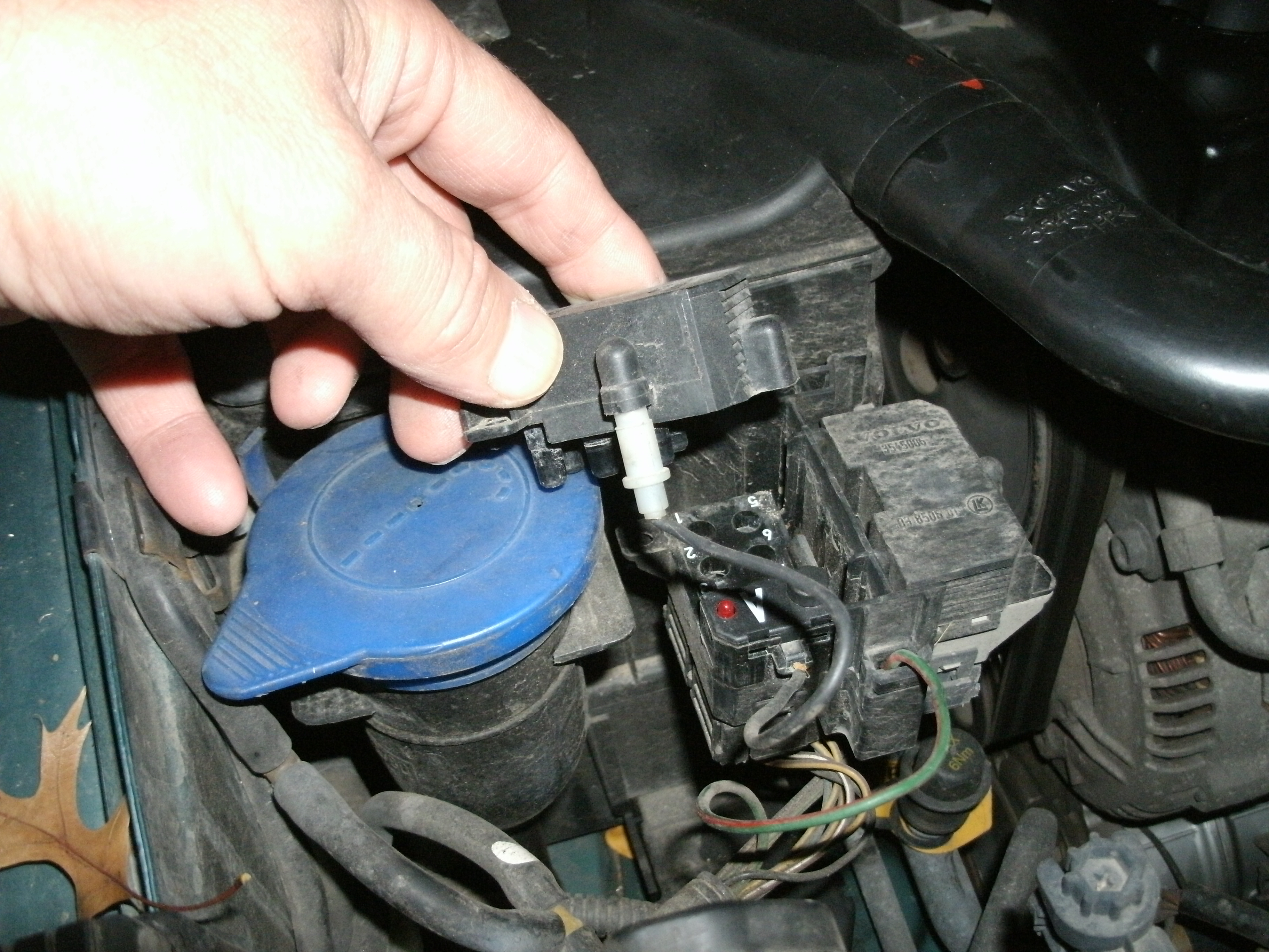

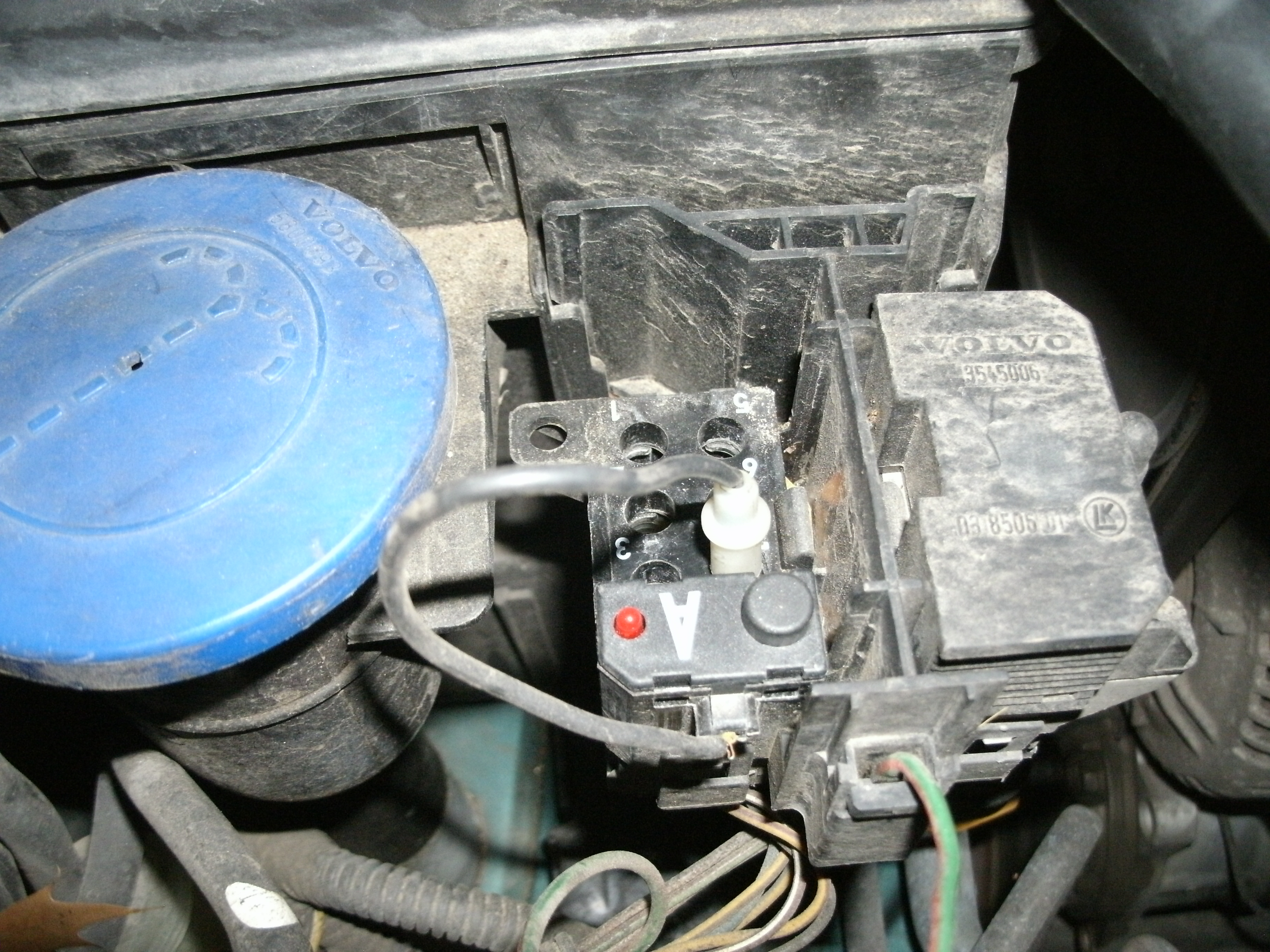

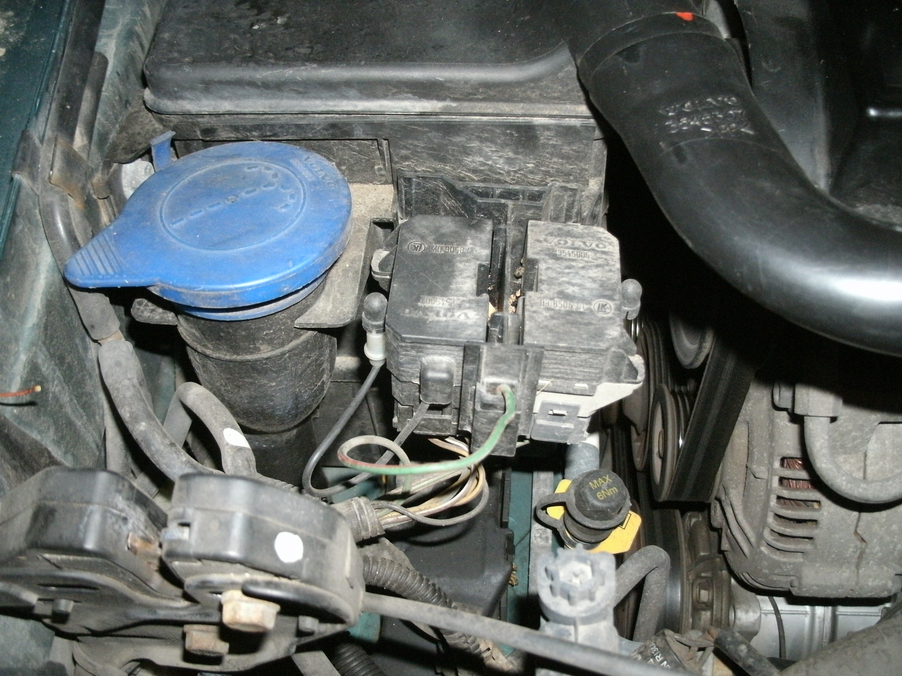

There are a number of things that could cause your problem but codes would really help. Since you have a '95 you have the code reader built into the car under the hood.
The DTC box is just behind the windshield wiper fluid filler top and it is marked A and B.
Put the flywire into port A-2 and see if you have any codes. Also try port A-6, it may or may not read anything but we need to know if that port is active to make sense of the other codes.
To read the codes press the button next to the letter A and then use a pen and paper to write down the flash sequence. There may be more than one code so write down all of the sequences. They are all three digit codes.
