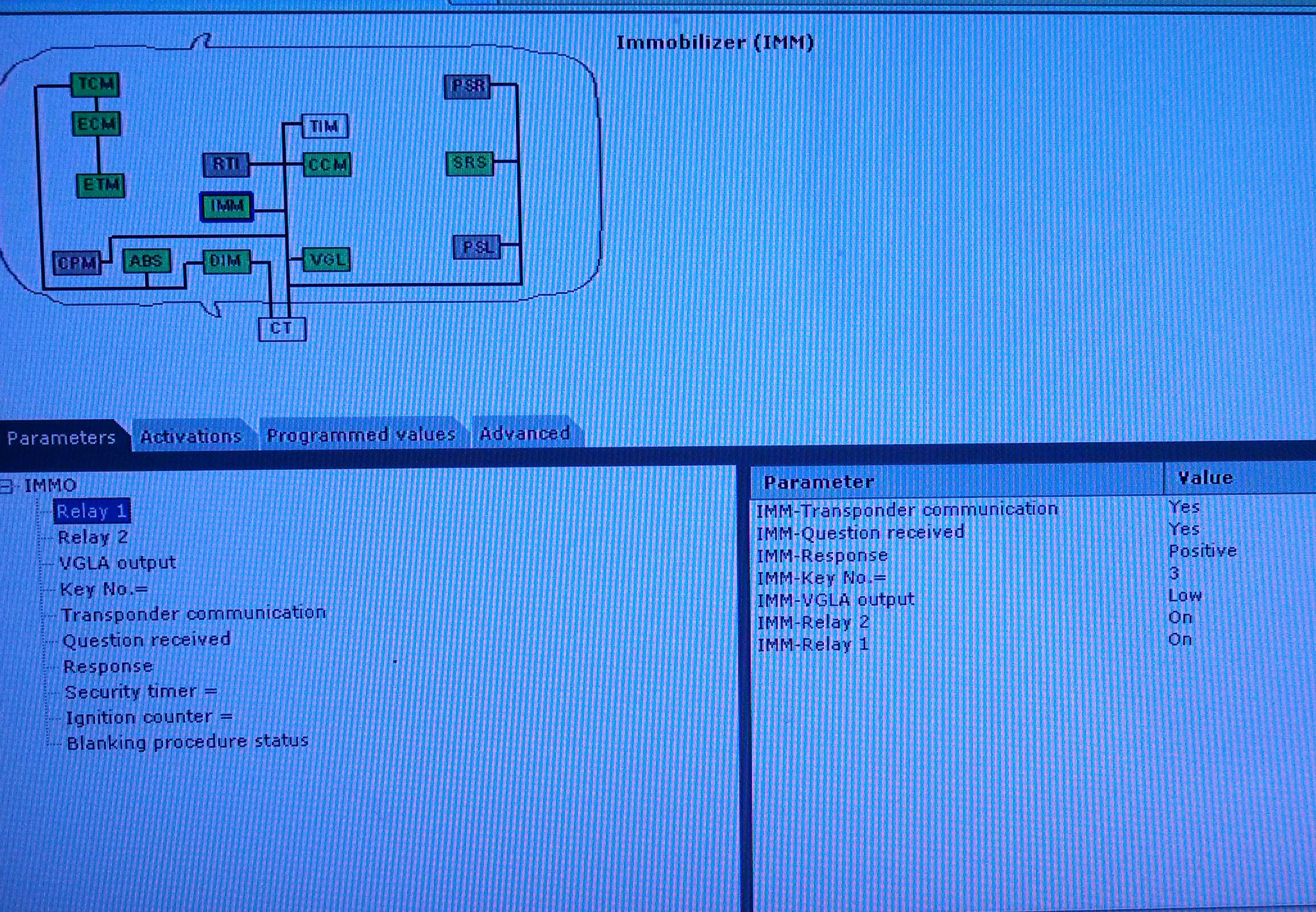

I did a quick check with VIDA and tried to check the immobilizer functions to see if that is my problem.
I will attach a picture of the screen shot. Maybe one of you can decipher and explain the values I got.
I see the two relays are on and I am wondering if that is why it is not starting...... it the immobilizer active?

From the VIDA screenshot the immobilizer is working fine. Typically when there is an immobilizer problem the car will start but die after about 1 second.

Do usual checks as though immobiliser is fine ie fuel and spark. Immobiliser cuts spark so if no spark THEN suspect immo.
