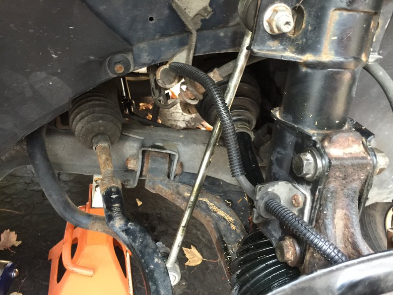

EDIT: Just read MattyMoo's ABS troubleshooting page. I did recently replace the front driver's side hub. I removed, cleaned and replaced the sensor. I'll make sure the axle bolt is tight. I also see a voltage fluctuation all the time. For instance, if I turn on the blower, the headlights will dim for a moment.

It's really easy to break those sensor wires when you work on the hubs Russ. I just pulled mine a bit too much and separated the wire inside the sheath, no visual.

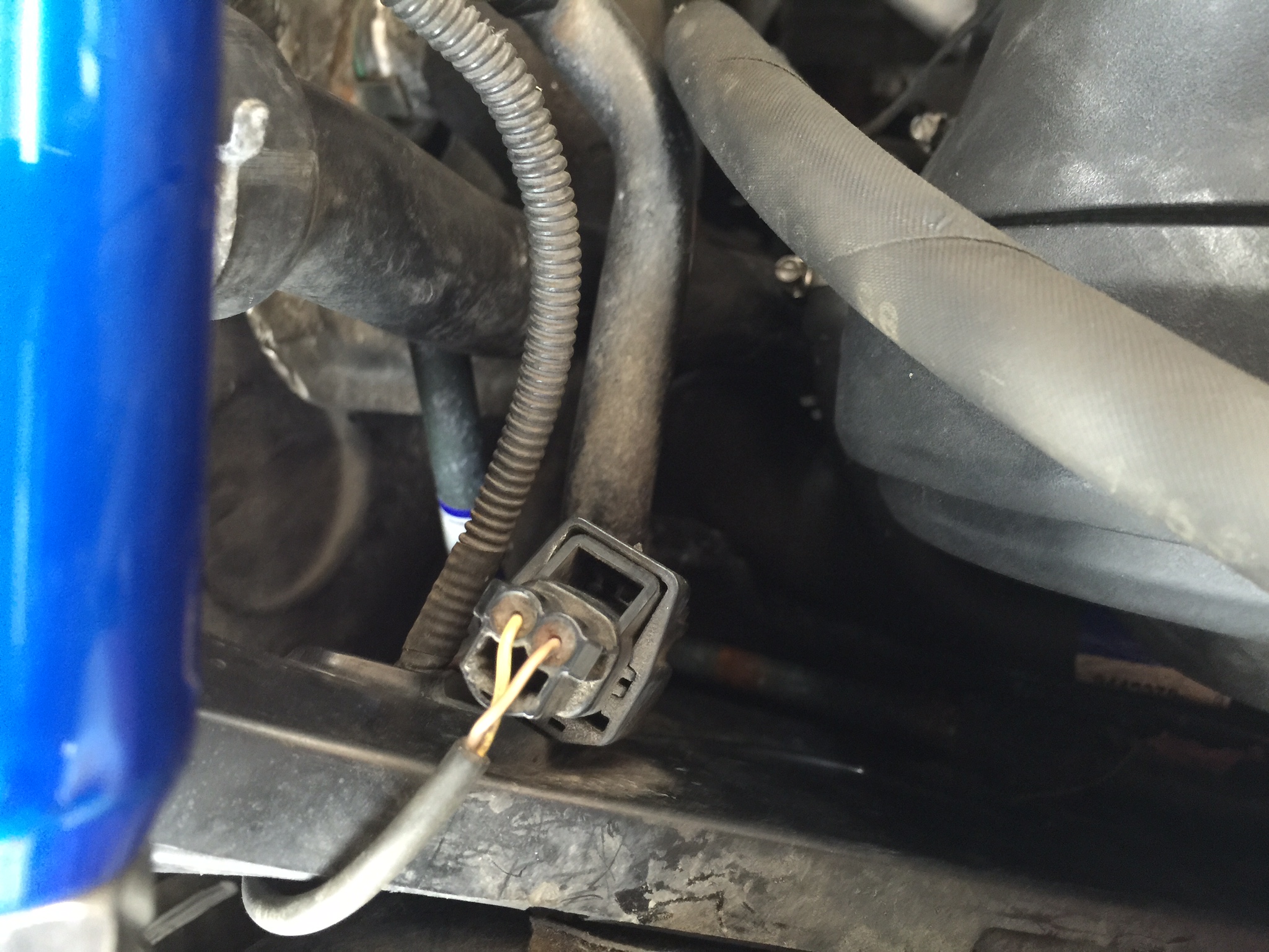

Easy to check continuity on the connector as it's nicely next to the shock towers...you don't even have to go underneath? 2000 ohms +_ 10% for an ABS sensor I think?
Once the ABS unit stops getting speed inputs from either wheel, cruise control on fly by wire cars gets disabled in software.

I was afraid of that...I also replaced the struts not too long ago

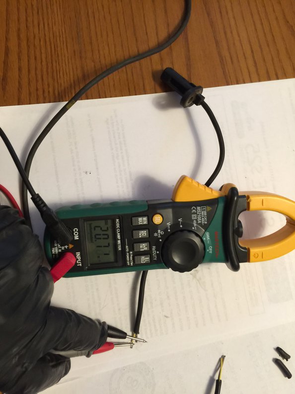

Damn, just checked resistance with my meter, one measures in the meg-ohm scale.
EDIT: did some more investigating. The actual sensor for one wheel is bad. The wiring checks out OK

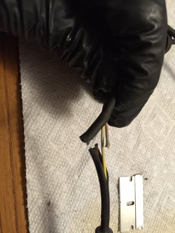

I already pulled both sensors. One was fine, the other had a connectivity problem right where the wire enters the sensor. I peeled the insulation off the wire about 3" back from the sensor, and re-soldered the wiring harness to it. As long as the wires from the sensor are vertical, it seems to work. This a very temporary fix, the new one has been ordered
I was surprised at how important the wheel sensors are in an ME7 car. When shifting from 1st to 2nd it was as if the computer was cutting power to the engine. Even the idle was affected, as it wavered a few 100 rpm. As was already noted, there was also no cruise control
