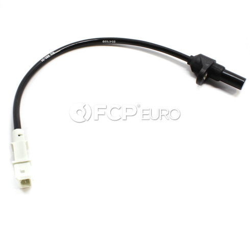

Is it this guy?

Re: Mystery wire...
Post by [email protected] » Wed Apr 13, 2016 10:17 am
Solved. Marco has it. At some stage someone has swapped out the crank position sensor and left the old unit hanging about in there. The actual unit was JUST visible at an almost impossible angle, tucked up under the assorted cables & "stuff". The lead went down behind the engine upper mount plate and looked as if it emerged from the head area. NOT easy to see exactly what is going on round there :-)

Post by theWIFES_S70 » Wed Apr 13, 2016 11:07 am
Oh my gosh, someone left an old crankshaft position sensor in there? I would've cut the connector off if I couldn't get it out. (You never know when you'll need a connector!) That's nuts, though. Glad we figured it out!
