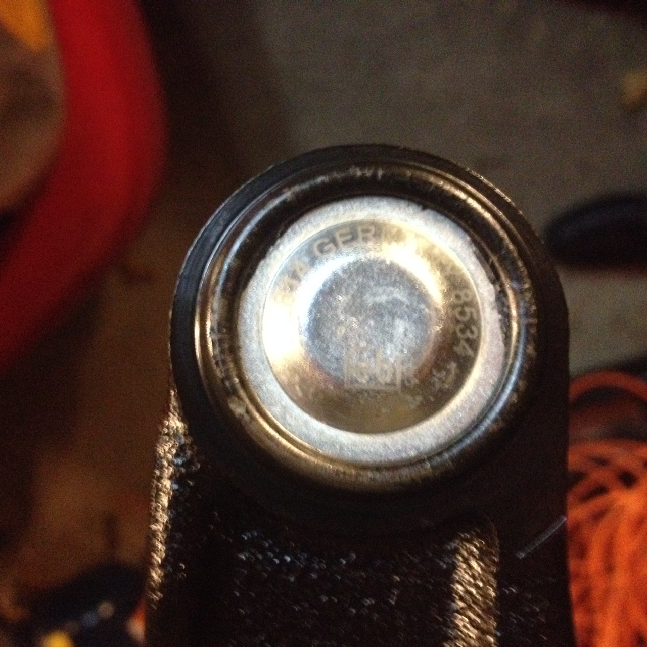

The build quality on the Febi seems very good, I don't see any noticeable difference in the design or build. The part as indicated on the box has global components from Germany, Italy, Taiwan and China. The ball joint has Germany written on it; that is what failed on my original control arms.
I suspect the casting is done in China because energy is very cheap there; then it is sent to Taiwan for precision machining, then to Germany for final assembly of the German made ball joint and probably Italian made rubber bushings. You need high quality, hard steel for ball joints, and German steel is known to be very good for this.

The ball joint on the Febi was very smooth and tight (no slop). Comes with new bolts.
