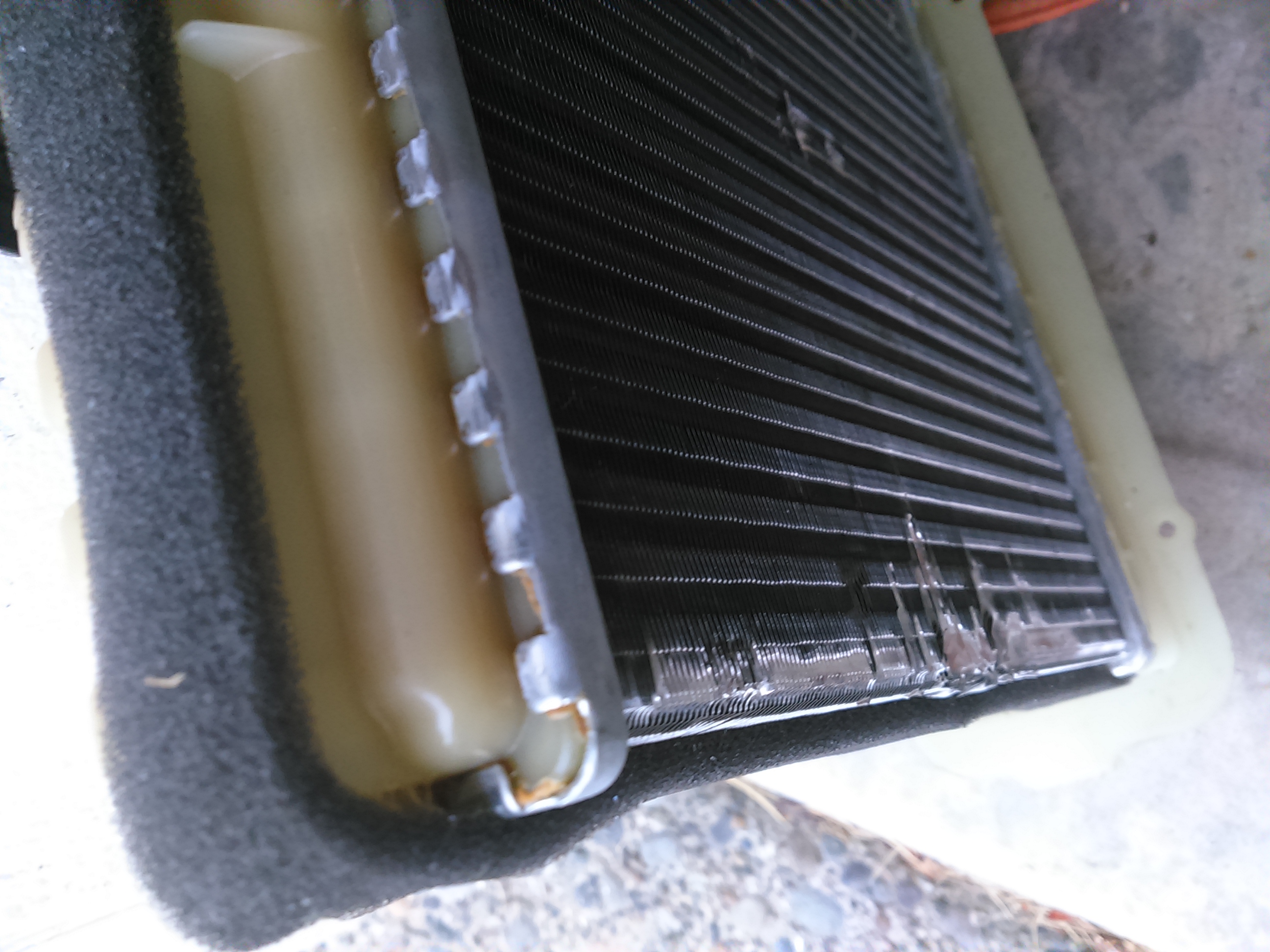

I know the Swedish Auto Parts $40 heater core is fairly popular here and thought I'd share my experience with it.
I replaced the stock heater core in my 2000 V70 at around 125k miles with the SAP ebay core back in 2013. Currently my car has 150k.
In the past few months I started losing coolant and couldn't find any obvious leaks until I was vacuuming my car and noticed the damp floor under the floor mats.

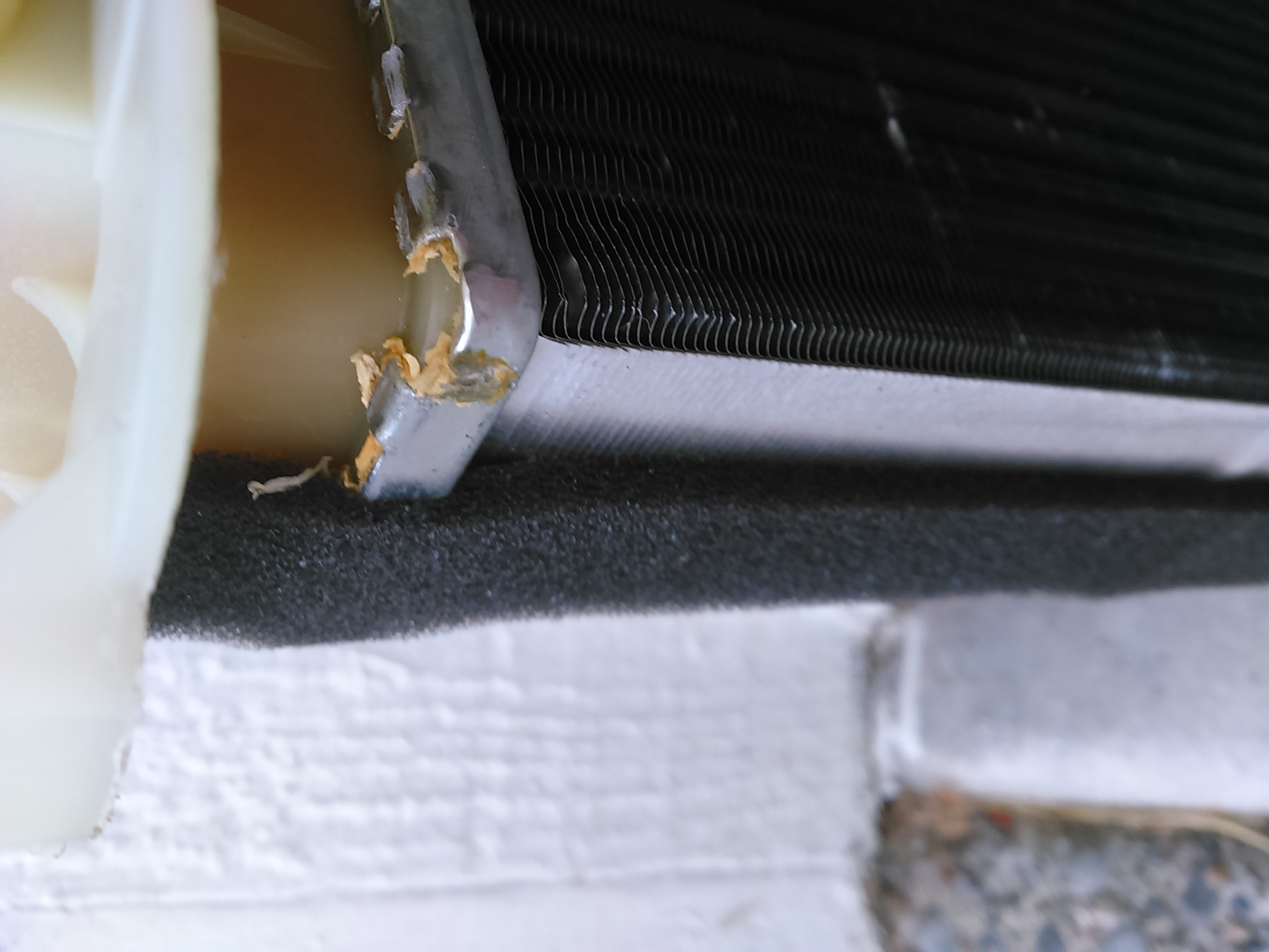

Pulled the heater core and it appears to have been leaking around the corners, there was orange crust on two of the corners. I also happened to find one of the old O-rings I left under the carpet. Based on another post I saw on this site commenting on the undersized O-rings that come with the SAP core I took a few measurements. The OEM Rings are slightly larger at about .81" O.D. versus .78" for the SAP rings. Both fit into the SAP core fine, but the OEM rings are a touch more sung. Also I noticed the SAP rings have more of a square profile versus the round profile of the OEM rings, I don't know that makes any difference, just an observation. It's possible my heater core was leaking at the O-rings as well, but it's hard to say.

Hey AngrySquid, sorry to hear about this. Just a question, what sort of coolant were you running?
