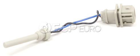

You probably have a coolant level sensor (https://www.fcpeuro.com/products/volvo- ... -uro-parts that is on the outs. (Guys, I have no idea why the link has the words URO in it, this is for the OEM version!)
It's a relatively cheap replacement. But before doing that, you could try disconnecting the connectors and cleaning them with something sensitive like MAF cleaner, letting it dry and then reconnecting. I've had a lot of luck doing this with fouled up connectors. I noticed that the connectors were really dirty when I did my timing belt job. It's a pretty essential sensor to have working on your car so make sure you take action!

For $25, I wouldn't mess with it. Just replace it with a new Volvo sensor.
That coolant level sensor is your first line of defense to prevent coolant loss and engine overheating when:
- the heater core decides to takes a dump
- the plastic neck on the radiator decides to break off
- one of the turbo coolant hoses decides its had enough oil leaking on it
(yes - I've experienced all three).

I just disconnected the sensor and tested it.
I get an open circuit across the terminals, and when I put a magnet near it, the circuit closes.
The same thing happens when I connect it to the car - when the sensor is connected, the light comes on. When I put it near a magnet, the light goes out.
This leads me to believe that the sensor is ok, but the floating magnet in the tank is not floating properly
Is this a thing? Could this have happened when I inverted the bottle?
I can't open it to check it yet because the car is hot and I'd rather not cook my hand.

I let the car cool down and opened the bottle.
I used a screwdriver to push the float down, and it appears to be working fine - it moves freely and pops right up as soon as I take the screwdriver away.
The light stays off since I pulled out the sensor and replaced it, although I haven't driven it far yet
I did clean the connections with MAF cleaner, so some combination of what I did seems to have worked, at least for now.
If I get any more problems, I'm going to suspect the car side of the wiring, as the sensor appears to be in good shape.
It's possible that I just dislodged the sensor the first time around, and removing and replacing it fixed that.
We'll see I guess...
