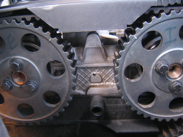

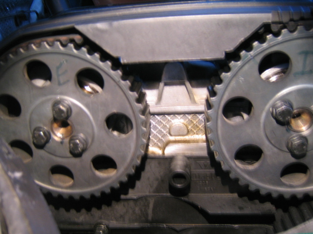

I read multiple threads on cam timing and took photos of mine before & and after. I have yet to reinstall the TB hydrlc tensioner. Currently, the tnsr pulley is being pulled on with a bungy. I've rotated the crank CW a few directions with the TB reinstalled, but the cam marks no longer line up. Are they supposed to AFTER the pulley/camshaft relationship has been altered or not?
I am able to move the crank by hand, no indications that anything that shouldn't be touching, is.

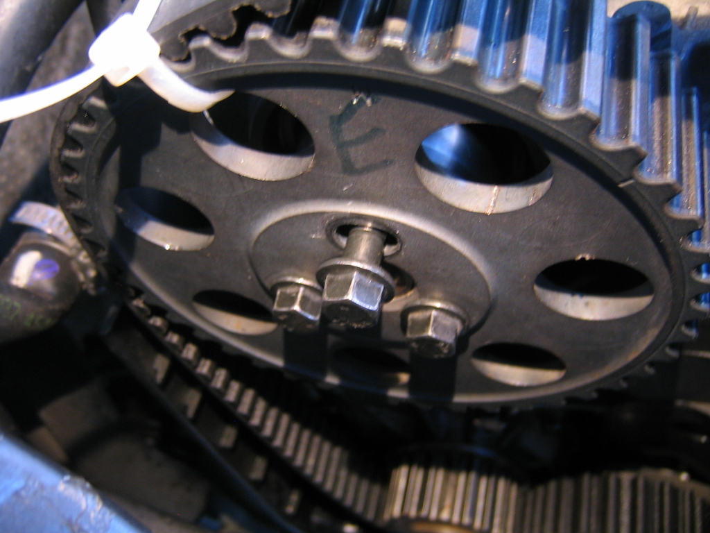

Here's the initial position after the crank was rotated to center the marks. When turning the crank CW, the top of the belt between the two sprockets moves from left to right. So both intake & exhaust have passed their alignment marks by half a tooth.

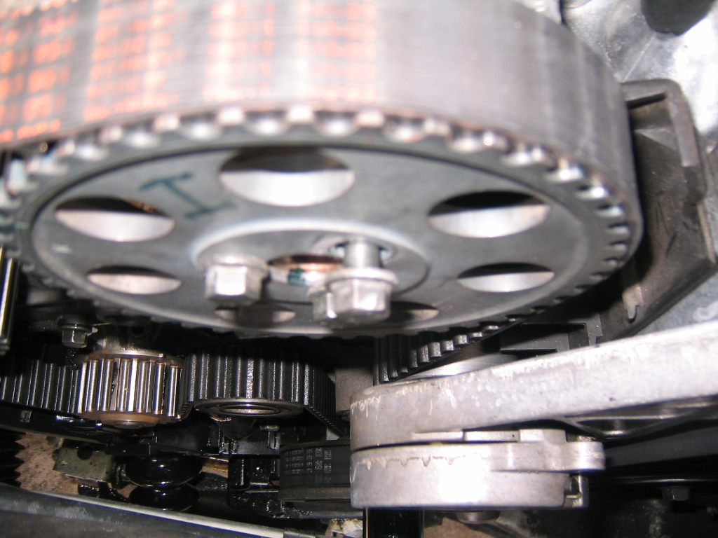

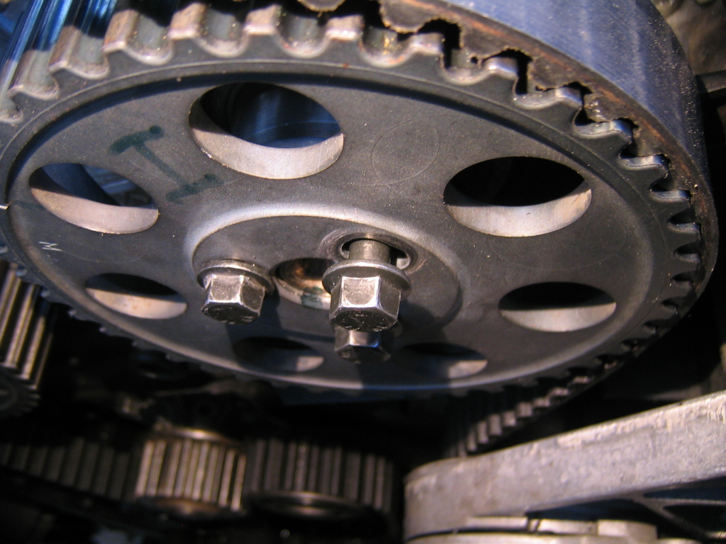

Loosened one Intake bolt while TB still under hydra tension. Here it looks about in the middle of the oval slot.
Repeated the above with the Exhaust side. May be a bit to the left, indicating retarded.
Upon reassembly, I decided to retard the intake a bit and advance the exhaust, as recommended for turbo cars. Here's the new setting for the intake. I meas. the right side gap at 3mm. Dead even would be 2.5mm as the max slot width meas = 11mm and the bolt dia on the unthreaded section = 6mm. This leaves 5mm or 2.5mm/side when centered. Thus there is 0.5mm of retard.
The exhaust here I left in the middle. It may be a smidge to the right.

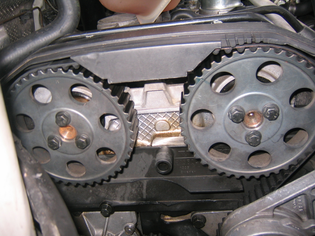

After spinning the crank CW two full turns, then lining up the crank, here's how the cams look:
Actually, now that I get a good look from inside, viewing this photo, it shows they're about the same distance ahead of the TB Cover index marks. Both camshafts were rotated CW a bit due to tightening the sprocket bolts before reinstalling the belt. I did move them CCW a bit to return them to their original position.
I'm thinking that if I removed the belt, rotated both sprockets one tooth CCW, then replace the belt and rotate a few times, I might be lined up.
Weigh in with suggestions, words of wisdom & advice!

I think you are correct. That is actually pretty common if there is a bit of slack in the belt as it goes across the idler before the grenade pin on the tensioner gets pulled. The trick is to have that part of the belt where it comes off of the crankshaft and across the idler taught as it hits the intake cam sprocket.

OK Lee. Thanks for the over-the-shoulder look and reply. I did notice some belt slack as this month-or-two-old new belt is much looser than when new AND I've never removed any belt before, then put it back on. A few months ago was my first time to remove any TB period. The past two times it was due I paid someone else.

Finally got them back into proper alignment after multiple crank spins. Working with a loose TB is A LOT different than a tight one.... Another issue was finding a suitable piece of wire strong enough to withstand the tremendous force of the HT. It bent all finishing nails that would fit. A HSS drill bit is too long to extract when the HT is installed. More waisted time. I finally found a piece of very stiff wire that would fit and not bend. I'm going to specially label it so I can easily find it next time.

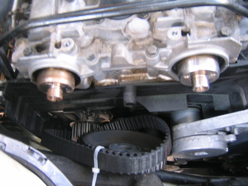

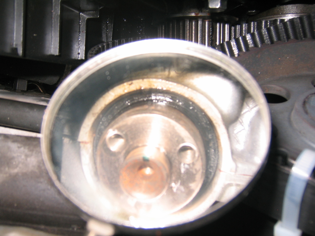

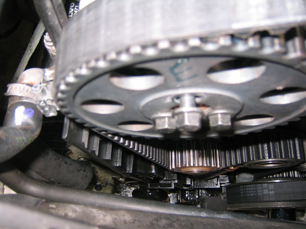

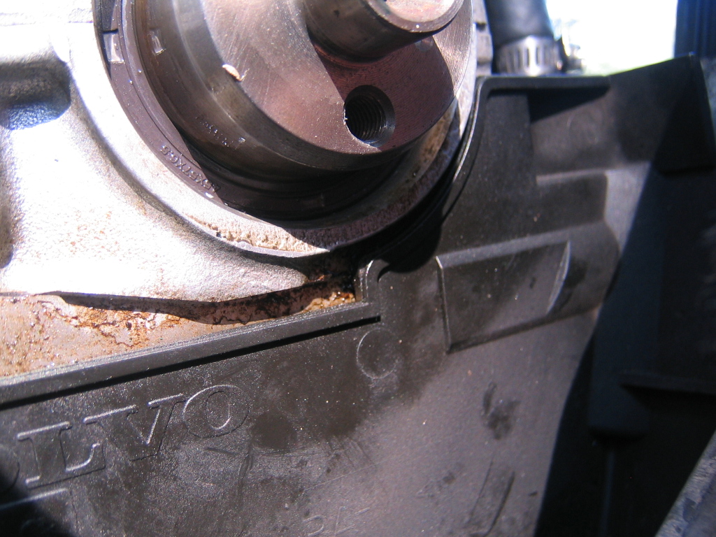

Reflections On Seal Removal & Installation:
I wanted to close this loop before too much time passed. I used CN90's excellent guide and wrote out the procedure beforehand to save time & frustration searching for the correct socket size, doing things out of order, and be sure I didn't forget anything. Though I initially thought the main oil leak was due to the rear, I intended to replace the intake as well.

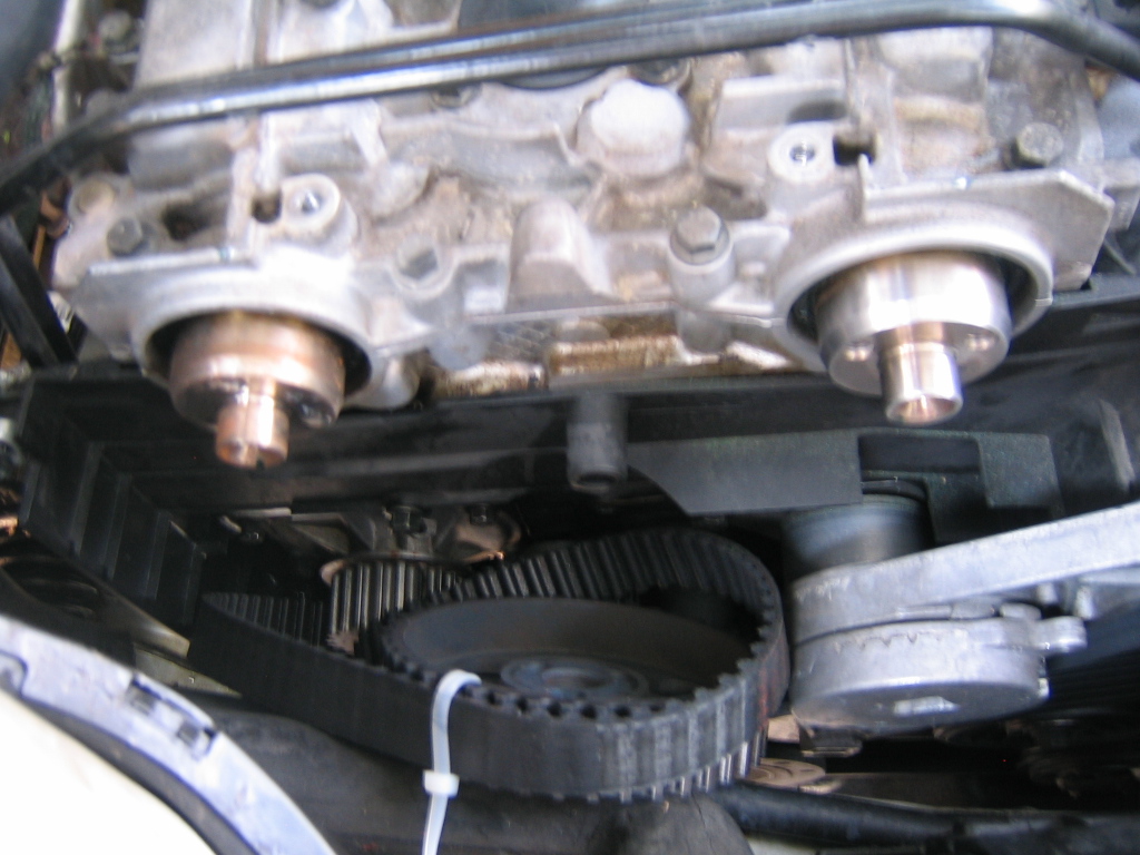

After removing the sprockets, I looked underneath for oil: Underside of the front seal, showing a leak.
Underside of the rear seal, also showing a leak. Both lower areas are wet and traces of oil can be found where they ran back towards the block, then ran down the front of the motor, behind the plastic TB shield. The rear leak will quickly turn the corner to the backside of the motor, and dirty up the coolant connection before continuing its path down to the bottom. I thought I may have even had a coolant leak there. Fortunately, not so.

Here's the difference between a polished surface and a "rough" one: - Using the paint-can-opener CN90 recommended, I attempted to slide it between the camshaft & inner seal. No joy...not even close. The inner lip was rock hard. Mine were a bit deep, so I couldn't get the angle right either. Next up was an IC chip puller, with a longer reach. No joy there either. Finally, I used a very small jewelers screwdriver. I could wedge this in, but no way it was strong enough to pry with. So I used a very tiny drill (3/32") to drill a hole, then threaded in a #6 PB screw with a very coarse thread. Fine or normal thread would work here, just didn't have one.
With that done, I carefully levered it out using long-nose pliers and a block of wood for a fulcrum. A few pieces of the front face cracked off while doing so. It also left behind pieces. I carefully flicked these out of the way using a Q-tip so they didn't fall into the oil slot. Then cleaned up this area with a fresh one. - Cn90's trick of using a 1-1/2" PVC coupler was spot on as was removing ~ 26mm of it so the existing sprocket bolts could be used along with the sprocket to slowly squeeze the new seal into place......after first lubing it well with oil and twisting it onto the end of the camshaft. This technique worked fine and ensured the new seal was "square-on", with no draging on the critical inner lip.
- I verified the inset was consistent at 6mm, but ran into a problem with it being around 4mm on the bottom. Closer inspection revealed that the outer surface of the head wasn't in the same vertical plane as the upper camshaft cover. Instead it bulged out a bit and was rough as seen here:
- Extracting the old rear seal was more difficult due to the strut tower. I used the same procedure as above, but it took longer. This seal was very tight and came out in more pieces. "Hardened & fossilized" describe its condition well. Only a screw would remove it. Installing the new one was the same as above.

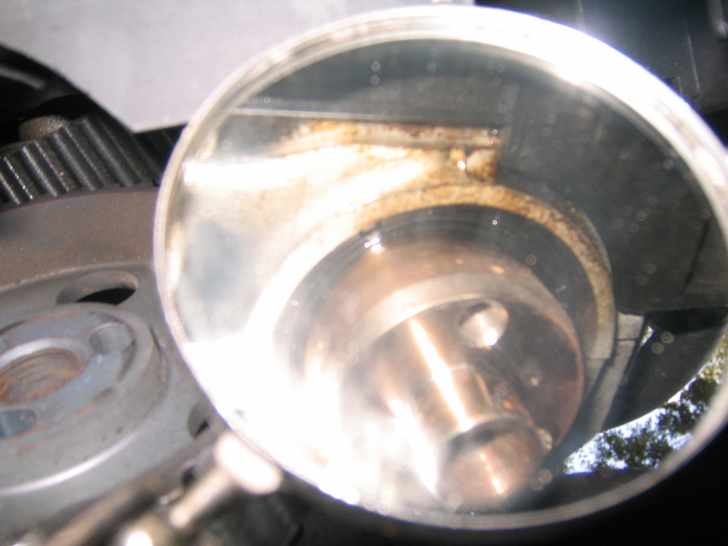

- I used a small inspection mirror on a wand to fully inspect the inner lip of both seals for any abnormalities.
