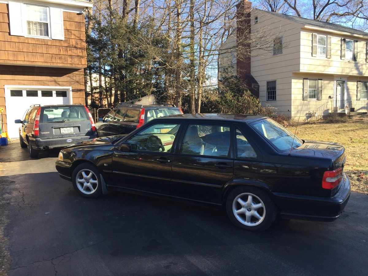

Got Evita the new V70 S70 into the garage and evaluated seized engine. Started a maintenance thread to record for now. If I make good progress, Ill create a 'how to recover a seized engine thread"
Sneaked out into the garage over lunch and the potion has dropped! I will try spinning the crank pulley tonight. Have to work in NYC tomorrow, if I am lucky I will take Friday and see if I have a runner!!!
Irish bookmaking odds are now up to 50-50 on Lady Evita Recovery
From my maintenance log (Optimist)
Evaluation of motor this weekend.
Got 30mm socket on crank pulley - I can feel crank turning and resistance in pistons. I removed starter and confirmed that the flywheel is moving slightly, but then I put Pooh sticks into all cylinders, 1-4 move but number 5 is stuck firm.
Gentle pressure on pistons confirms movement in 1-4, none in 5
Borescope in 5 unremarkable.
Ive got a feel I have stuck ring in the bore.
Added MMO/diesel/acetone in a proprietary mixture, known only to MVS, to Cylinder 5.
Planned strategy - give it a week soak, then see if I can break it free and retain compression.
A well working MM ETM body will be sacrificed to Odin, God of Volvo this week for compensation.
Quick update. Houston, we have rotation. Cylinder 5 has freed up. I hope to see if I have a runner by end of weekend. They make these engines tough.
Well in all this excitement I can't remember if I fired 5 or 6 cylinders...
Sneaked into the garage. Pulled plugs, hooked up battery, engine is spinning nicely, sounds good. Getting 150 psi on 5
Put new plugs in , will fire up in morning.

Started at 0 dark 500. Cup of coffee. Have had battery on charger then trickle for a week.
First problem, key not releasing from ignition. Oh well, doesn't need to be addressed today. Robert has a fix I'm sure.
No crank condition. Applied voltage to remote crank position, no joy. No solenoid click, not significant current pull. Bad solenoid/ starter? Swapped in spare. Deep breath. Turned key.......
Vroom! We have a runner!!
Lots of valve ticking. Lady Evita promptly signals her displeasure at being awakened by dumping engine oil, looks like chocolate milk
Sad trombone....but I'm hopeful it's just sitting condensation. Coolant clear as new, spun off oil filter, cartridge type, has rusted out. Parts store open in an hour, will grab a new one and use up some of that used synthetic from Scots Used Lube in Calgary to flush..
Stay tuned...

abscate wrote:
Fri Jan 11, 2019 4:00 am
Stay tuned...
New oil filter, drained old, flushed with used, New Mobil 1 SYN
Ran it around block, smooth as silk
No codes, AT shifts smoothly
"Gentlemen, its been an honour flying with you...."
Sidebar - has anyone ever Slo-Mod there timing belt for diagnostics? Ill figure out how to post movie.
You do not have the required permissions to view the files attached to this post.
