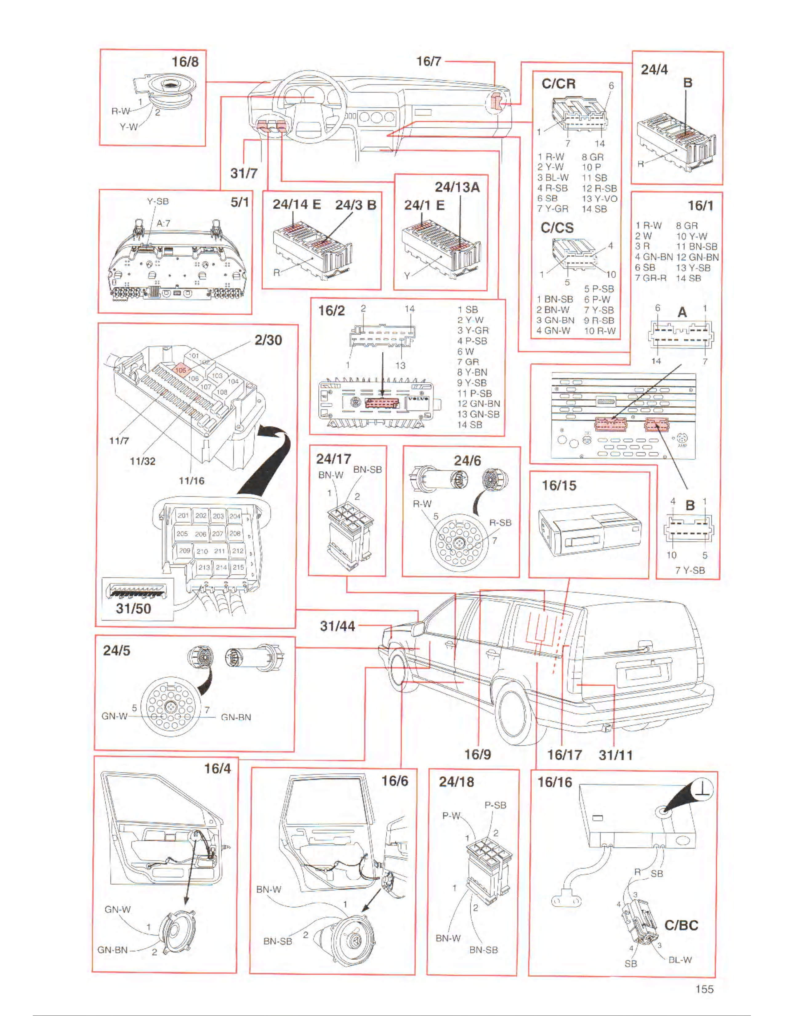

So I went and dug up a schematic. It's a 1996 service manual that I downloaded some time ago. The relevant pages are attached below.
Next I disconnected the C/CR connector behind the radio; still 0 ohms. Then unplugged connector 24/13A from under the dashboard. Now I'm getting somewhere--the short from the fuse box terminal to ground disappears and becomes an open circuit. Measuring from the unplugged connector pin #1 to ground is 0 ohms.
So the short circuit is in the cable harness, on one of the two black and red wires connecting 23/13A pin #1 and C/CR pins #4 and #12. The schematic indicates that there's nothing else connected to these wires between the two connectors.

  • Does this schematic look correct? Could there be another device attached to the black and red wires on that harness that's shorting them out?

Radio schematic. The short circuit appears to be on one of the R-SB wires between 24/13A and C/CR

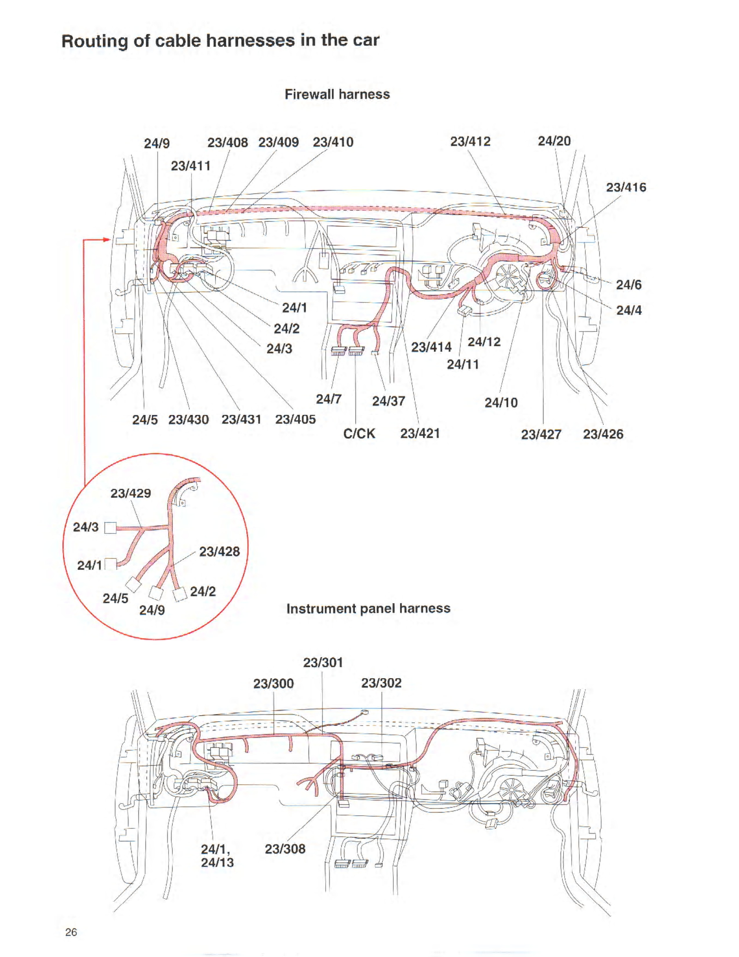

24/13A is underneath the dash, and runs up behind the instrument panel and down to the radio.

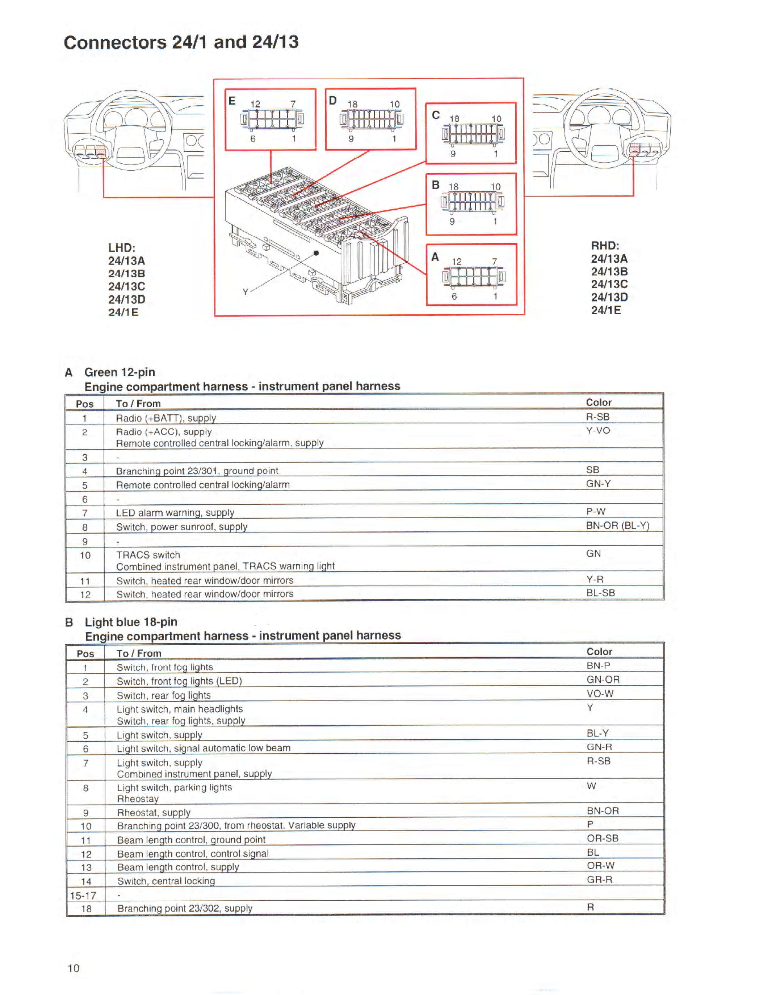

Location of 23/13A underneath the dash. When I unplug this connector, the fuse stops blowing.
Other connectors in the radio circuit.

The radio and amp are completely disconnected. Connectors 24/13A and C/CR are unplugged--see the first diagram. The short to ground is in one of the two wires that runs between them. These are the ones marked R-SB in the schematic.
