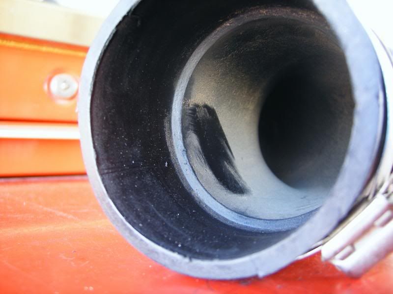

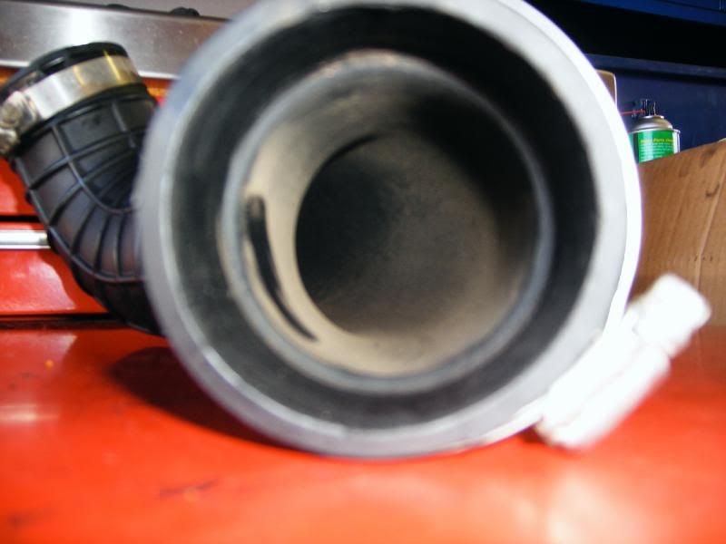

http://www.turbo-mopar.com/forums/showt ... highlight=
I clean it once a year and spray a little K&N oil on it every oil change. It's due for a cleaning but WTF. I've gone back to a paper Wix filter. It's really dusty here in Arizona. I don't think the K&N is up to keeping out the very fine particulates in the air here.
