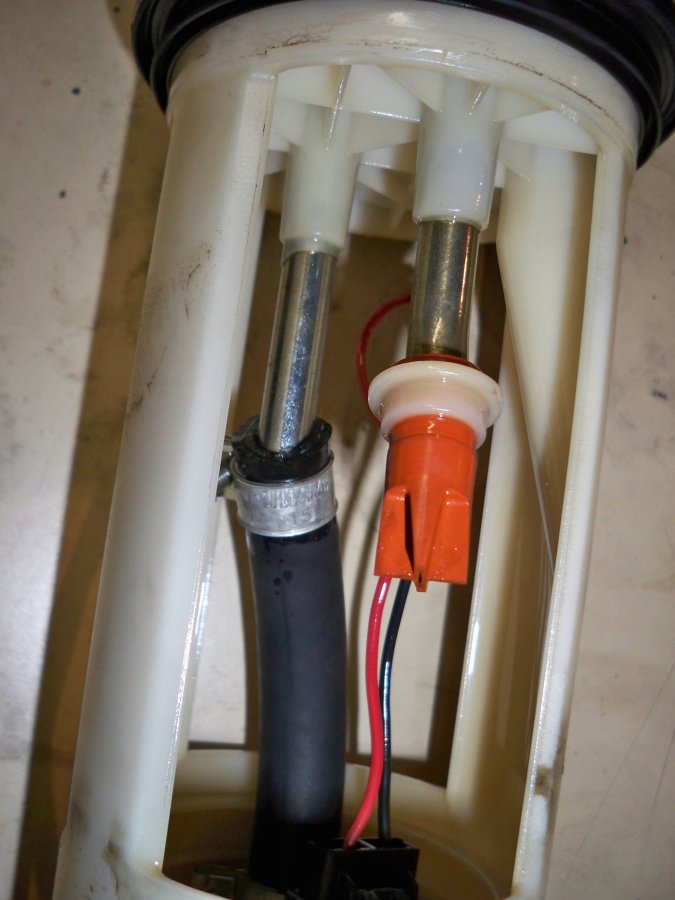

I was having issues with my '96 GLT, where it would occasionally act like it wasn't getting fuel.
The last straw was when I would try and take off from a stop one day (a manual) and it would just stumble and die, or almost die. It would idle all day, however.
I checked fuel pressure and found some irregularities, and opted to dig into the pump. I took the old one out and found this---
Someone had been in there previously and improperly installed the pump as well as used the wrong fuel hose. (non-submersible). Car was fine after an R&R of the pump with new hose.
