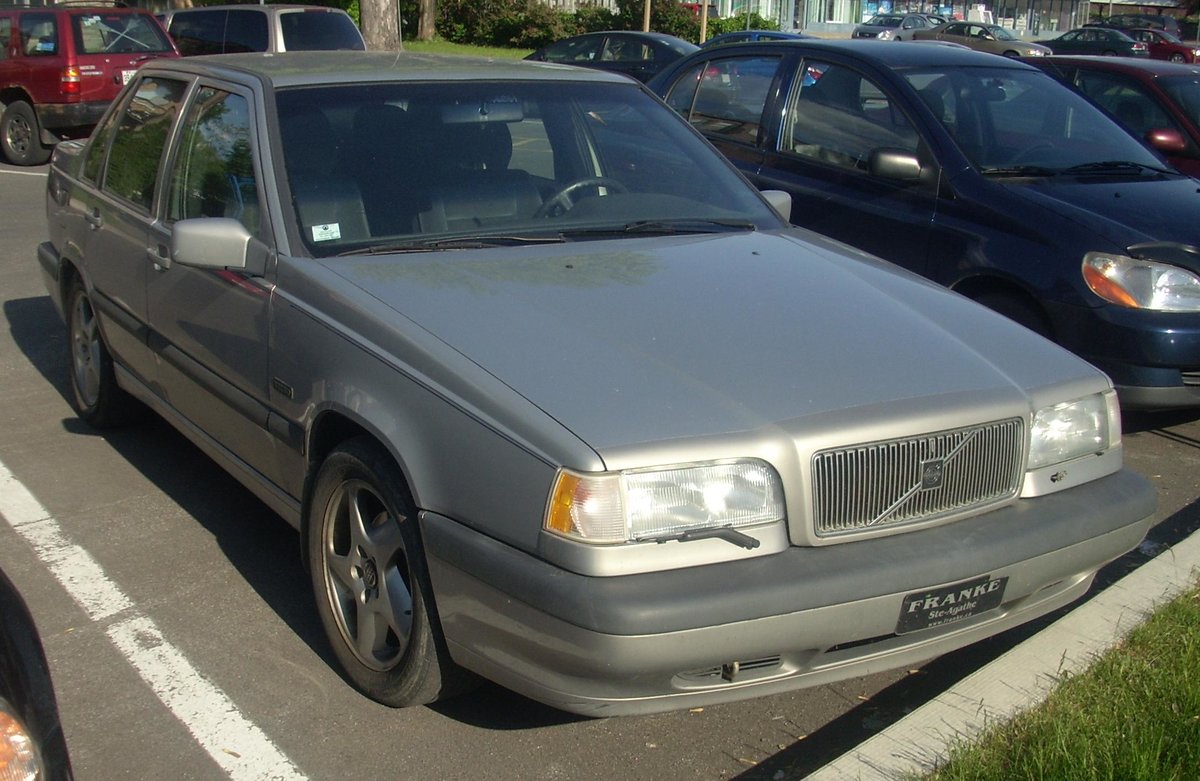

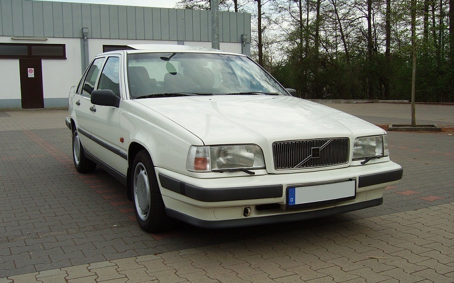

Two obvious changes: the headlights were a 1993 part only. They were taller in '93 and gave the front a more square look.
The wheel covers ("hubcaps") were also a 1993-only part.

1994 Volvo 850 Turbo
1993 Volvo 850 - notice the headlights
