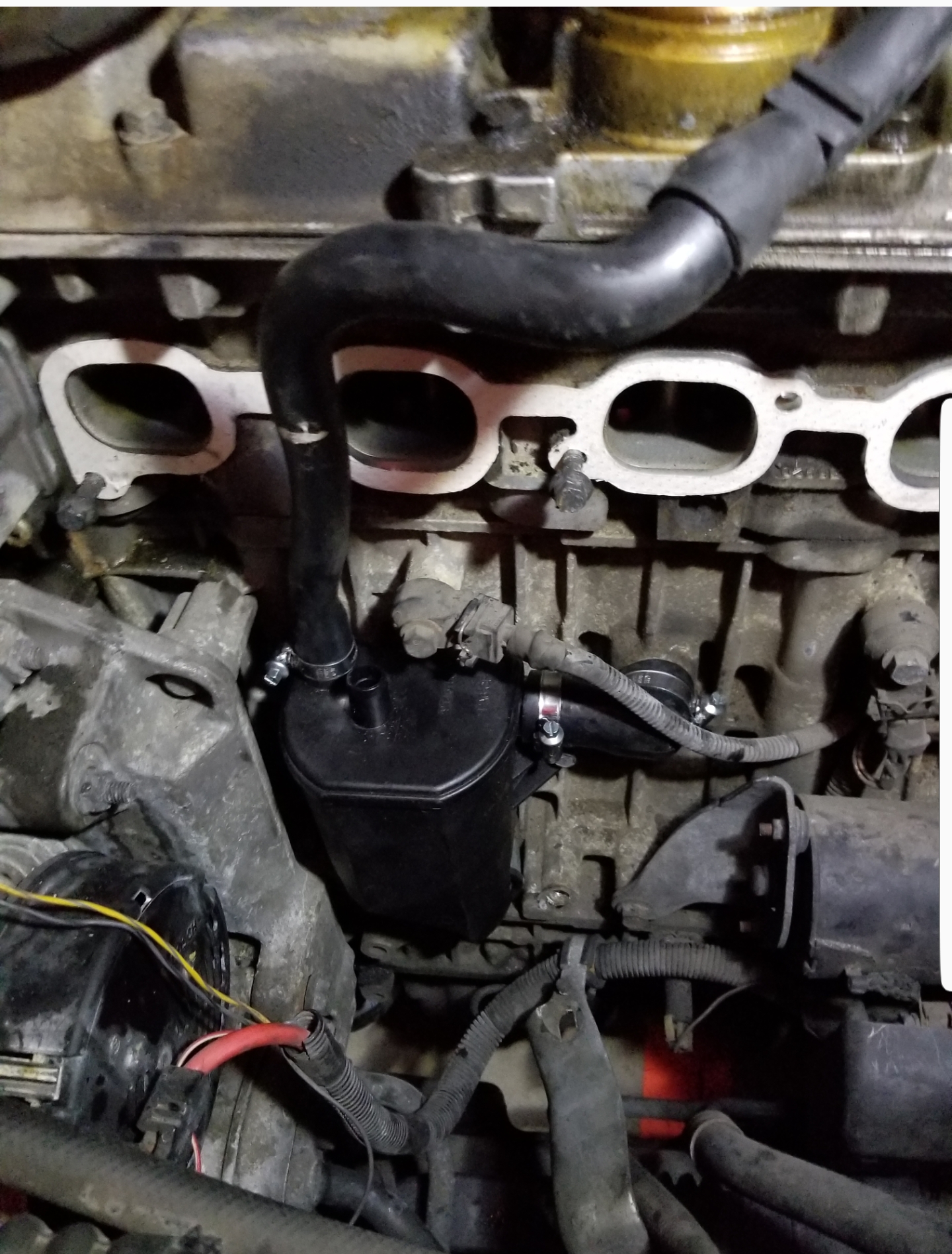

Most recently I did my PCV job, and during which I cleaned the MAF, fuel injectors, reran the vacuum lines with fresh hose, and replaced all the fuel injector seals. That PCV job is aweful for someone like me who has big hamfists. So I recruited my wife to help! Hahaha.

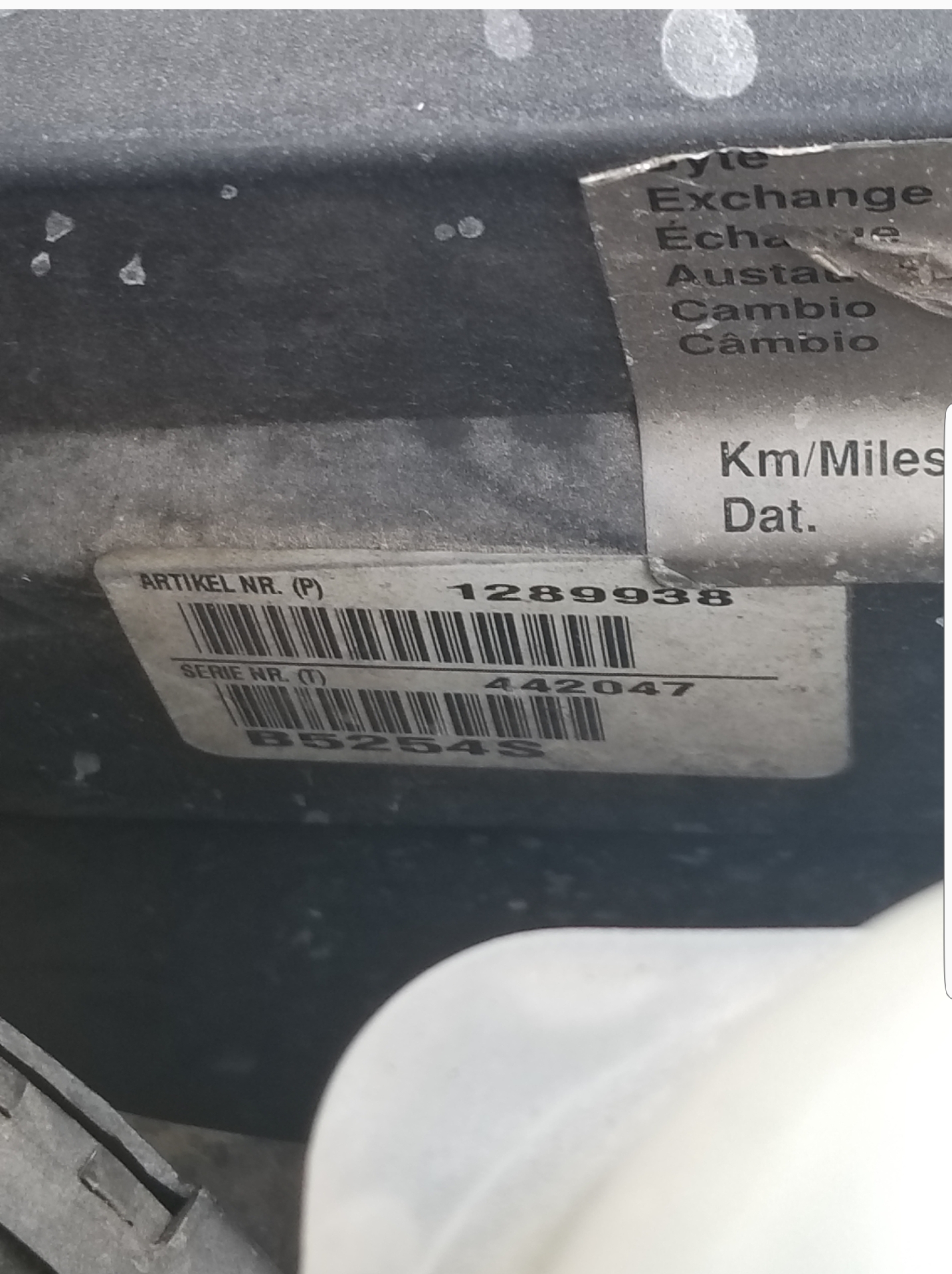

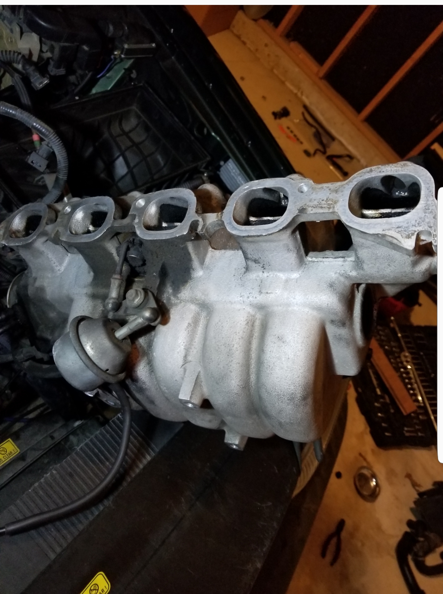

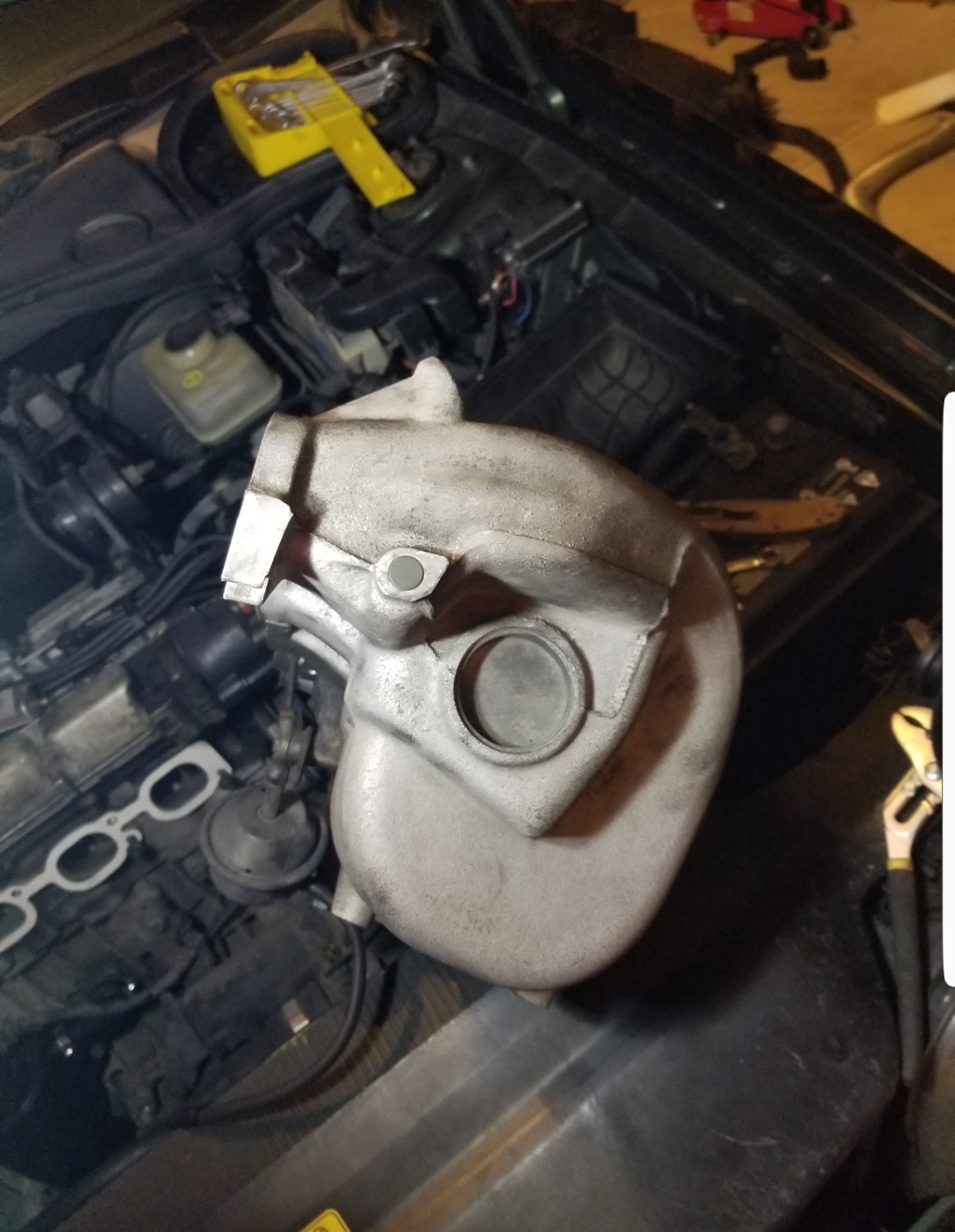

During that job I uncovered two new issues: the air intake thermostat is stuck on hot air, and that the car is equipped with VVIS. Yes, an American spec 1995 is equipped with VVIS. It is definitely stock. I have pics to prove it too. Hahaha.
So thermostat is now wedged into cold mode. And now I'm going to make sure that the VVIS system is actually functional.

Ill trust you, but need to verify a 1995 with VVIS - of course, you might want to check engine number to see if someone has put a 93-94 engine into your 95

Engine s/n 442047
I honestly couldn't believe it. But low and behold there it is.
My wagon was actually a 5-speed too. Don't much care for autos.
I invited any wisdom you gurus of gear can shead on my marvelous mystery engine haha. :-)

I'm pretty sure my -95 GLT (GLT was never anything but the 170 hk NA in Sweden) had it as well. It has the little pressure thingie and the linkage at least.
They did change the engine several times over the years without changing the name of it. The -92s over here had different cams and a different exhaust as well with a sportier sound and power delivery. It wasn't very popular with Swedish buyers of old more beige and dull Volvos though so they slowly made it less fun each year.
