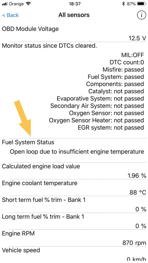

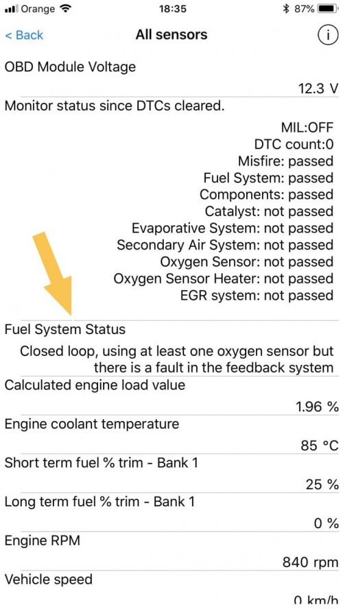

ok, today we switch MAF sensor from my friends the same volvo, and nothing, the same problem.
But today I saw stranger thing on computer.
when the engine was a little colder (arround 70-80 degresese C) it was that:
and when it was a liitle warmer:
maybe is that a water temperature sensor? I know that comp display correct temperature, but who knows....

Post by misha » Mon Apr 09, 2018 2:04 pm
Is that android app?
It could be that it is throwing wrong data.
What engine management your car have...Motronic 4.4 should be the only one in '97.
If so....you have no egr...you have sas system.

no, iphone's "car scanner"
misha
Posts: 4142
Joined: Sun Dec 07, 2008 4:09 pm
Year and Model: '97 850 2.5 20v
Location: Serbia
Has thanked: 49 times
Been thanked: 112 times
Serbia
misha
Re: 855 2.5 20V permanent open loop..
Post by misha » Mon Apr 09, 2018 2:10 pm
It can't be trusted.
VOL FCR should be used or a good code scanner which displays live data.
