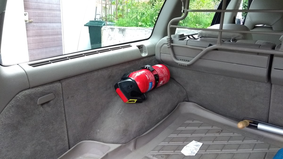

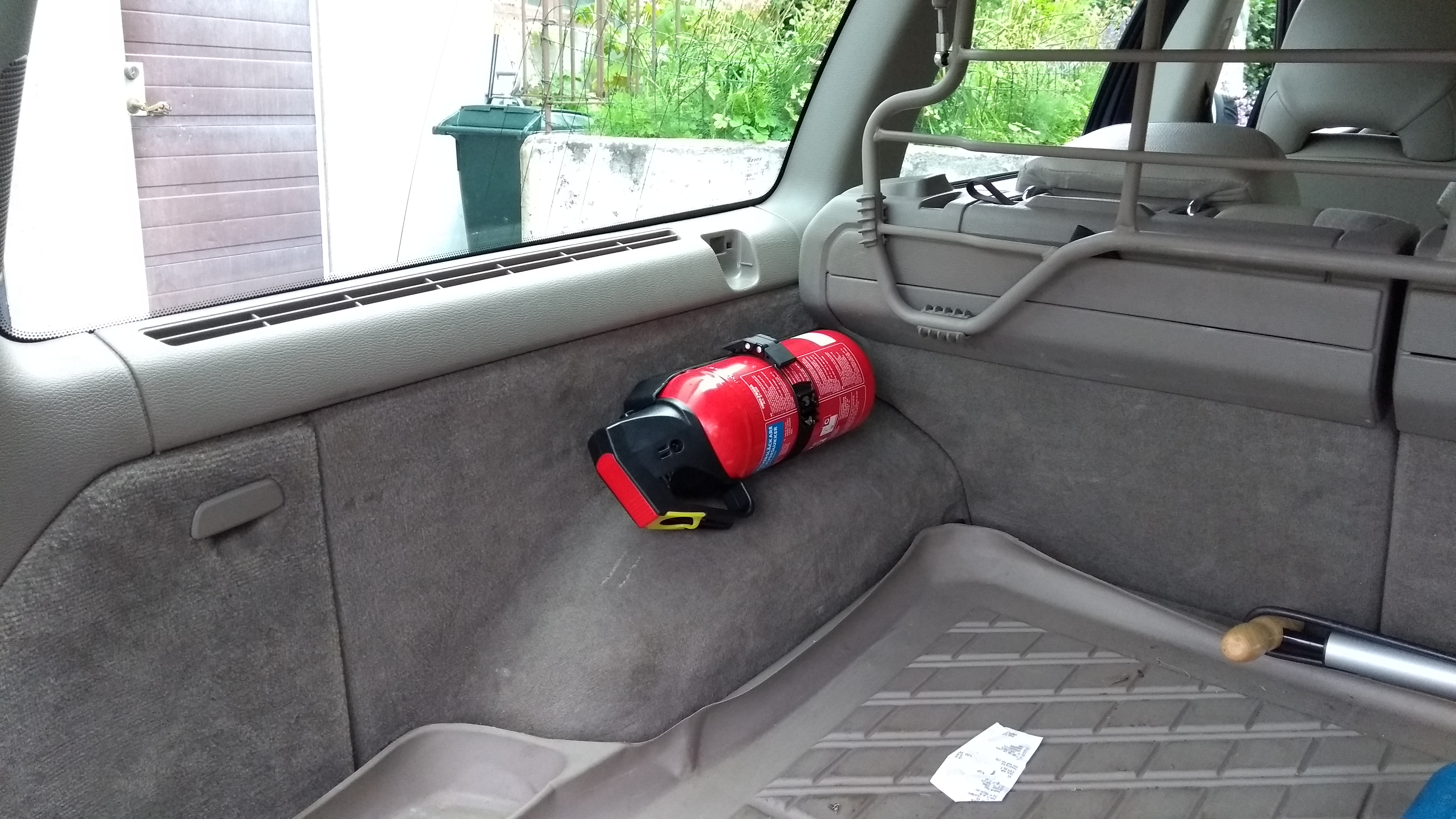

A good addition to any car below. Though it won't always help if the fire is well hidden.
There used to be a Volvo mounting bracket to put it beneath the drivers seat, always within reach. Something to look for perhaps.

Yeah - that isn't going to help too much on a fuel or electrical fire. There is a lot of fuel value in plastic in cars now and once they start, they are pretty much totaled.
Off topic - you are required to carry on on boats, where they are even more useless. My 26 foot sailboat is about 1000 gallons of gasoline in the form of GRP or fiberglass. If it starts on fire, you start swimming, fast.

Electrical fires should be OK with a powder extinguisher. Fuel I guess depends on a lot of factors since it'll just keep coming.. But if a fire can be reduced to just a leak it's a huge improvement. Increases the chances of saving the rest of the car for parts at least ;-)
(and any cargo inside).

Rattnalle wrote: 23 Apr 2018, 08:33 A good addition to any car below. Though it won't always help if the fire is well hidden.
I believe in having one of these, not a small 1lb, but a larger like in the picture. One day it may help another driver as well. These come in different types, if I remember the ABC type is the one to get for cars. But again, the fire started under the rear bench, not easy to access
