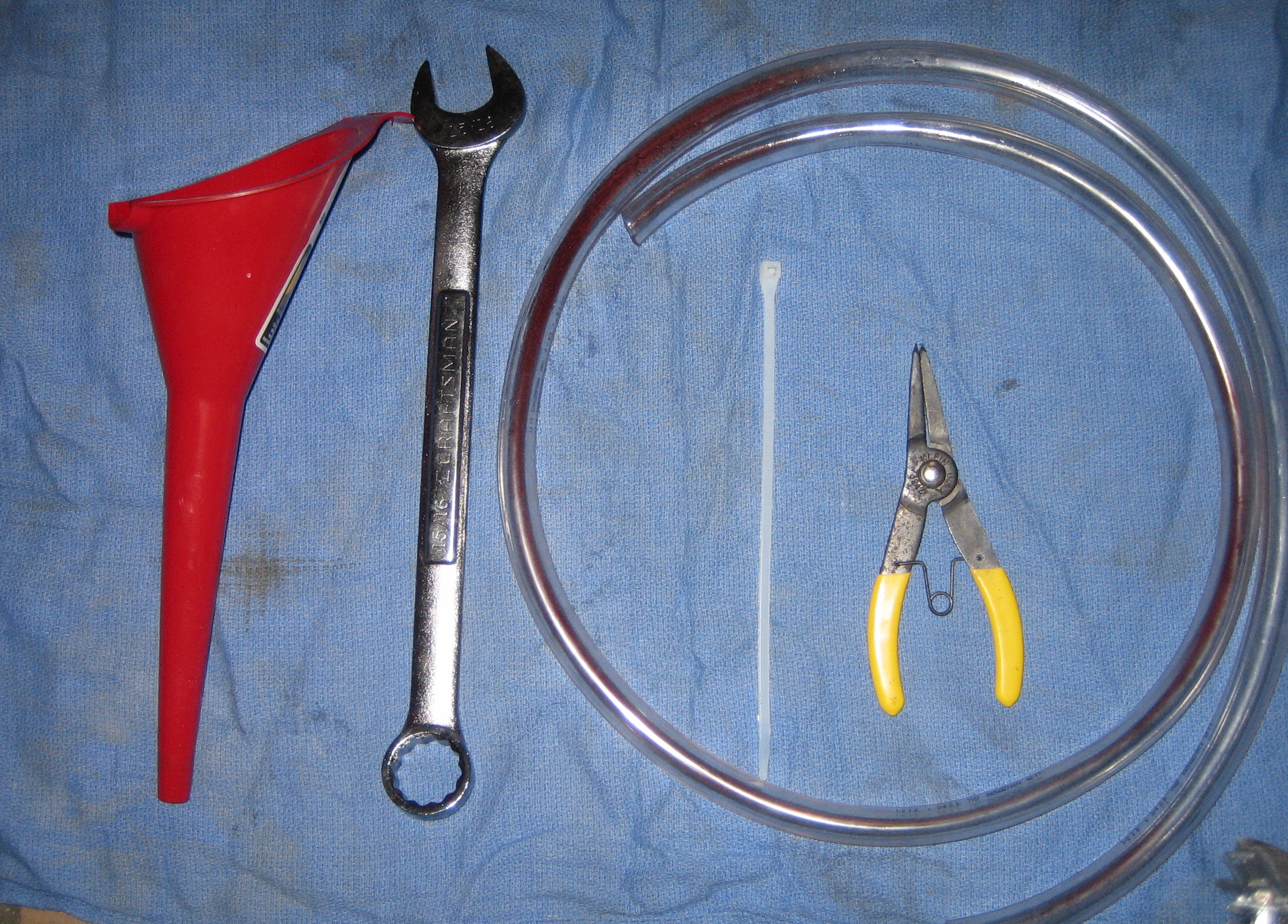

1.) The tools required are few: Along neck funnel to access and reach the dipstick and transmission filler tube, a 15/16 or 24mm box/open end (not a 1/2" drive ratchet since it will not fit between the drain plug and the rear brake fluid lines), 5-6 feet of 1/2" I.D. clear tubing (5/8"ID will be too wide), snap-ring pliers, and a 6" electric zip or cable tie for added security after replacing the transmission line clip when you are finished. In addition, a new crush washer for the ATF drain plug (same size as the oil drain plug) and a drain pan will be needed.
tools: Long-neck funnel, 24mm or 15/16" box/open end, 5-6' 1/2" ID clear plastic tubing, snap-ring pliers:

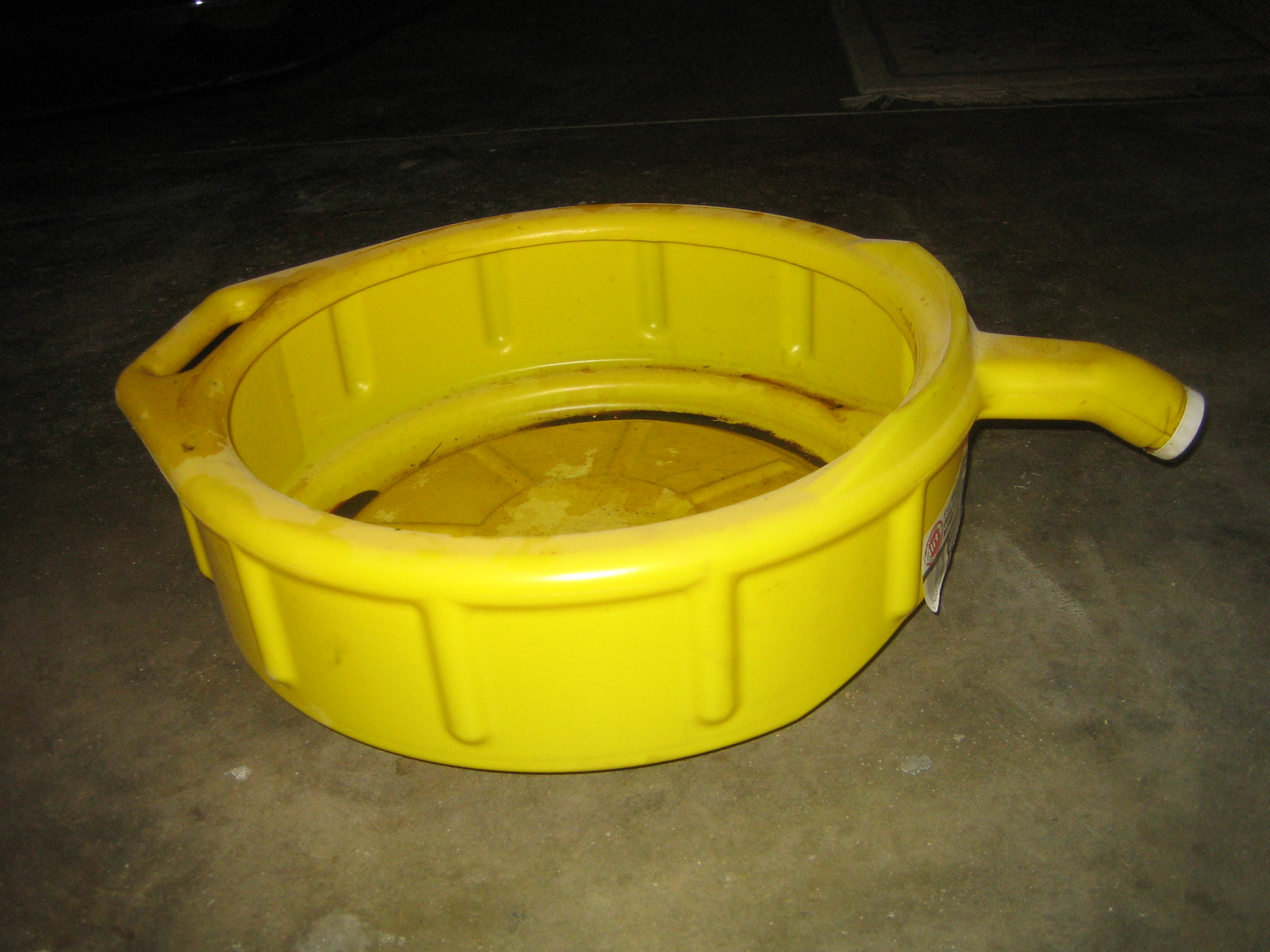

drain pan

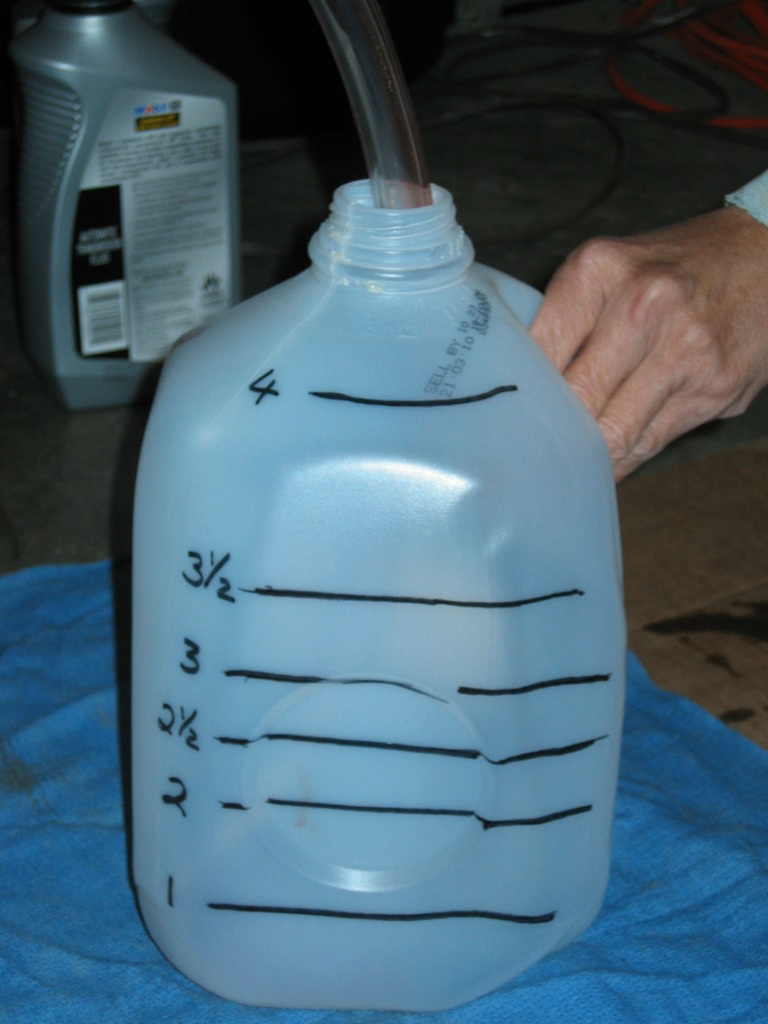

2.) Prepare 3 gallon milk jugs marked in 1/2 quart intervals. When flushing the delineations will simplify the process by allowing you to see exactly when to turn off the engine to stop the flow of transmission fluid. If you have an assistant watching the containers and telling when to turn off the engine it will make the job much easier. If not that is why there are 6' of clear plastic tubing. You will then be able to place the milk jug by the driver-side door and can watch when you are at 2 quart intervals. I used Mobil 1 synthetic ATF. 10 quarts will make a good flush, though you could use 9 and be satisfied.

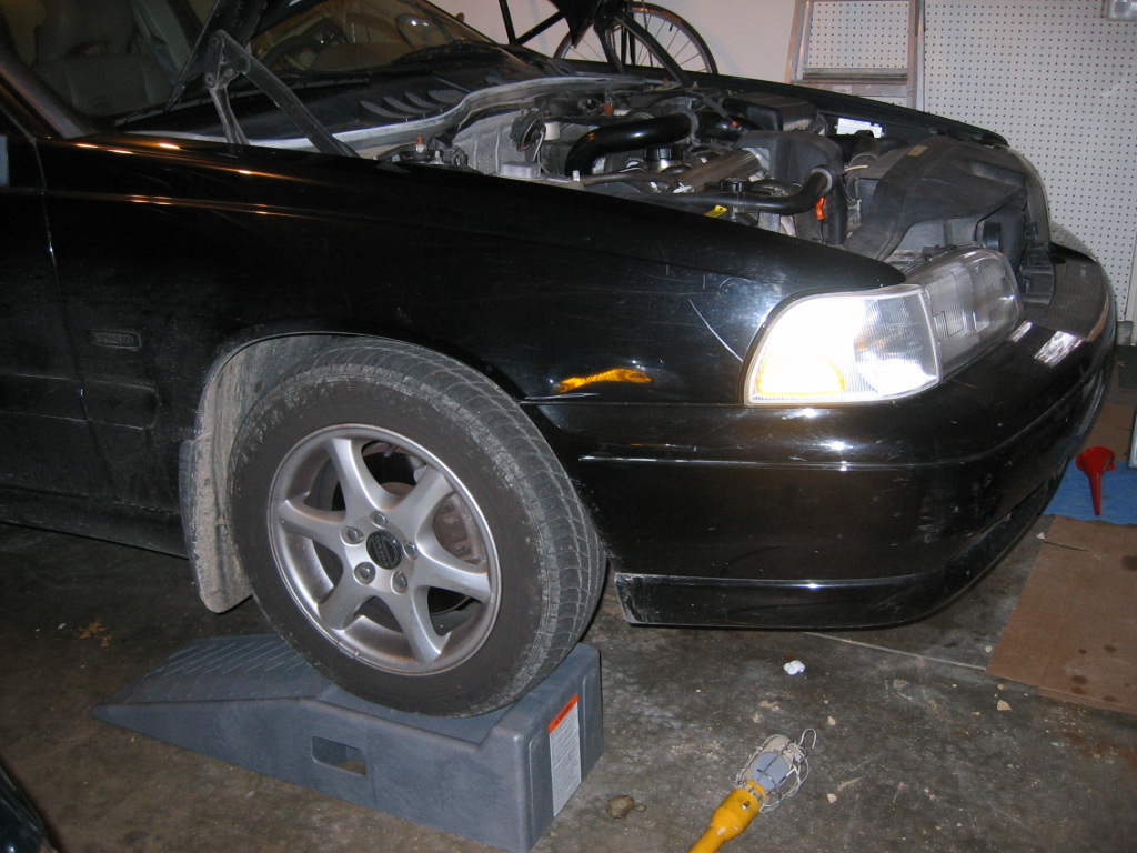

3.) Place the care on ramps and remember to place the parking brake and blocks behind the rear wheels. The engine should be warm and you should have run through all the gears so the dirt and particles in the ATF is now in suspension. A light for working under the car will also be necessary.

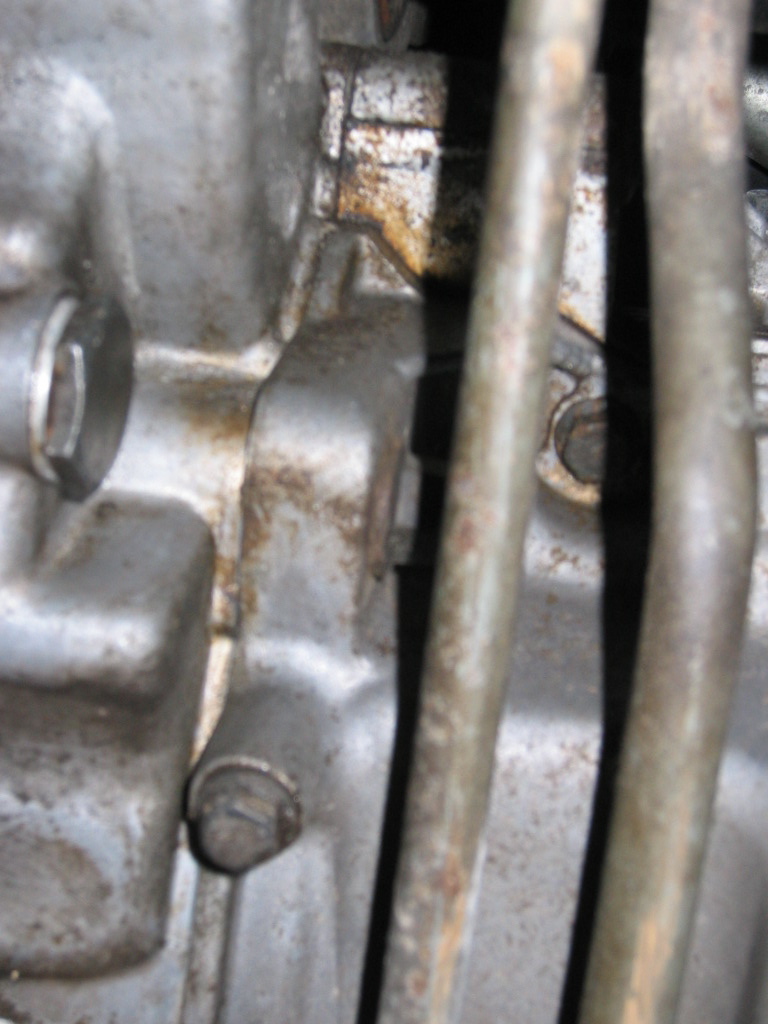

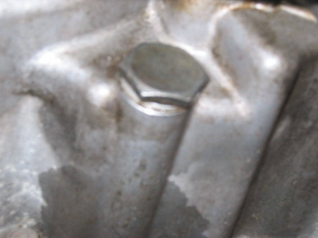

4.) Next you will need to crawl under the car and locate the ATF drain plug. It is located on the driver's-side behind the front axle. The 2 rear wheel brake-fluid lines run in front and along side. Using the 15/16" or 24mm box wrench undo the drain plug and drain the transmission fluid into the drain pan.
After the ATF fluid is finished draining replace the drain plug with a new crush washer. Since the drain plug is magnetic, you can examine it for metal particles. prior to replacing it. In any case, it should be cleaned off from sludge and/or metal partcles. Now pour the ATF fluid into one of the pre-marked plastic gallon milk jugs and measure the total amount which was drained. This should between 3-4 quarts. Mine drained 3.25 quarts
ATF drain plug on the driver's-side. Do not confuse with the oil pan drain plug.
Drain plug looking up with the rear wheel brake-fluid lines running past. It is these 2 lines which prevent accessing the drain plug with a 1/2 inch ratchet. The space is too tight.

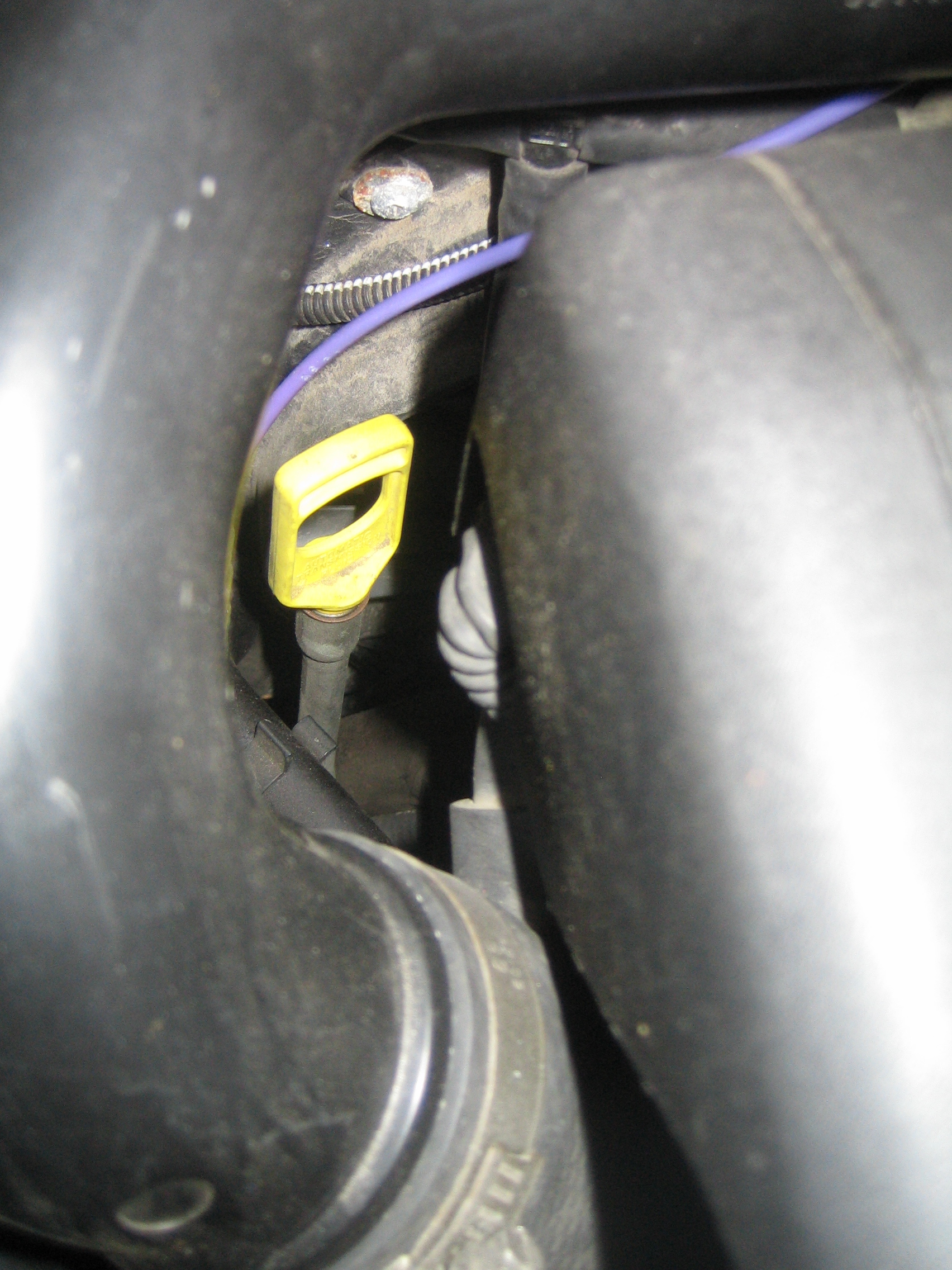

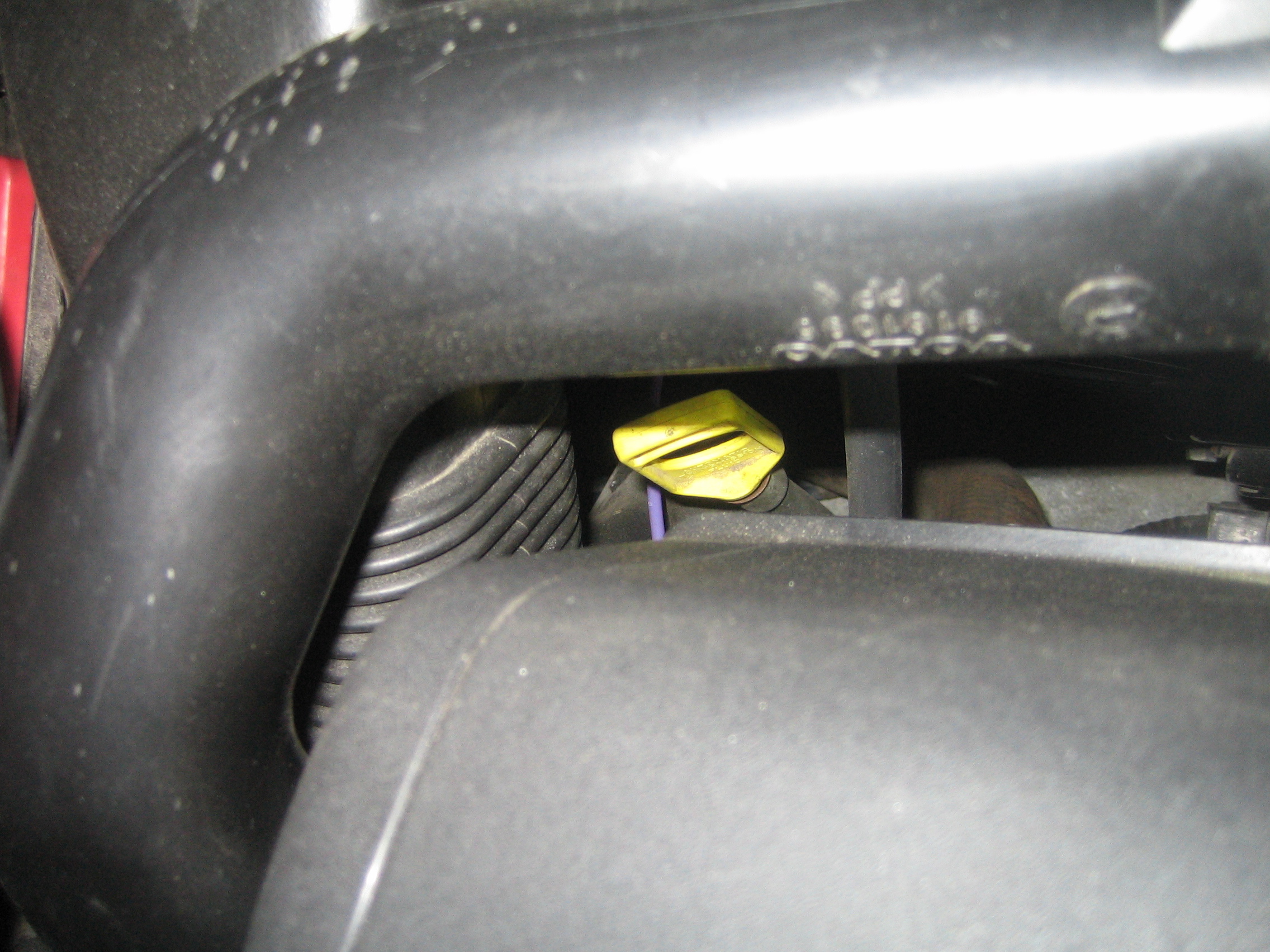

5.) Next locate the transmission dipstick/filler-tube. It is located up front on the driver's-side behind the radiator and between the air intake tube and the covering on the throttle body. The car battery is on the outside toward the wheel. Kinda hidden from view. The transmission dipstick has a yellow handle.
ATF dipstick/ filler-tube. View looking down and toward front of car.
View of ATF dipstick/filler-tube looking from center toward battery side.

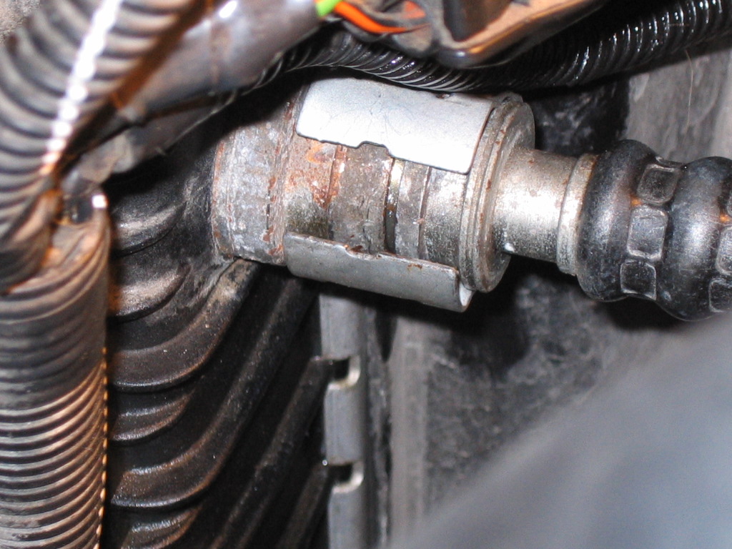

6.) Locate the top automatic transmission fluid line coming from the transmission and going to the radiator. This is located on the driver's side upper outer side of the radiator right next to the battery. In order to remove the line, it is first necessary to pry open the clip holding the line in place. For this you will need the snap-ring pliers. The tips should be placed in the two grooves seen in the picture below. Open the clip by closing the snap-ring pliers, thus spreading open the clip. Remove the clip. Next disconnect the ATF line from the radiator by pulling it straight away.
Transmission fluid line connector driver-side top of radiator. The ATF fluid goes from the transmission to the radiator through this line.
Showing how the snap-ring pliers fit into the transmission connector retaining clip for removal.

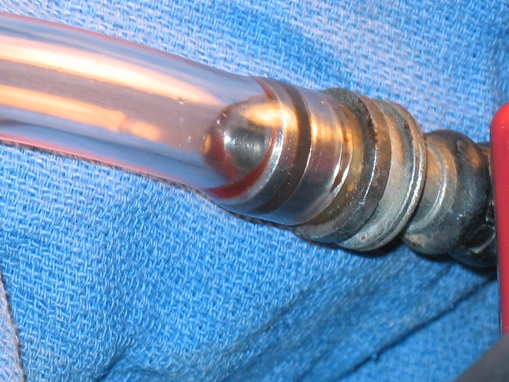

7.) At this point the 1/2" ID clear plastic tubing will need to connected to the transmission fluid line coming from the transmission. The tubing will fit snugly so there is no need for electric zip or cable ties. Do NOT connect the tubing to the nipple on the radiator. Remember, the fluid is coming from the transmission via the line to the radiator, where it will be cooled. You will be draining the ATF from this line. If you connect to the nipple on the radiator, you will have a lot of fluid running out of the line on to the floor and a big mess.
1/2" ID 5-6' clear plastic line connected to transmission fluid line coming from the transmission. It should be clear
so you will be able to see the fluid running through the line.

9. Next run the 1/2" ID clear plastic tube, which is connected to the transmission line, into another pre-marked plastic gallon jug. If you are lucky enough to have an assistant, as I did, to hold the jug and watch the ATF, great, otherwise place the jug near the driver-side door so you can watch it being filled when the engine and transmission are running. Place the car in park. Turn on the car and while the engine is running and with your foot on the brake run through the gears; park, drive, 1st, 2nd, 3rd. Old dirty ATF will start to flow through the line into the plastic milk jug.
Run the engine until approximately 2 quarts have been pumped out or when air bubbles are visible in the hose, then turn off the engine. Now add exactly the same amount of clean new ATF to the transmission via filler tube that was pumped out from the transmission line. Again remember, do not over-fill.

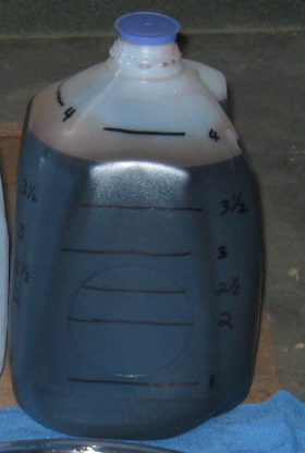

Repeat this procedure for at least a total of 4 cycles (8 quarts) or until the transmission fluid being pumped out of the line becomes a clean red color, indicating that the majority of the fluid in the system has been flushed with new clean fluid (it may take up to 5 cycles). This will take anywhere from 8-10 quarts of ATF to added for replacement from the old ATF pumped from the line and another 3-4 quarts of new ATF replaced from that originally drained from the transmission pan. So, actually a total of about 12-14 quarts of new ATF will have been used.

Plastic milk jug with old dirty-brown transmission fluid.

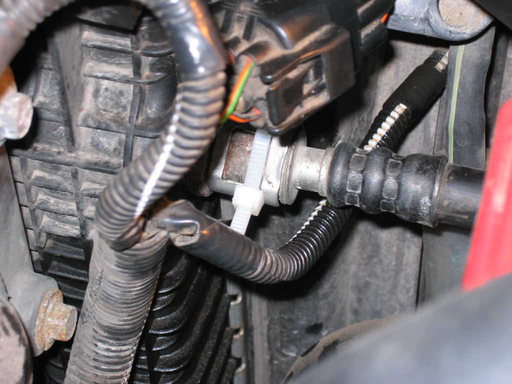

10.) Disconnect the clear plastic tube from the transmission line and reconnect the line to the radiator nipple. Replace the connector clip and for peace of mind, put an electric zip or cable tie around the clip, ensuring it will not pop off. Drive the car off the ramps and on to level ground to check the transmission fluid level according to the owner's manual. If it everything was done properly, replacing exactly the same amount old fluid with new, the ATF fluid level should be correct. If, per chance, it is too low you can add in small increments. However, if there is too much ATF fluid and it is over the max line the excess will need to be removed. This will require disconnecting the line again and running the engine until about 1/2 quart is removed and again rechecking, etc., etc. That is why it is important to be careful in your measurements. Better a little less, than too much.
Congratulations on a job well done.
Reconnected transmission line with electric zip tie around connector clip.
