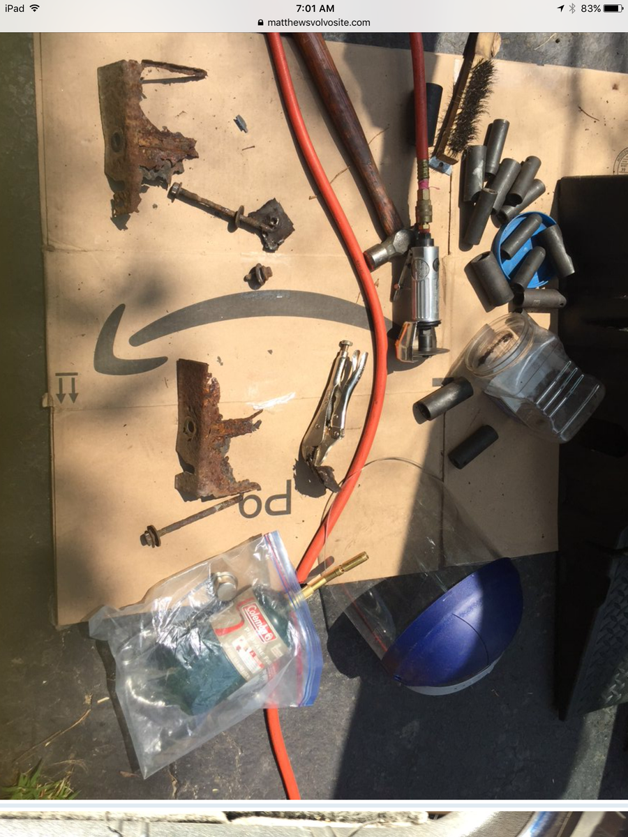

Replace that vertical bolt and take a good look at the brackets and hardware. It's cheap and you can slather noseize on them. I've got used ones for sale cheap....see picture. That's how bad this crap gets back there.
