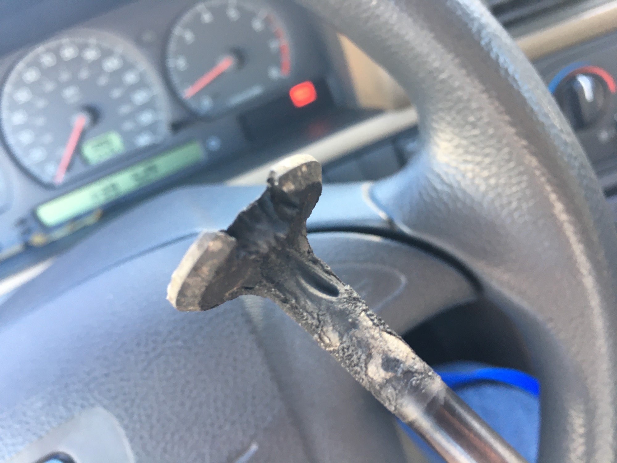

With sadness I report the demise of my T5.
On a trip back from central NY, 3 miles from home, #3 valve was ingested and I limped home, thanking her for her decades of service
Elizabeth led me to MVS back in 2013, when I was contemplating selling her, but decided she was a really nice car worthy of refurbishment. she gave me another 7 years and 120k miles of service at ridiculously low cost and equally ridiculously high smile factor, waggling her gearbox from DC to Chicago to\ Boston and all points in between. Many a Bimmer was dispatched in the rear view as the HPT spooled up over 3000 rpm.
Disposition? She needs a steering rack and the valve dealt with, but is otherwise a daily driver. I have an offer from a local speed guy that I won’t seriously contemplate due to his reputation of his cars lasting 6 months. I can’t possibly get to this for 4 months and I don’t want the car to sit that long if at all possible.
I will put a classified shortly, maintenance history, of course, is detailed in the link below - under “Elizabeth” of course.
The tears of sorrow already are being quenched with the many happy memories.
:D
Added photo of exhaust #3 valve

Put a used head in it and keep it!
Here in Serbia....head rebuilt is around 100-120€ in a professional mashine shop,headgasket,seals...another 80€,plus a good trusted mechanic around 100€...around under 300€ in total costs with 2 years warranty.
If you have a skill and tools to replace the head yourself it would be under 200€ for a professionally rebuilt head.
Are you sure it's not a coil pack(since it's '99) or spark plug failure on that cylinder?

I can guarantee she won’t be going to the scrap yard or getting parted out.
Here is something I don’t quite get on valve drops. You lose an exhaust valve, presumably. You pull the head, replace the valve, cut seats, new stem seals. Don’t you expect another valve to drop? Or, is refreshing the seats and stems enough to reduce that probability?

That's how I figured it. Valve burns in an instant right, due to deposits built up over time. No buildup no hotspot, unless by rare chance it starts to build up in same location again.
