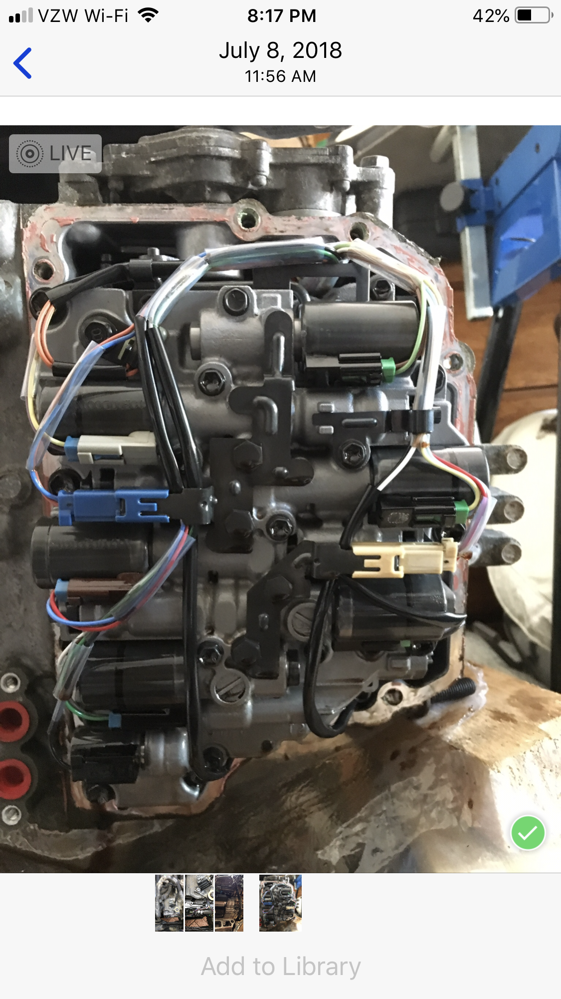

I just replaced a Valve Body on an S80 V8. Shifted perfect right after installation. didn`t bother with resetting adaptation. The fluid had been changed 1000 miles prior so the fluid counter was reset then ( close enough ).Don`t get a rebuilt unit for cheap, or get a rebuild kit. Part of the problem is the pistons on the solenoids wear out the bores on the Valve Body casting. The only one who bores and puts in oversize pistons to fit Is SONNAX. If you get a cheaply rebuilt or rebuild kit the pistons will still be loose in the bores and can cause issues. The SONNAX one is virtually impossible to buy unless you are a transmission shop. I wouldn`t try rebuilding one at home. one little spring forgotten or misplaced and your screwed. They are really strange to take apart, you actually need a strong magnet to pull the pins out that hold the solenoids in. So the only way to go is an new OEM Valve Body from Volvo. $1250 to $1500 is the price range
This pic is invaluable for routing of wiring.
