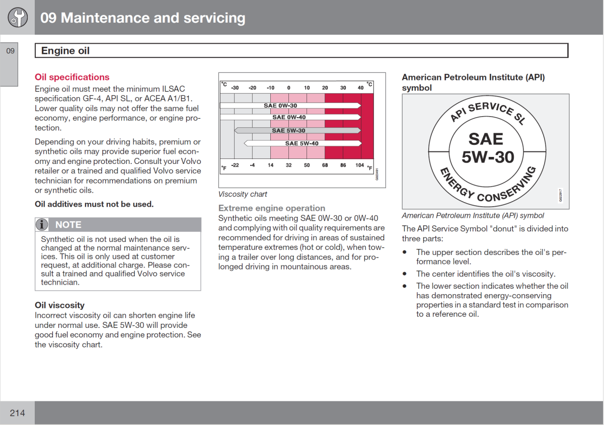

EgoziAlon wrote: 09 Apr 2024, 16:23 Can you explain me the difference between 0w40 to 15w40?
Below is the 2012 XC90 Manual for download. 0W ~ 15W has to do with the viscosity property at colder temps. The second rating has the do with the higher temp characteristic. Since your engine is burning oil a higher viscosity will help with the blowby from worn rings if that's the cause. The higher your climate ambient the higher the first number. The same with the second number of 40W. Wouldn't go with any 5W or 10W-30 as the motor gets older and looser.
In 2012 Volvo was still working with API SL. The newer API will have slightly different characteristics but a good oil like Rotella T6 in the 5/15W40 in general will be excellent for the engine.

2012 XC90 Owner's Manual
https://volvo.custhelp.com/app/manuals/ ... model/XC90
2012 XC90 Manual Page 214.png (408.18 KiB) Viewed 1417 times
