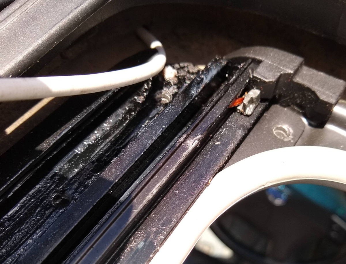

During a bad storm I got in the car to find water dripping from the sun roof. After watt have by a couple of related YouTube videos where people took the car apart to remove the blockage, I decided to try something of my own. I put some bleach in both side drains. Using a compressor set to 40psi and a drinking straw I shot some air in them, then a little more Barack and compressed air.
Finally poured abou 4 gallons on water on drain channel to rinse it out. Water was sitting there when I started. At the end it could handle 3 gallons/minute. Give it a try...

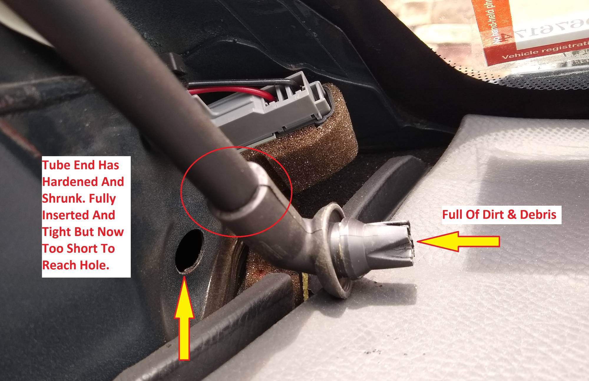

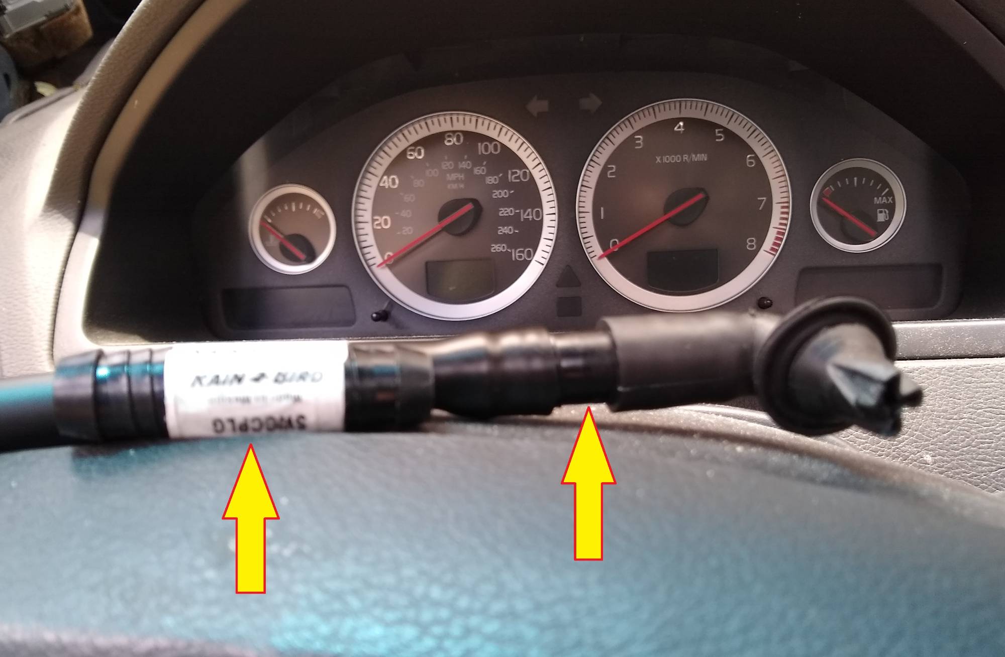

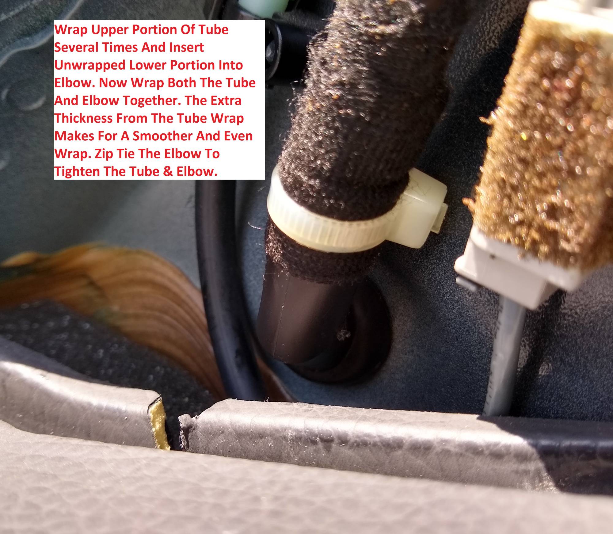

Extremely dirty 2012 XC90, removed front carpets to pressure wash and found the driver's side is wet but not soaked.

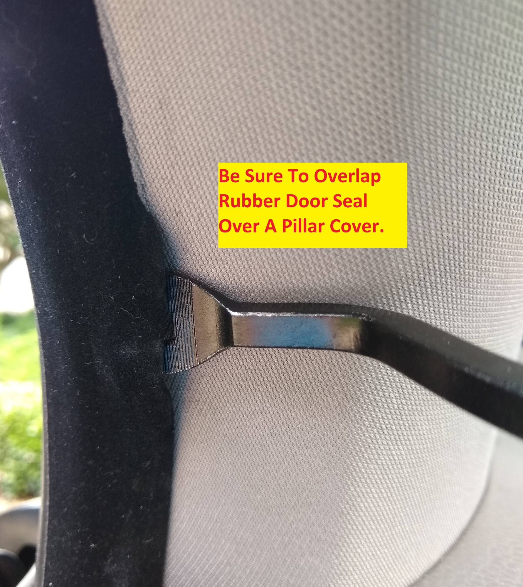

1) Removed the 2 - 8mm bolts in the handle of the A pillar and the pillar cover just snaps off easily with the handle still attached.
2) Found the driver's side tube loose in the elbow and elbow clogged. Water was backing up and coming from the loose connection. The tube's end has hardened and shrunk while the elbow rubber has expanded a little. Removed and cleaned elbow end.
3) Inserted curtain wire besides blowing air to clear the drain hole and tube while detached from the elbow.
4) Cut about 1" of harden end of the drain tube.
5) With the hardened portion removed used a film of silicone grease and inserted 1/2" barbed irrigation connector into both the tube and elbow. This is not ideal however as dirt in time can sit on the edge of the connector whereas if you insert the tube into something water and debris will free flow without a lip or ledge to collect things. Just have to clear with air and water once in awhile but at least the hole size is the same all the way through.

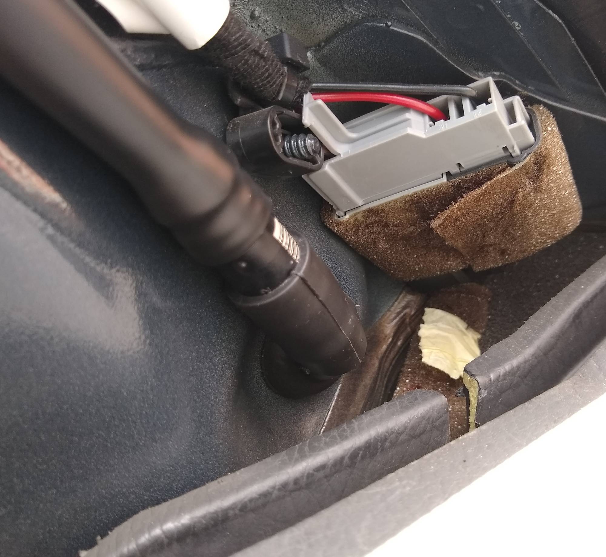

1) The driver's side iwas very clean, tube and elbow not as loose. Decided to just wrap the tube above the insertion line with self stick wire loom tape and then wrap the elbow and tube together with the same.
2) Zip tie at the elbow where the tube and elbow meets. The self sticking tape won't allow tube and elbow to come loose nor will there be water seepage due to the zip tie.
https://www.ebay.com/itm/296504605263?v ... R-z7xZ6IZA

This design using the hard plastic coupling is designed to leak since the sunroof drain tube is on the outside. The drain tube will loosen up over time and it isn't layered properly. Plus, the elbow should be changed since that relies on the rubber to keep tension. They are not expensive.
If you really want to prevent clogging up the drain, trim a little of the flappy end of the elbow. This is a practice done by working mechanics as more and more electronic modules can get water damaged by clogged drains throughout the body.
