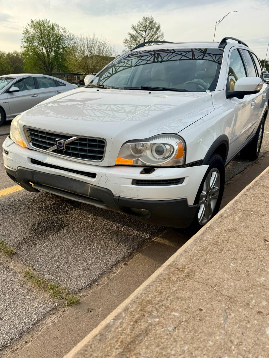

100 miles later mashed the front...
It's a sight you never want to see, this one wasn't too bad.

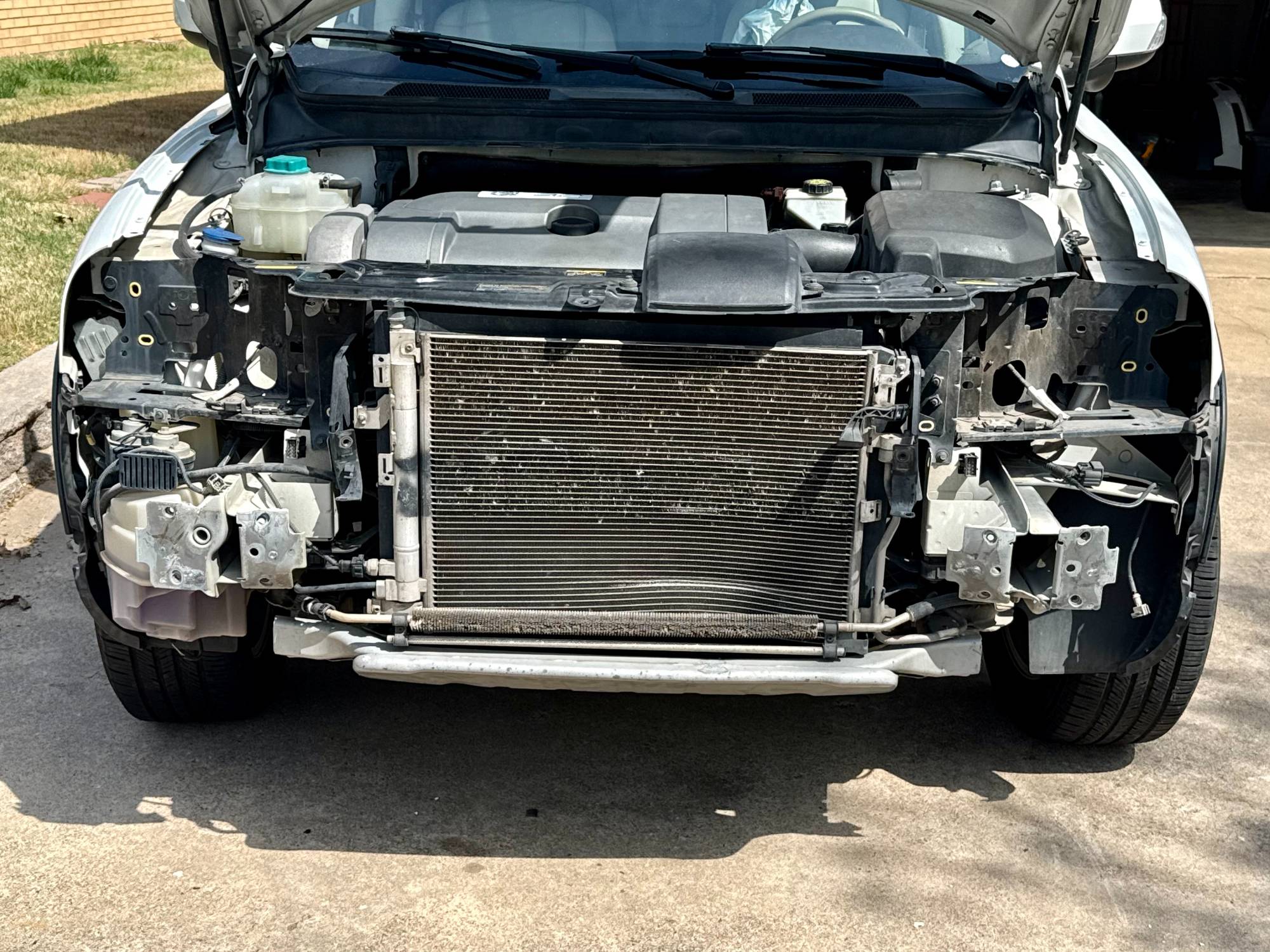

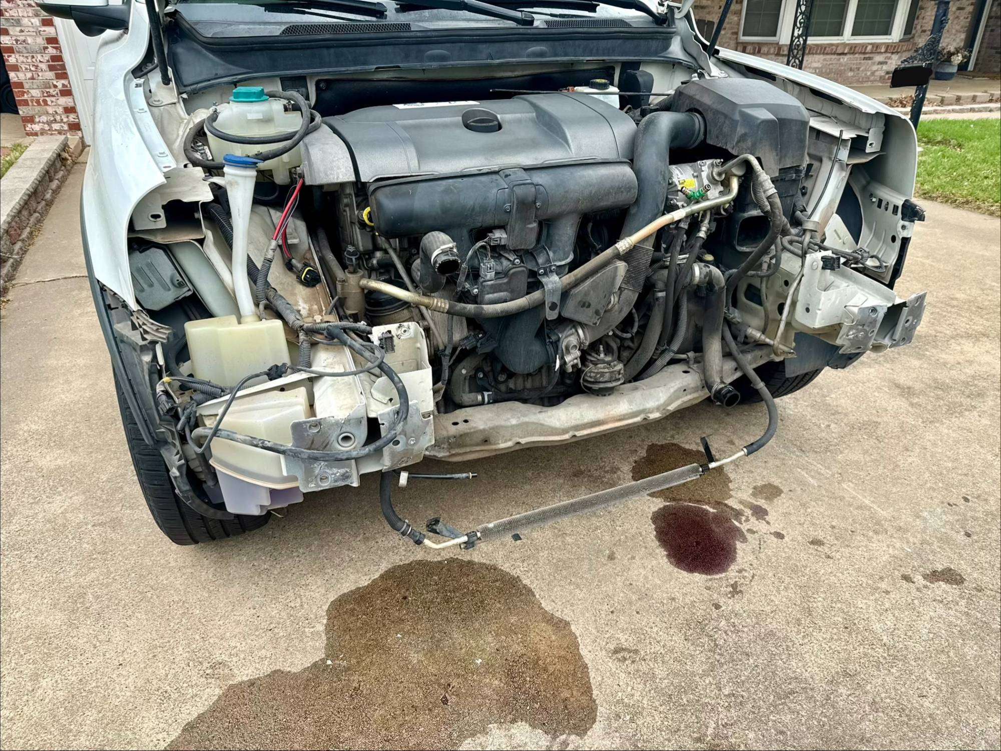

Get her home and pulled apart...

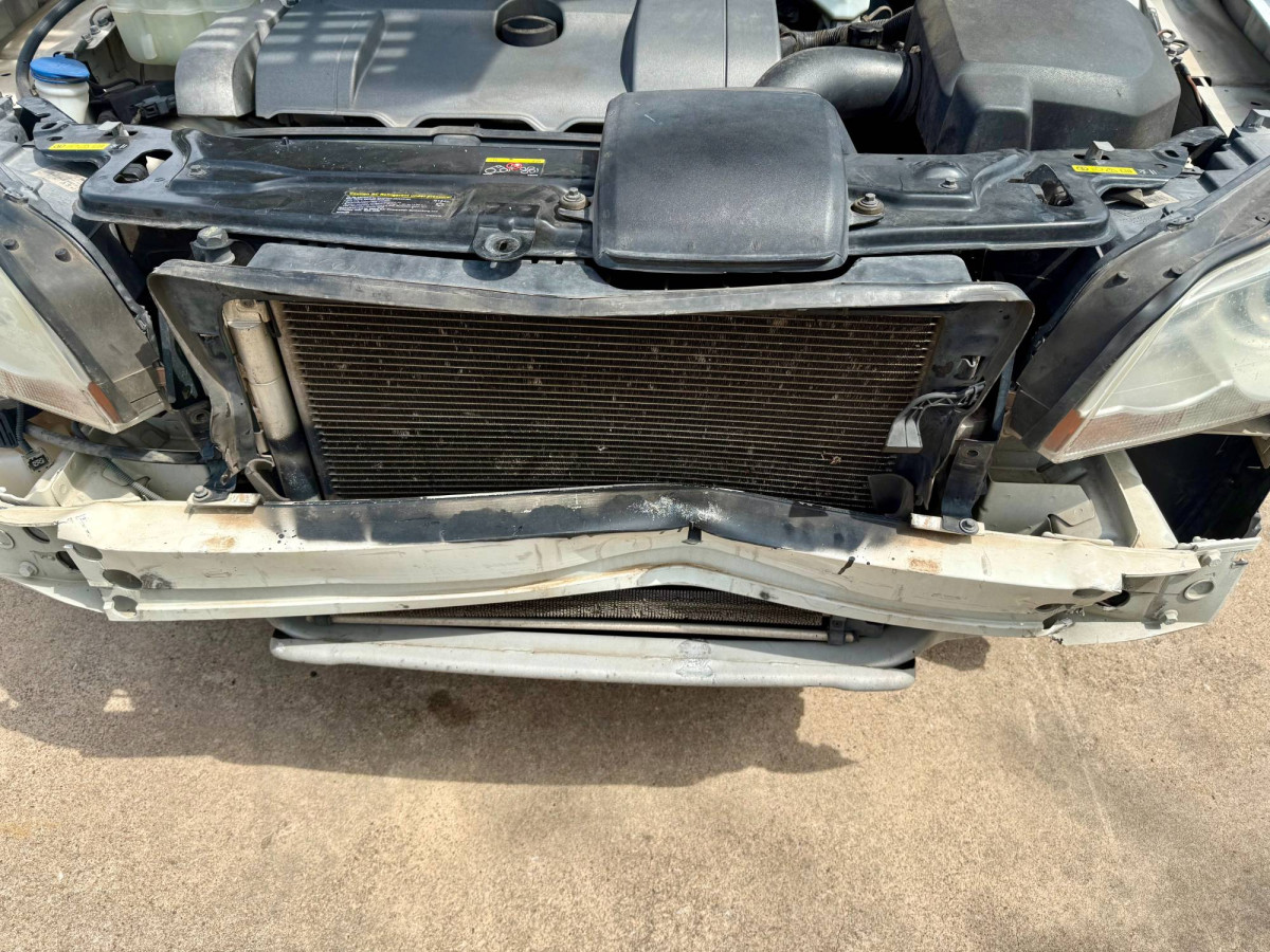

Not horrible, but horrible... radiator and front bumper member are destroyed.

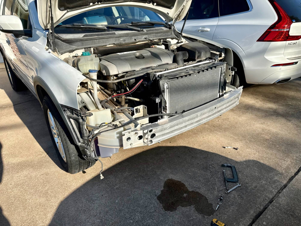

Get it apart further and it seems the A/C condensor was OKAY! Still replacing but it was SEALED!
Having to drive a family beater for a couple weeks as parts come in... only shot I have of her with the hood down. After adjusting and bending and adjusting I got the hood back in A shape, just not great shape.
Pulled the A/C condenser, radiator and a few other tidbits like the thermostat. Had to pull off the big main "bracket" that holds the radiator and head lights, took a few days of picking at it to get it back into a shape... again not great shape..
Took 2 weeks or so to get all the parts in, the thermostat got lost so I just waited to put everything on until I got that and the new hoses....
The bumper was difficult to get on, the two beams of the frame that it attach to were bent inward a bit and needed some "persuasion" to install...

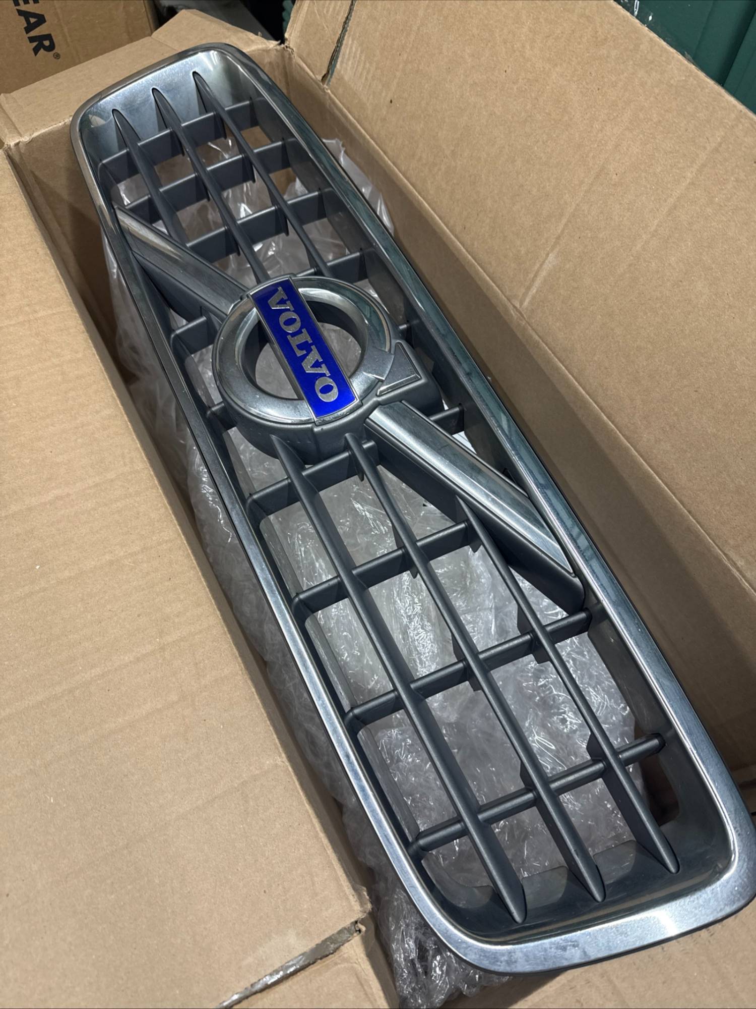

Got all the body pieces installed, replaced the grill as all the clips at the top were sheered off... Thanks ebay!

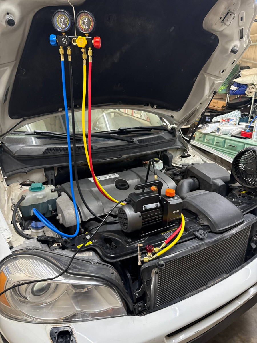

Got a cheap vacuum pump from ebay, some pag oil with UV dye and a bunch of refrigerant. I was a little timid at first but its actually really easy to do. Next step is buying a recovery tank.

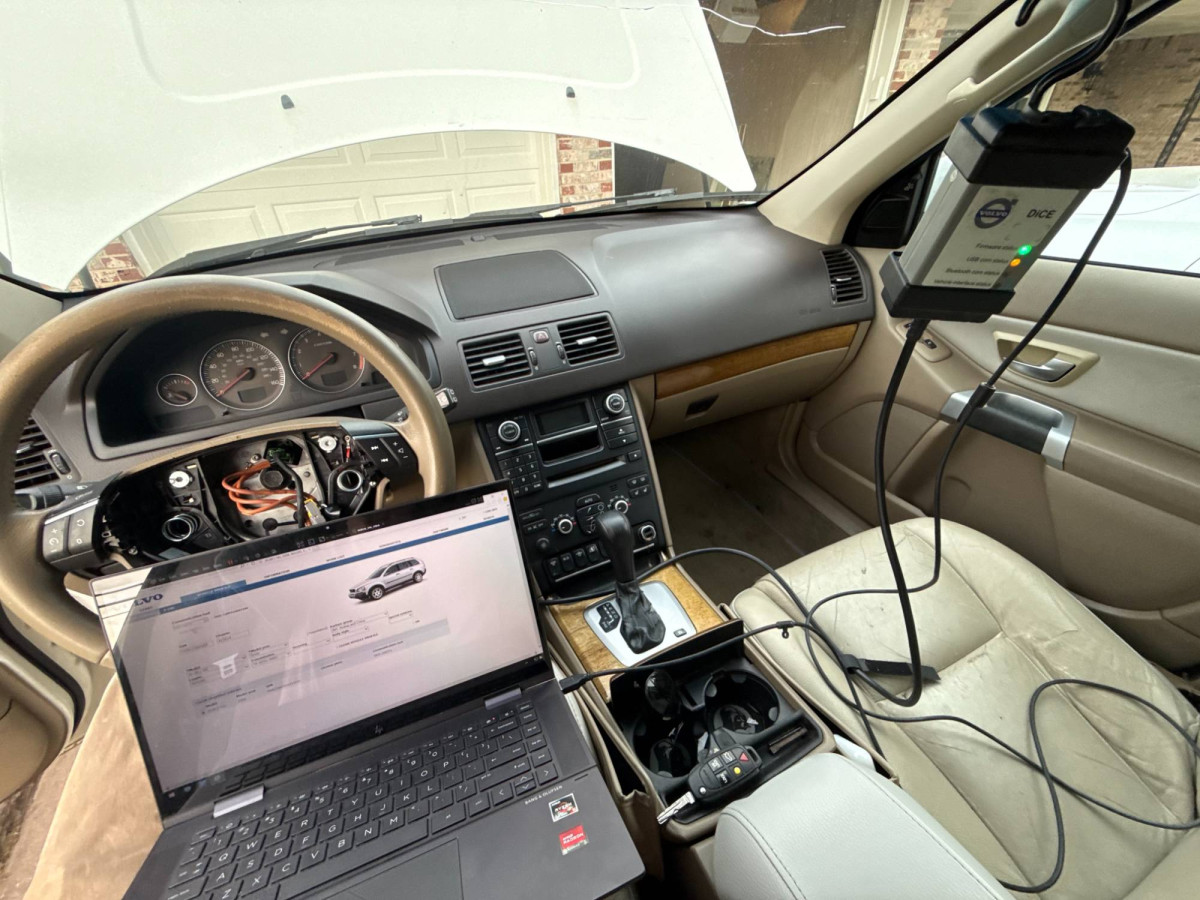

Its running as smooth as a 185,000 mile XC90 can run, save for the front suspension needs some attention, the accident really jostled that motor around and i'm feeling more vibration in the steering wheel... speaking of the last piece to this Volvo jigsaw puzzle...

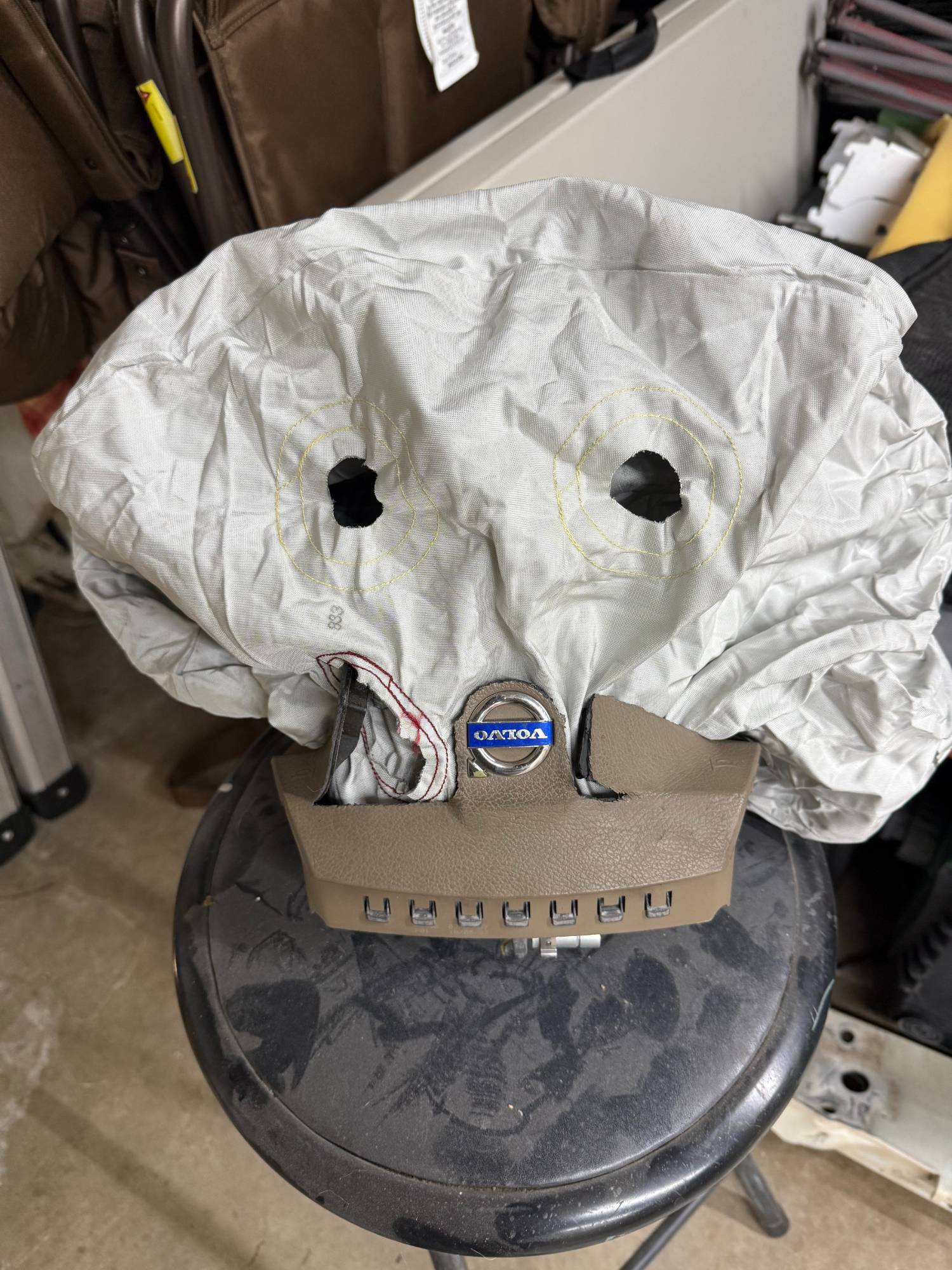

When removing I had to snap the clips off on the airbag itself, got a new clock spring anyway... my problem I'm trying to solve now is finding this airbag inparticular with the third gray wire at the top... can't find these at all and i'm not real sure what that connector is for...

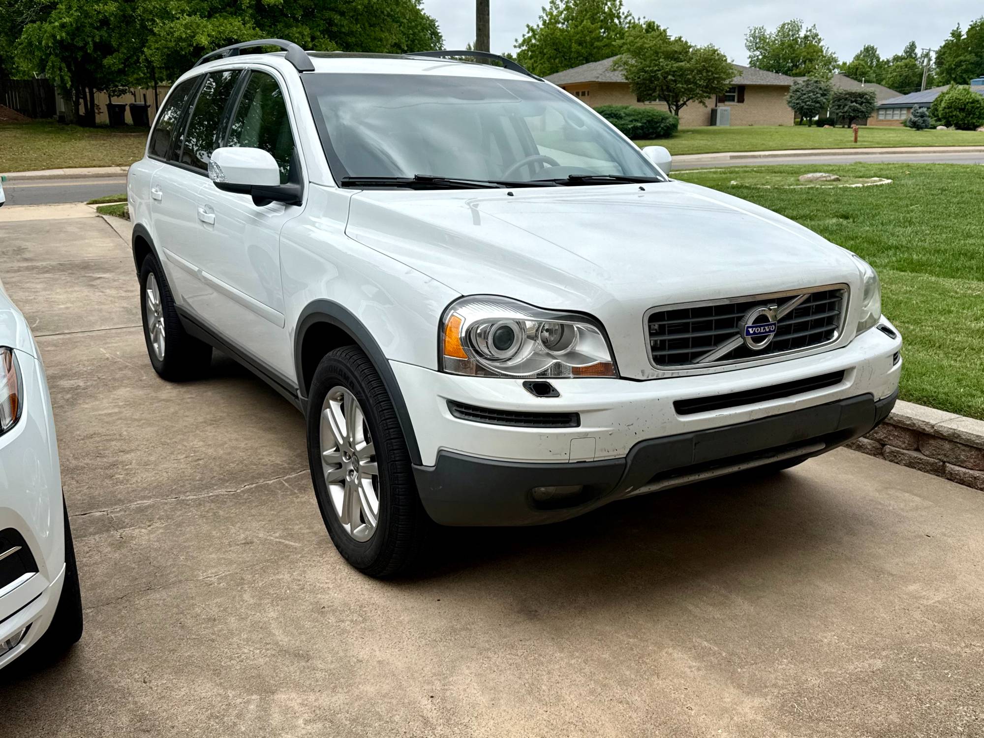

Even though I have a massive gaping hole in my steering wheel and an annoying SRS code it's running great. Took some work, but in the end after some frugal shopping I manged to get this on the road (sort of) better then it was before! Shes still a Beaut!
If you made it this far, thanks for reading about my journey! It's been a cool minute since I posted on here and just wanted to share with ya'll!
