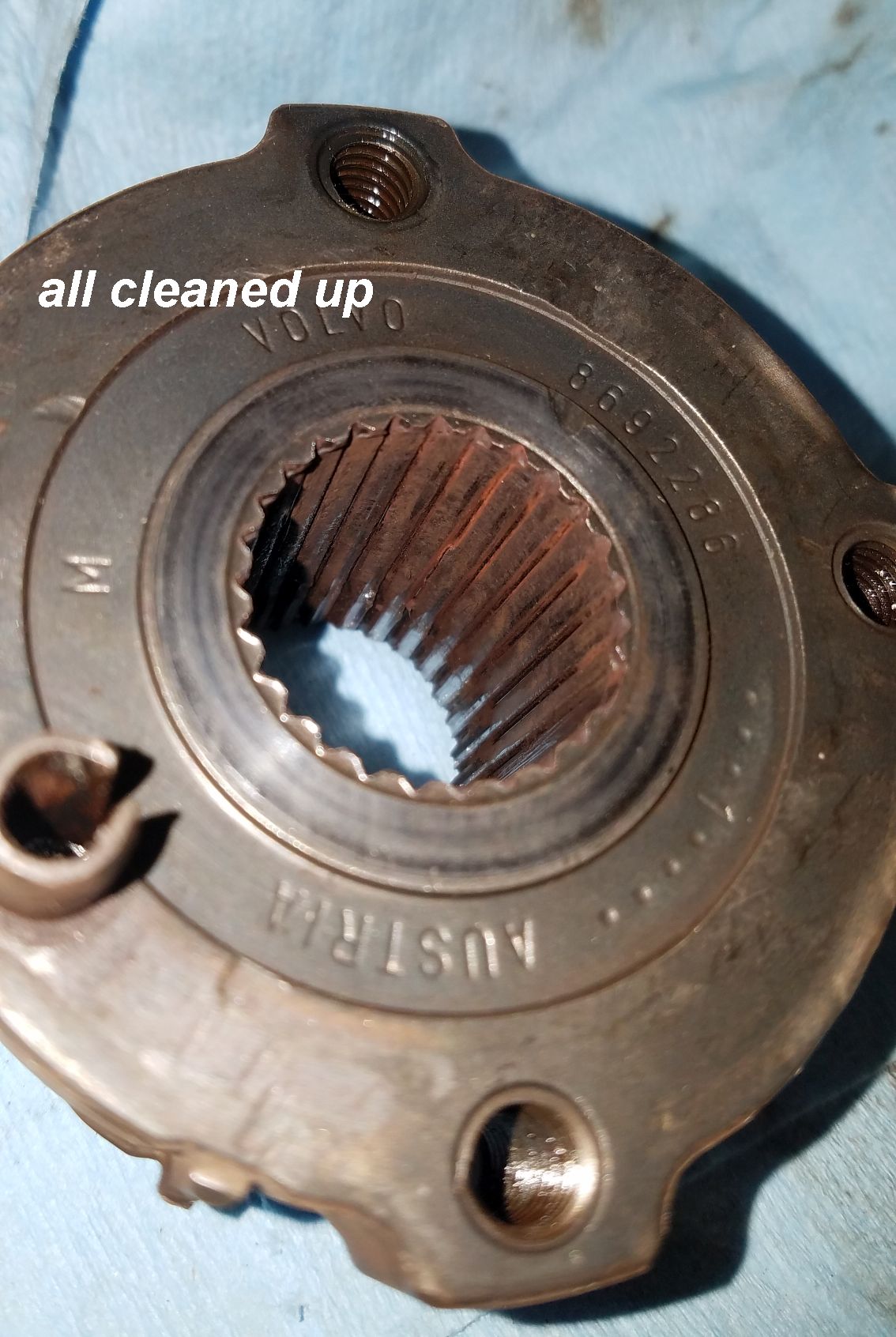

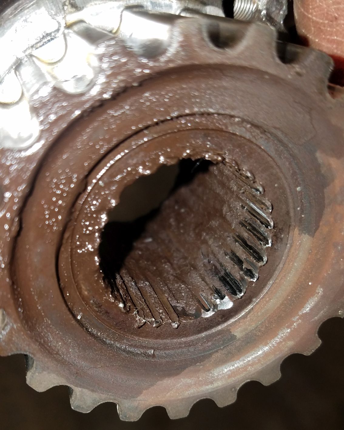

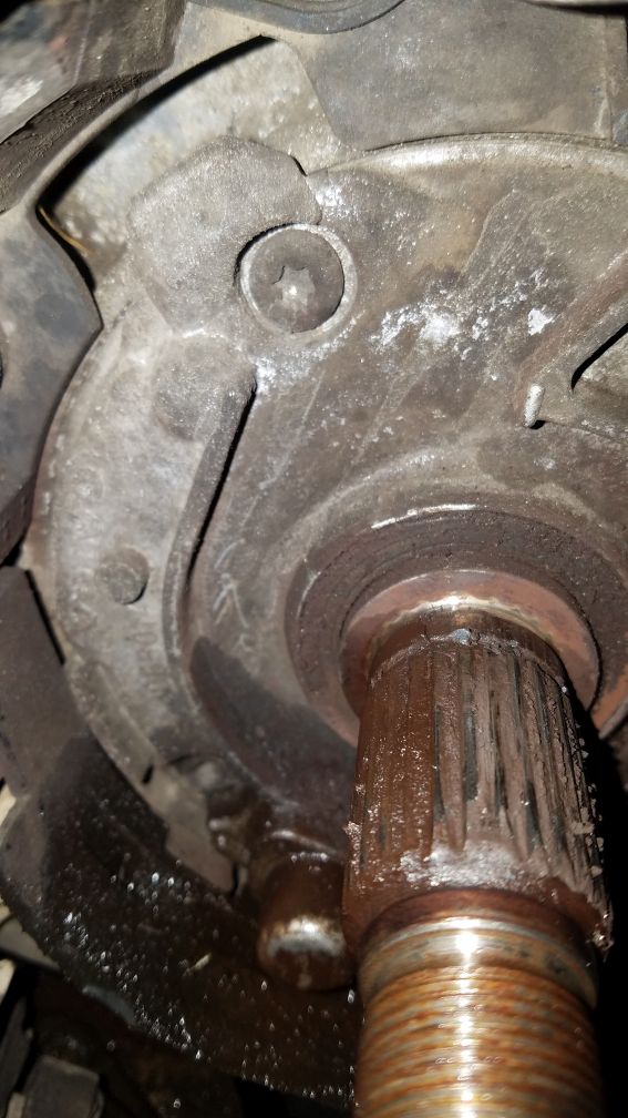

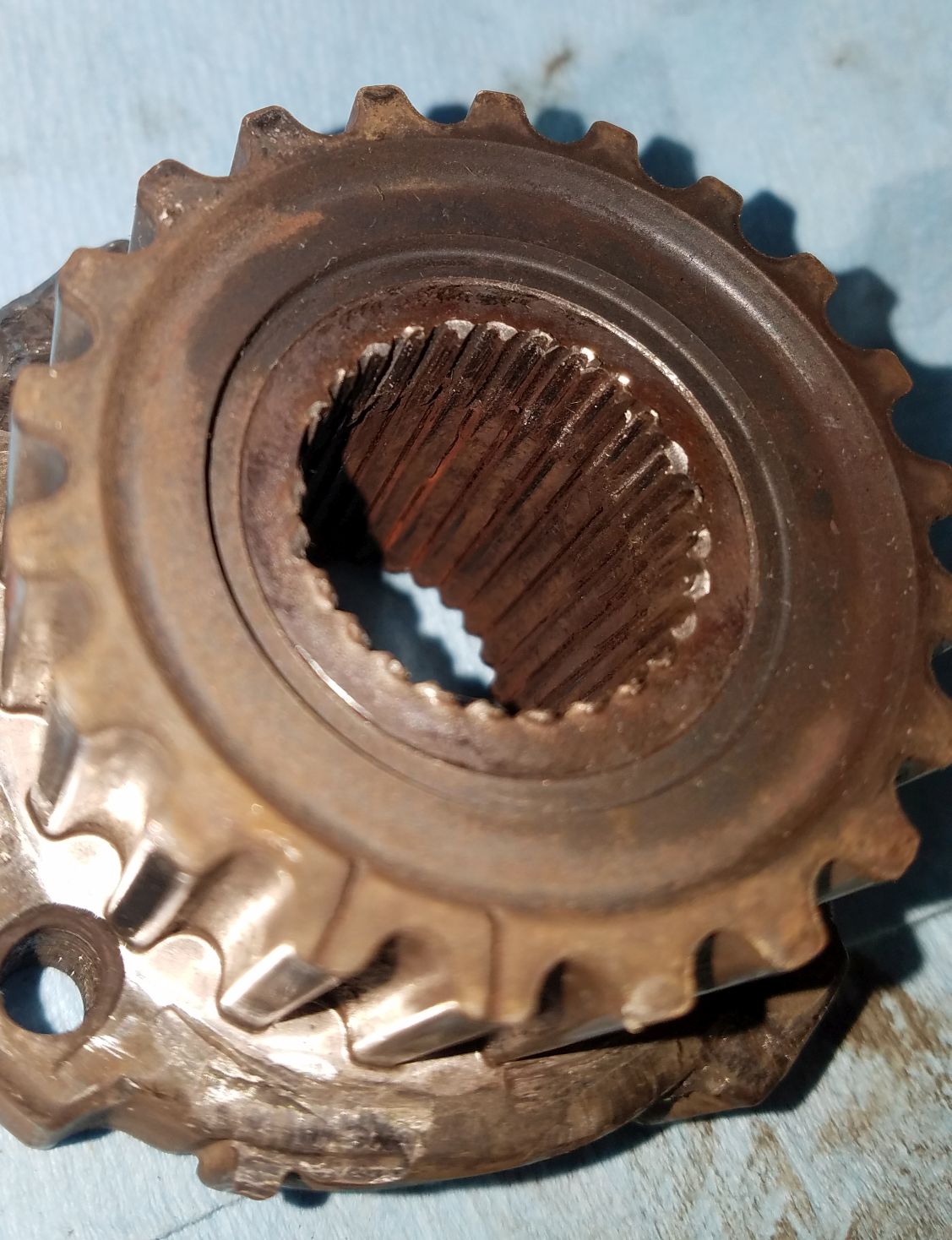

The crankshaft sprocket was hell to removed. I had 2 different PosiLock pullers to get it off with my air gun. I don't see how it could every move! But it is off now. Here are the pics. Maybe a new lower crank sprocket will fix this.

1. Not sure why you have to remove the crank sprocket. It is never the cause behind no-start.
2. Anyway, since you are there, the oil leak is evident and a new crank seal (Volvo OEM or Corteco brand) is recommended. Make sure you install it back to the same exact depth as it is now.
3. No-start: search forum for "PEM".

Yep, that's exactly the same as what I had. I was fortunate that the gear wore and the crankshaft did not, so I could replace the gear and have it work. (And it was still available!) Interesting note - my crank bolt was on super-tight too. (I always figured that it was someone trying to patch a fix after it was worn, but maybe it works itself tight?) Anyway, it took me (200#) standing on a 5' breaker bar to break mine loose.
Hopefully a new gear will have you back on the road!

Yeah, I'll have to get a new gear. I think it will take some serious pounding to get THAT one back on. I don't see how it could have moved either way. And it did not loosen up as it came off. It was a pain and took full pulling pressure all the way to the end release!
