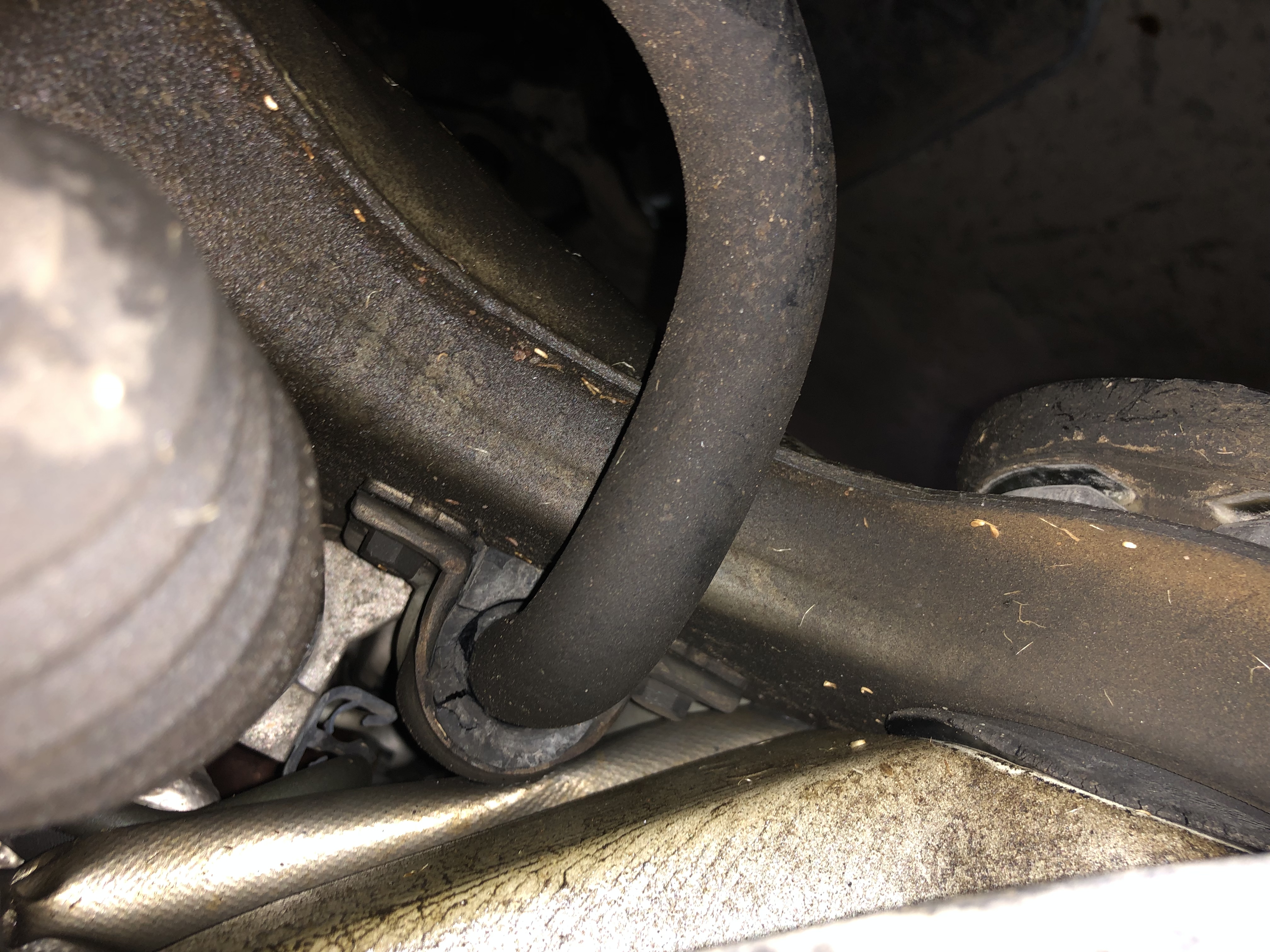

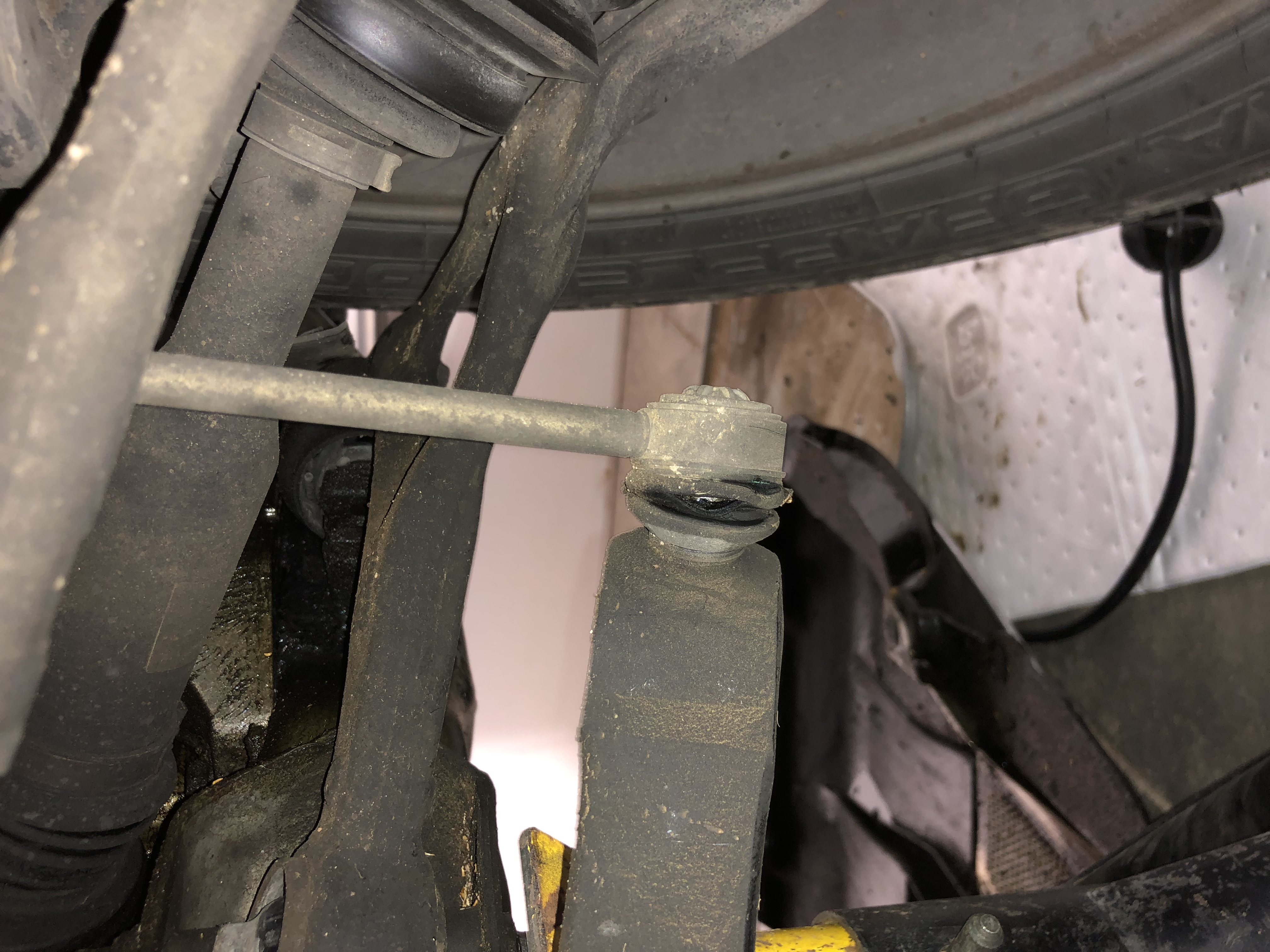

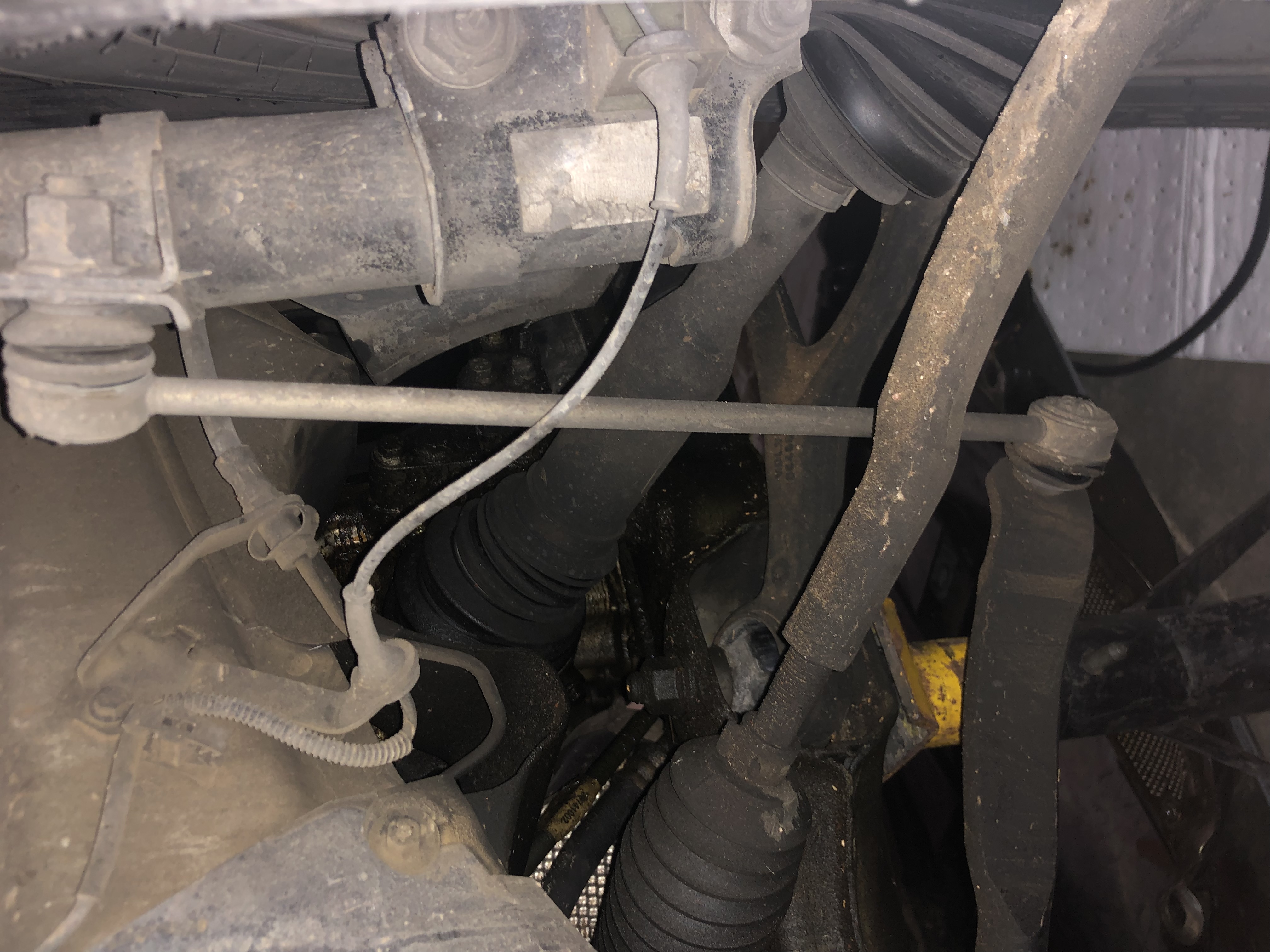

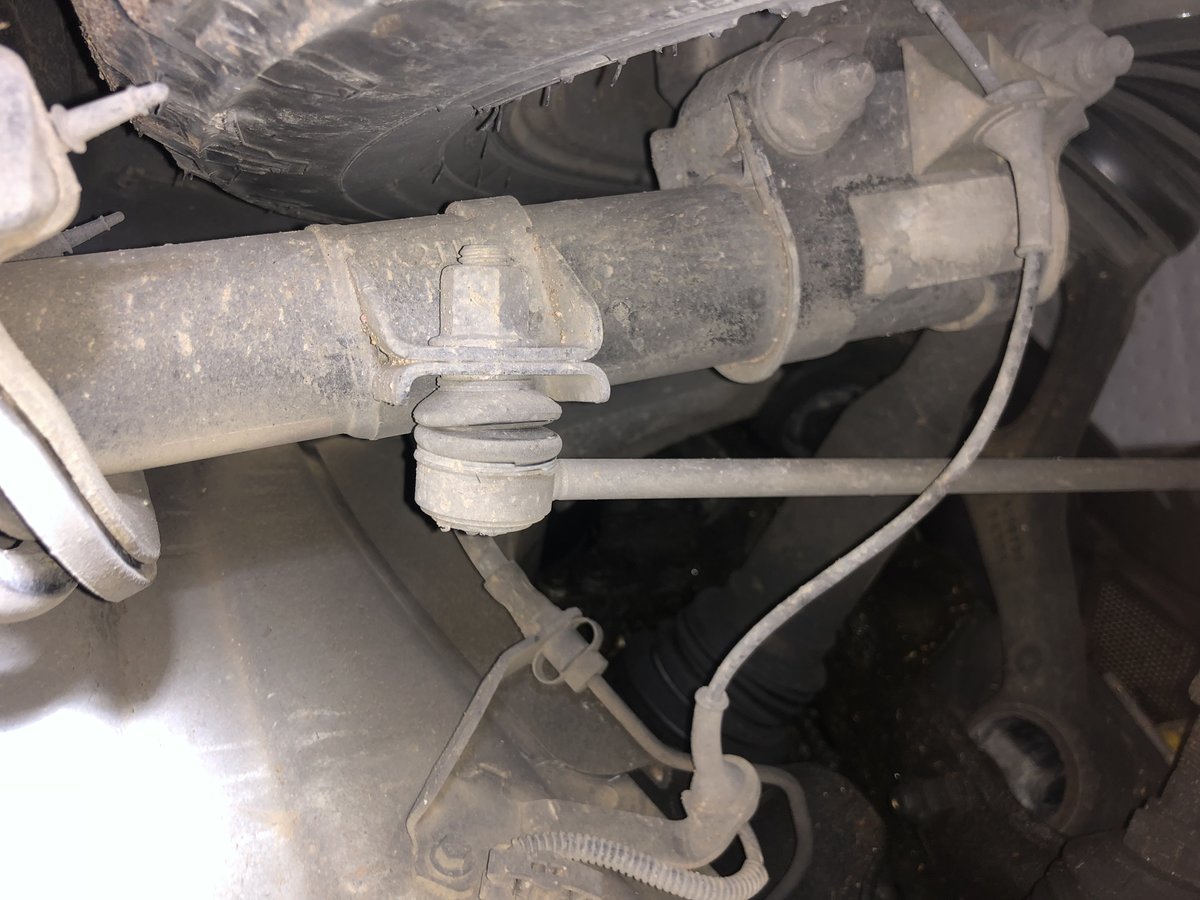

I have attached pictures of the sway bar links and bushings for that side of the car - there isn’t any play in the link when pushing/pulling by hand. All of the bushings look pretty worn?

photo 2 screams sway bar end links.
Easy to do, buy OEM they last longer. I have bought all the brands and OEM seems to do best. Site sponsors have them.
Note - a hit at the right speed and right angle can take out a brand new one.
