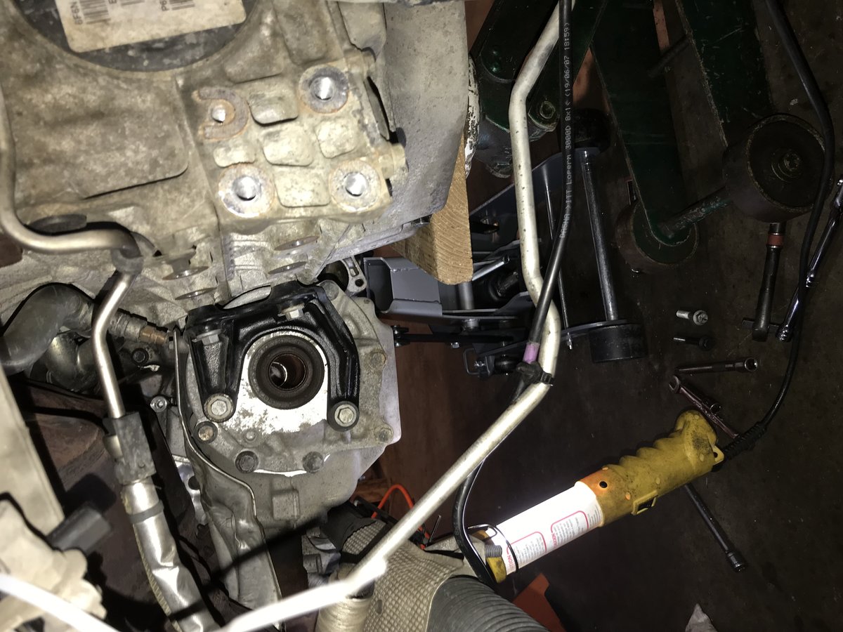

The RH ones should go all the way through the angle gear an slip into the transmission with only a twist to get splines aligned. Left side as mentioned above but you usually have to get it spline aligned and then pop it inward. The snap ring gives resistance and has to be compressed to go in so some effort has to be used. I often pick up my rubber mallet and smack to get it to jump in. I always lube the LH one on these 5 and 6 speeds with dry axle gears so not only does it go in easier, it will come out without that big fight if it has rusted. Wheel bearing grease or grease gun chassis lube are fine for this.

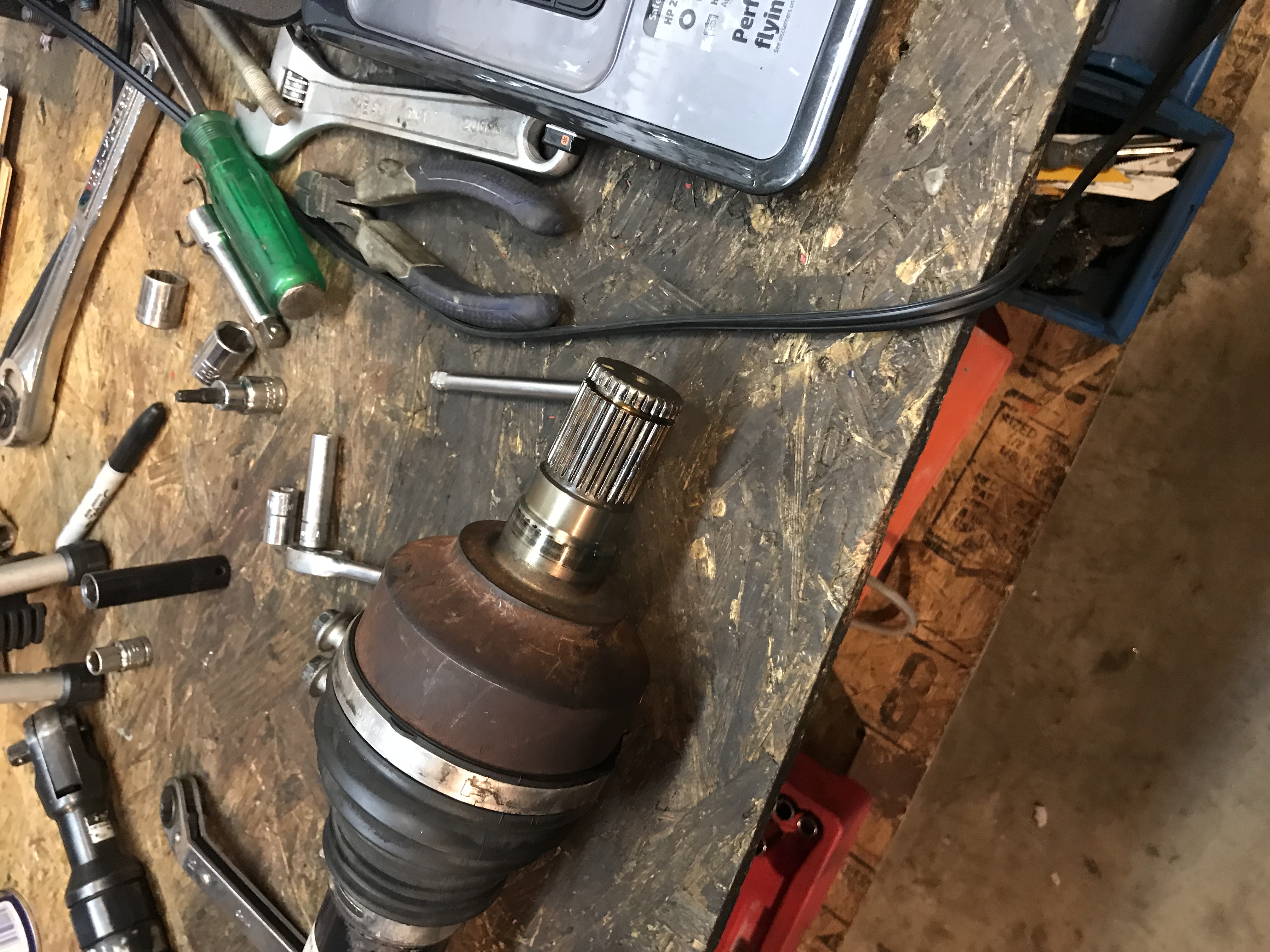

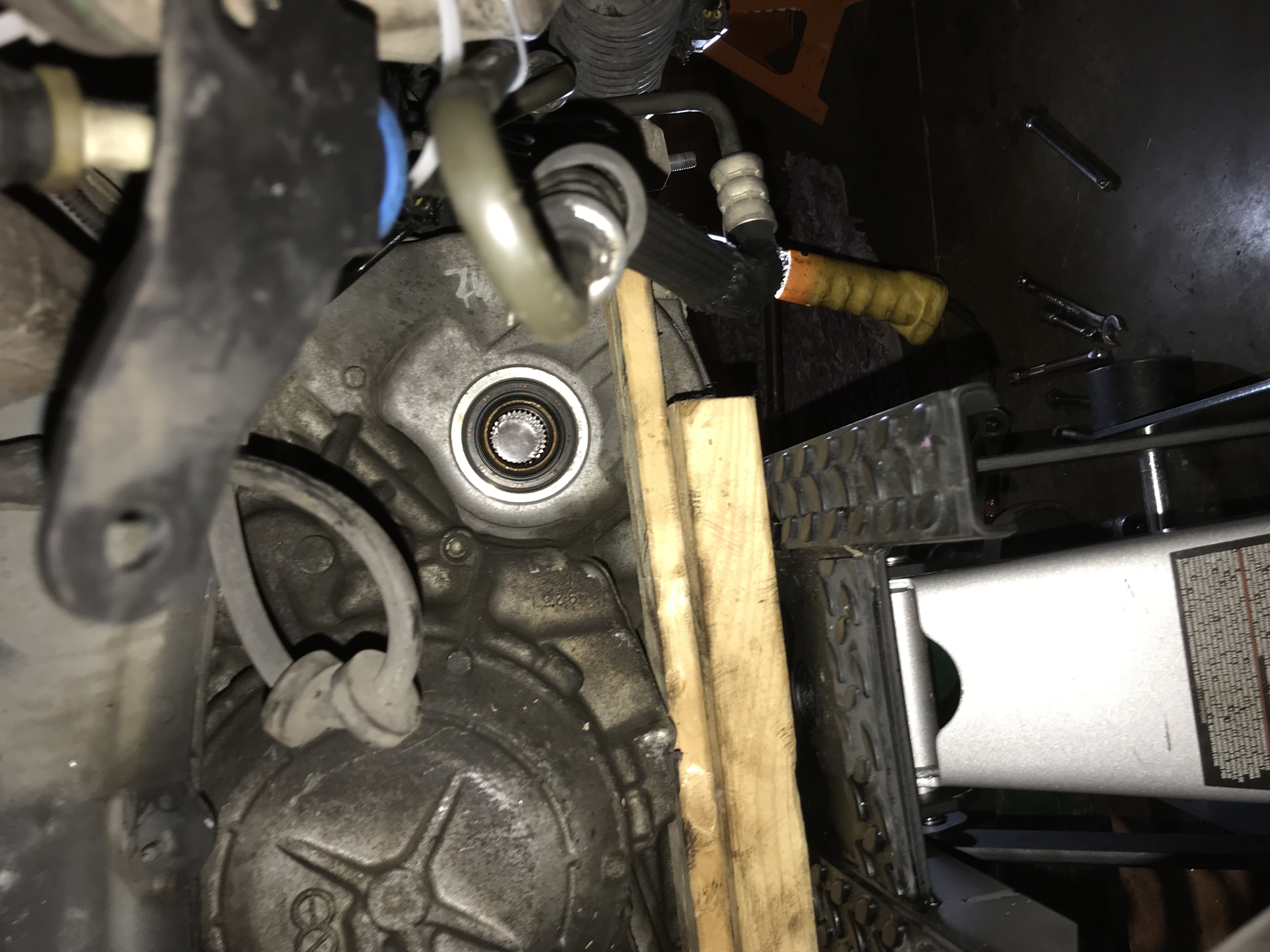

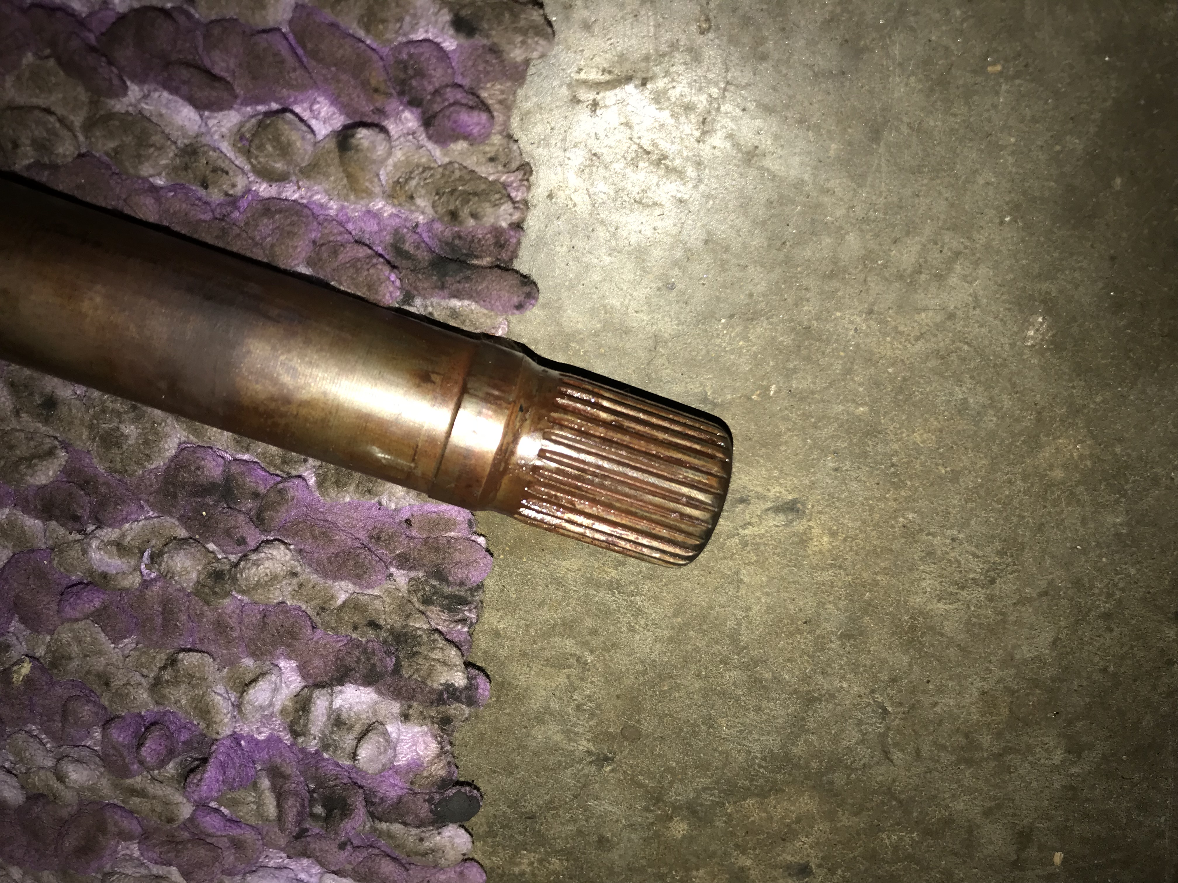

I now see the shorter driver's side CV Axle/shaft has the clip on he end so I need to lube and center it but the passenger side cv Axle/shaft doesn't. It goes it so far and no matter how much I turn and twist it for the gear threads to line up it wont.
Just added photos of axle install points

SuperHerman
Posts: 1245
Joined: Mon Dec 01, 2014 1:28 pm
Year and Model: 2004 & 2016 XC90
Location: Minnesota
Has thanked: 0
Been thanked: 118 times
United States of America
SuperHerman
Re: Front axles wont go back in.
Post by SuperHerman » Thu Feb 28, 2019 5:30 pm
If I am following your endeavor, you should have the old transmission. Give jimmy57's insert, twist to align, suggestion on it.

Post by PoppySheaf » Thu Feb 28, 2019 5:35 pm
Wife brought in some Chinese for a garage dining experience!
Organ Donor Tranny is in! Lots of hookups left to do including getting the stubborn axles back in!
Jimmy my man I greased up the dry difficult one and it went right in!
