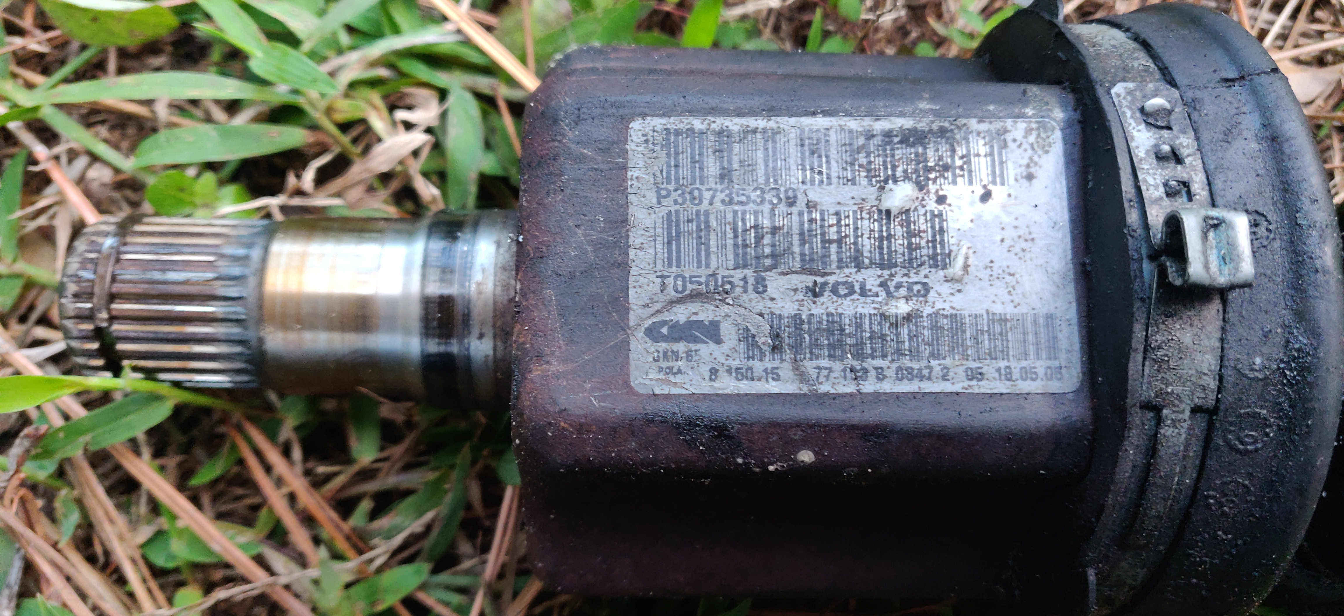

I'm working on my son's 2006 S80 2.5T FWD. The inner CV boots are off on both sides and the joints appear to have contamination at the least.
I ordered replacement axles from the corner parts store and pulled the driver side axle to find that the transmission side of the new axle was not the same as the old (new was "female" while old was "male"). Looking on the internet, there is not clear information on which axles are the correct ones or how to figure out which to choose. Viscous? Non-viscous? Who knows? One post here on MVS said that if the passenger side axle has two sets of inner splines, it is viscous. I don't see two sets of splines, but the wrong part I ordered before was labeled "non-viscous." The attached photo is the transmission end of the driver side axle.
Is this something the dealer can clarify? Voodoo? Tea leaves?
OEM CV axle, transmission end

I ended up getting axles from Voluparts in Atlanta, who deal only in Volvo parts. Raxles didn't have any at all, and Axles Unlimited was as uncertain as I was. Bill at Voluparts sent me the following information:
all 06s have a 5 cylinder motor in them. No 06s have viscous couplers - only the early 6 cyl. ones might have one on the rt. side.
Bill's prices were reasonable - some of the best I'd seen - and his shipping was amazingly quick. Everything looks great with the parts I got. I highly recommend him. http://store.voluparts.com/
