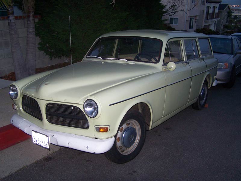

I just bought a 67 wagon (project) for my daughter. The car was in good running condition when it was parked in the garage........ 10 years ago! I checked all the fluids and they are all full. The old fuel in the system concerns me.
Any suggestions regarding the old fuel (tank, pump, lines, and carbs)?
I was planning to:
1. Drain the tank
2. Remove and clean the tank (suggestions?) and reinstall
3. Remove carbs and soak them in fresh gas overnight
4. Crank the motor and pump fresh fuel (mechanical) through the system
5. Reinstall the carbs
6. Fire her up (with fingers crossed)
Any suggestions?

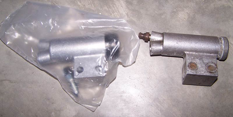

Okay, now she's running (off auxilary tank) but the clutch is gone. After closer inspection, the clutch master cylinder was still moving fluid, but the piston in the clutch slave cylinder is seized (and pitted). After removing it, it seems that no amount of 'encouragement' will free it up. I ordered a new one this morning ($100+- ouch!). I hope that the master is okay...... but won't really know until I replace the slave. It requires a lot of pressure to move the clutch lever. I suspect that when the new slave is installed, the master will leak. The only consolation is that the master seems to be rebuildable..... $20 rather than $200!

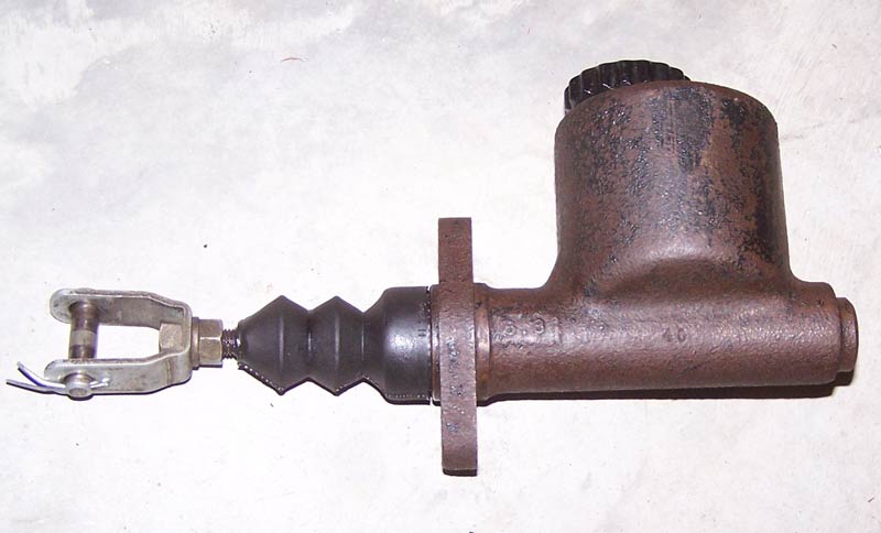

The brake master cylinder is not functioning either (I figured this out after wasting time attempting to bleed the brakes). The resovior was full of clean fluid, but the fluid doesn't move. I also removed this from the car but have not had time to look closely at it. I am able to move the piston and am hoping that it is rebuildable.

It is encouraging that the engine runs, albeit from an unofficial tank. The master cylinders of that age were designed to be rebuilt. I did several over the years. I'm not sure if parts are still available but someone, somewhere will have a seal kit that will fit. It is just a case of knowing which system it is.

Turns out the brake master cylinder is okay. I took it apart, lubed up the piston and tapped it with a hammer and the entire thing sprang apart. I will try and take a picture of the internal parts. Because the master cylinder is made of steel rather than aluminum (like the clutch slave) it is still in good shape. There was only a little build up inside and I was able to scrub the inside of the cylinder with a green scruby pad. I put the entire thing back together and plan to install it back on the car tonight. I want to build a little pump to force (under pressure) fresh brake fluid through all the steel brake lines. It seems like all the old fluid crystalized and gummed up the system. I think if I were able to force some fresh fluid through I will be able to salvage all the old lines..... more on that later.
NOTE (for newbies like me)- I took both parts to my local independent volvo mechanic and he wouldn't even consider rebuilding them. The aluminum clutch slave was beyond rebuilding due to pitting (no mystery there). The shop didn't even want to spend 5 minutes looking at the brake master cyl. He quickly suggested buying a new one for $200. I took the parts home and after a couple of minutes had the entire thing apart, cleaned, and put back together. For all you DIYers out there. Spend a few minutes and check things out for yourself. These old volvos were very well made. As Bill mentioned earlier... most of these maintenance issues can be done at home (volvo designed it that way). If you take it to the shop, I guarantee they will take your money. If you have more money than time, the shop isn't a bad option.
