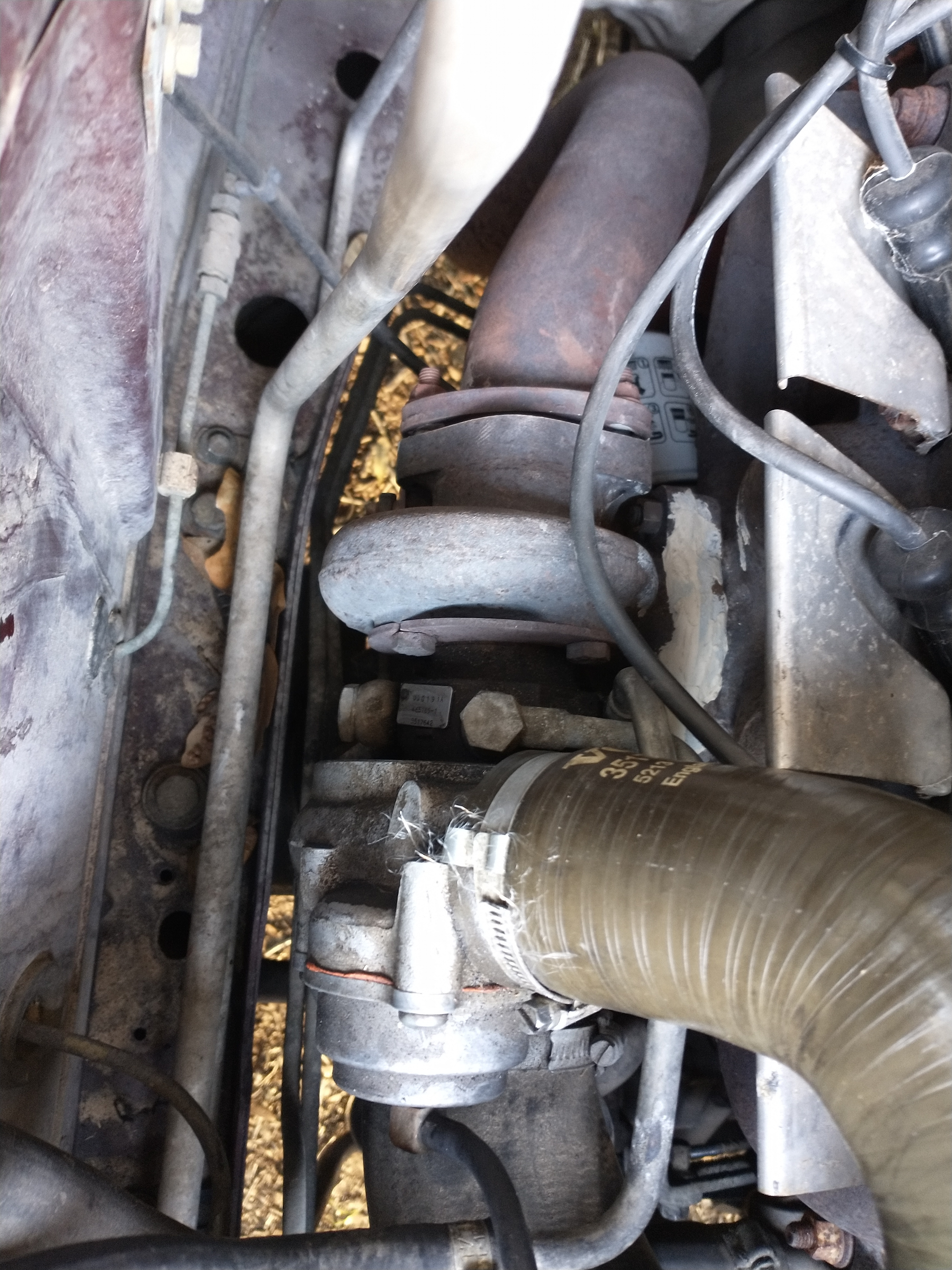

I have a 1991 940se bit don't know of I have the Garret or mitsubishi turbo. Can anyone tell the difference?

Looks Garrett to me. Now to determine if it's the turbo that was swapped or if the engine was swapped. By 1990 a Mitsubishi TD04-13C was used on a 760.
