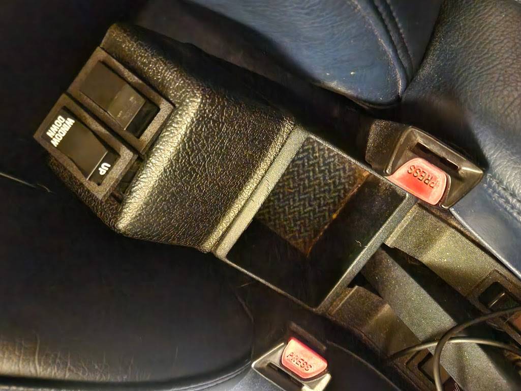

Questions for the gurus here.
First, the cockpit layout doesn't seem to jive with other 1987 examples I have seen on the net in that the window lift switches are mounted on the top of the e-brake housing and are the older-style rocker switches vs the ones I have found listed for an 87 240. I'm in need of a switch (the one on the right is just a shell with no switch components) and also two retaining clips to keep both in the housing. Any ideas where I could find them?

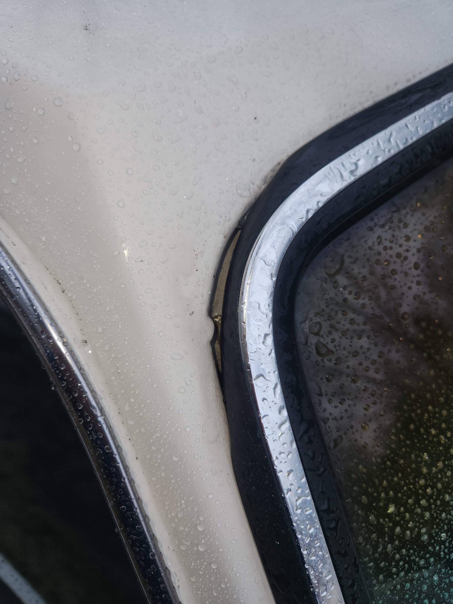

Second, the upper edges of the windscreen gasket have shrunk and pulled away, leaving a gap. The windscreen doesn't leak, but should we seal the gaps with silicone or something similar until we eventually replace the whole shebang?

Consider:
Driveshaft U-joints and center bearing condition. There is a rubber support in the center bearing that may have sagged.
Brake hoses (as mentioned above).
Silicone sealer does not last well as a windshield sealer. I tried it. Butyl rubber may be better.
