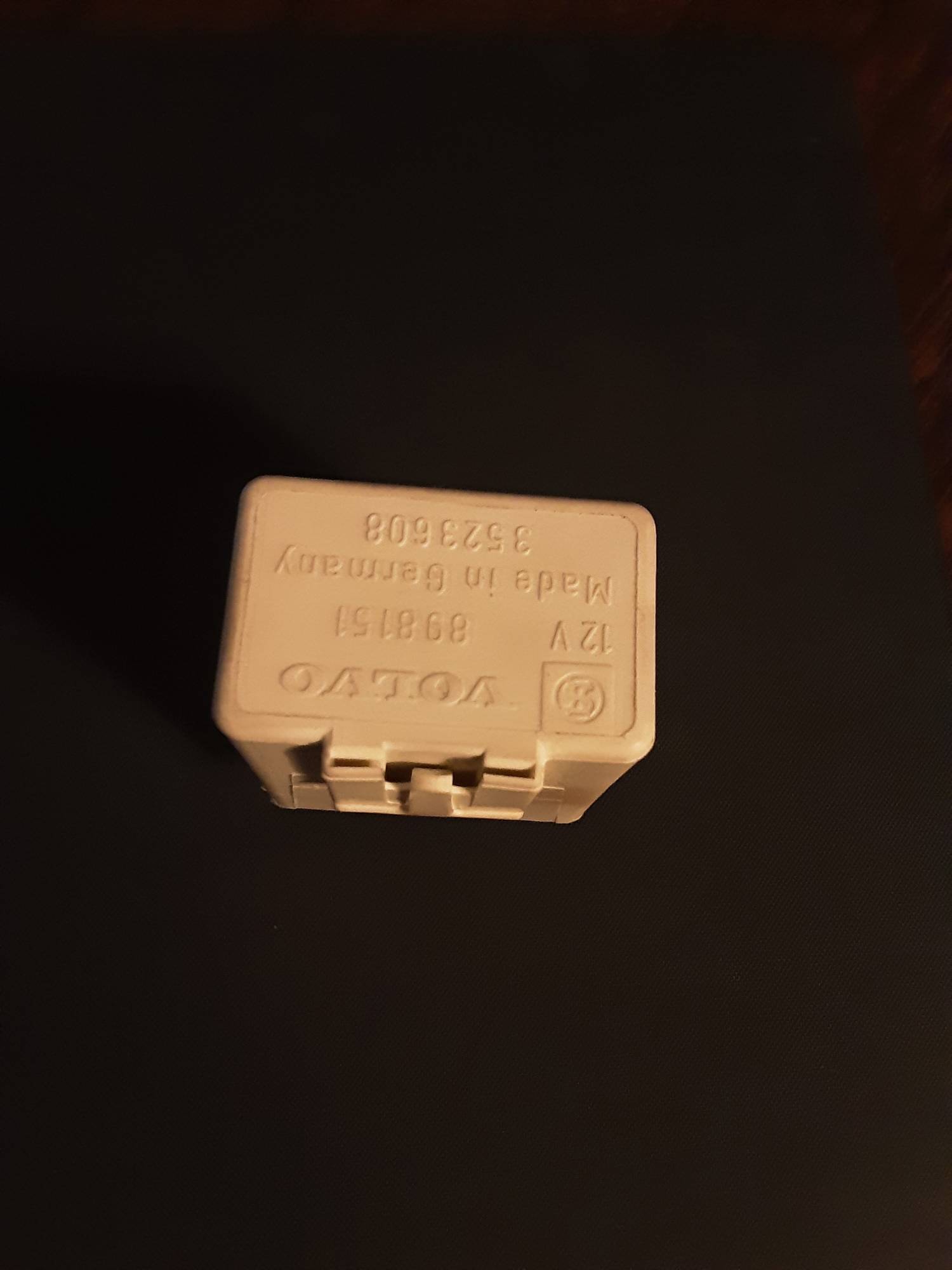

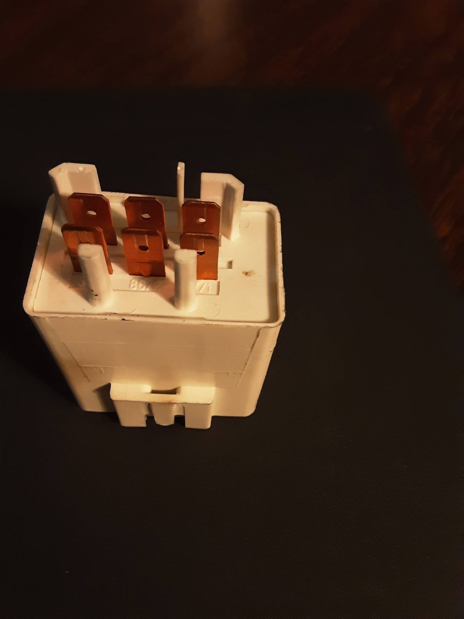

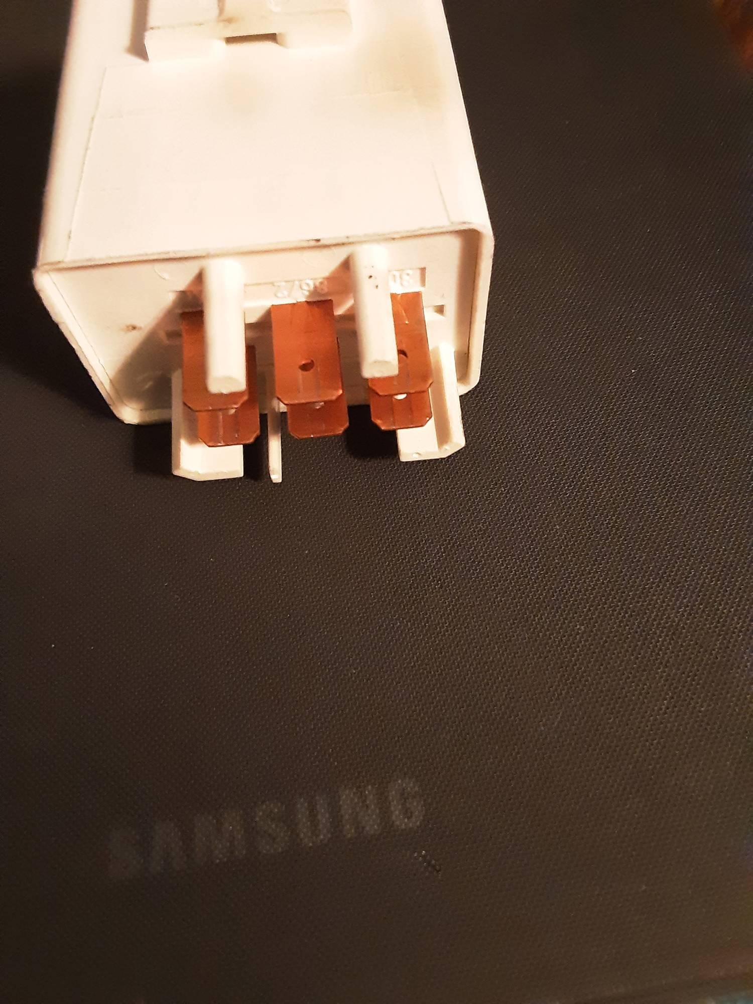

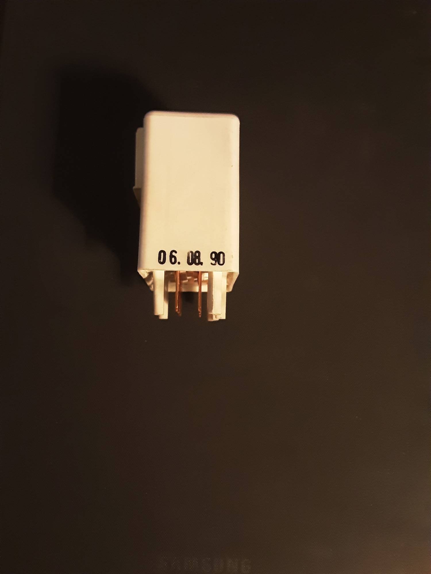

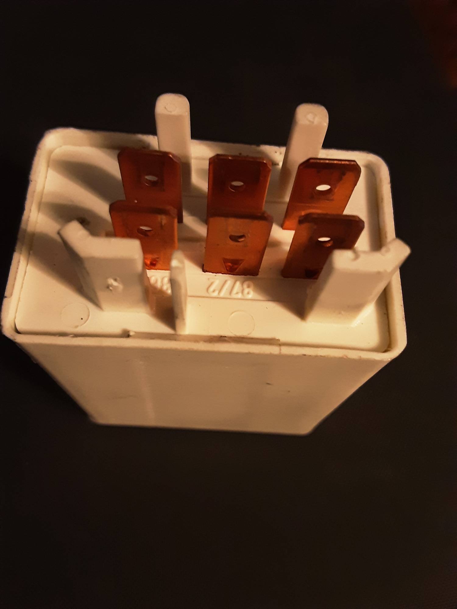

Anyway I bought a replacement relay on FCP Euro and finally I got around to putting it in. Surprisingly the original Volvo relay looks nearly new physically. Really everything wires/electrical on this car looks nearly new. I did install the new relay since I was there. Here are photos of the relay I removed from my car. The original relay has copper prongs and the replacement has steel prongs. Both have the same part number. The in tank pump still only runs for a couple of seconds. Is this normal? June
Addendum: Robert has videos recommending relay replacement every so many years to circumvent getting stuck. His video on the subject is the main reason I bought a new one to begin with. Also the 1990 240 with the buzzing relay leaving it's owner stranded. My car is a 1991 with 202K. So the original did it's job and now will be the spare in the glove box. June
