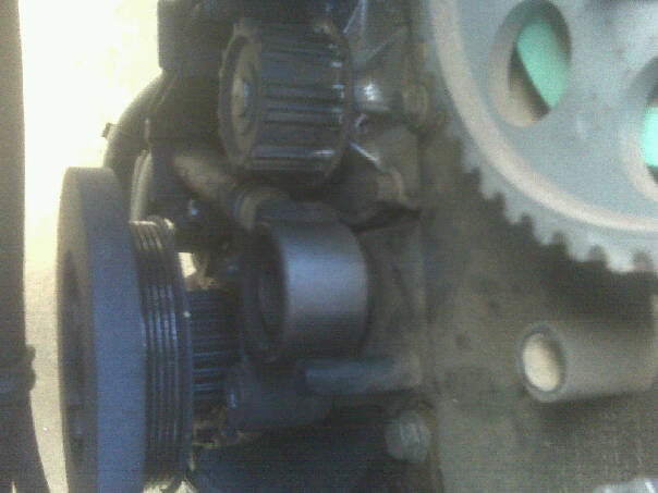

You can't quite see it, but there is a very faint indentation that lines up with a post coming off the case. I marked the top of the pulley where the little indentation lines up. Unless you have taken the pulley off, you need to rely on the marks. The cam marks are simple enough to understand!
Volvo Crank pully.jpg (39.27 KiB) Viewed 3593 times
