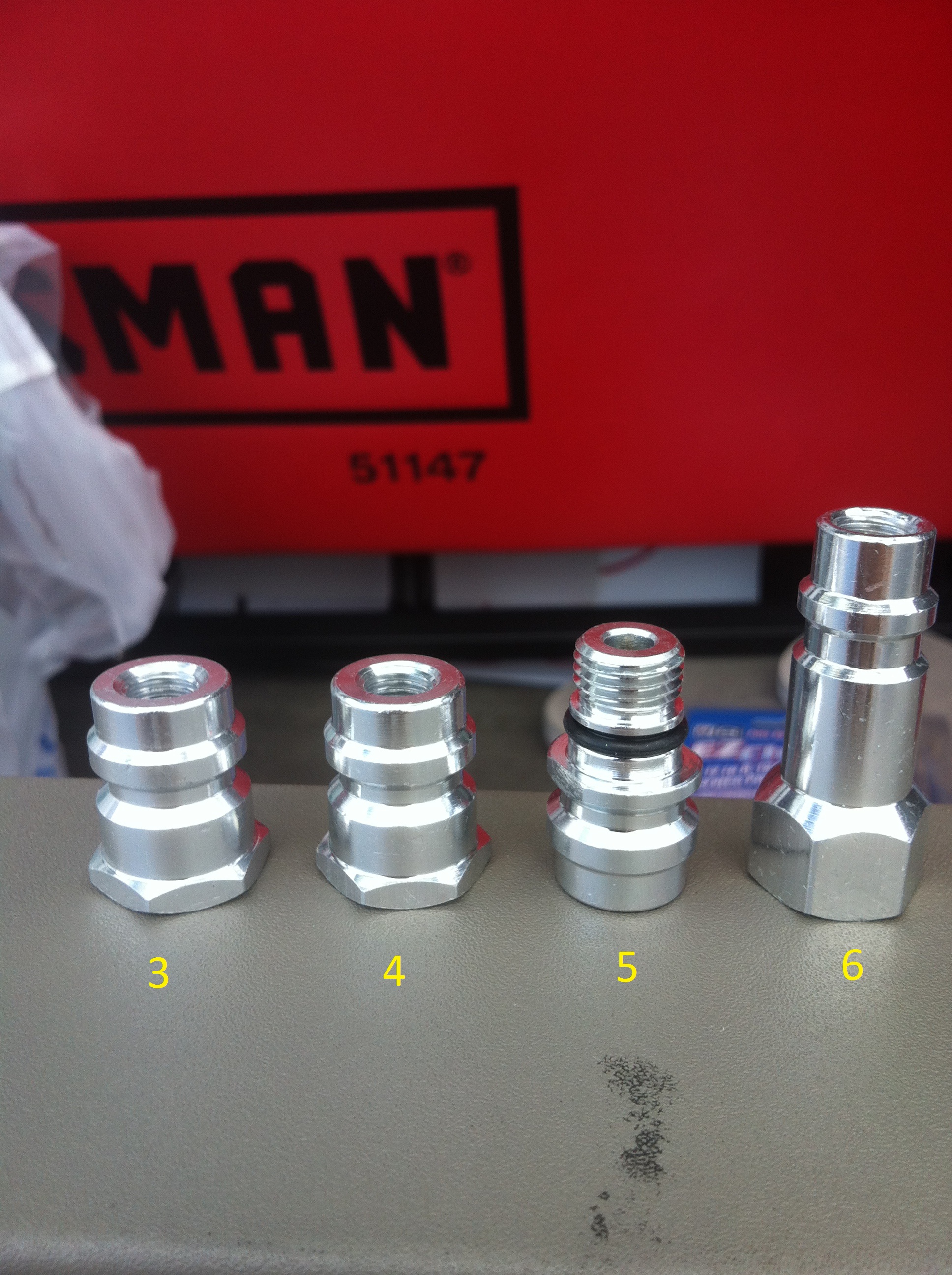

I have a question about converting the old R12 system to R134 system for my 91 Volvo 740.
I've posted this question in the 740's section but didn't get any answers so I am posting here, maybe some of you guys have an idea and this section seems like more active than the other section.
After doing some research, I found out that I need to put some adapters and evacuate the system before charging the Freon. I've got the adapters from Walmart yesterday but not sure how I am going to install it.
If you look at the picture, I think I need to insert the adapter at "2", is this right? is this where you charge the freon? in other words, is this the low side pressure port?
What is number "1" for?
Any input is appreciated...

neworleans,
The adapter kit you purchased at Wally World SHOULD have 2 different size fittings in it. The smaller of the two would be the low side adapter and should have a blue cap on it while the larger of the two is the high side adapter and should have red cap on it, though I've seen kits with both caps being black. If this is the case, the smaller of the two is the low side adapter.
Yes, # 2 appears to be smaller than #1 and would be considered the "low side" which is where the system should be charged. NEVER EVER try and charge the system through the "high side" Luckily, with the difference in the size of the adapters and the size of the freon fitting off the can it will only fit the low side.
The cylindrical cansister where the low and high side fittings are is the call an air conditioning accumulator or reciever/drier. that swich on the side is the a/c compressor clutch cycling switch.
If the A/C hasn't worked in a while or... even if it has, it's a good idea to get a small machine capable of putting the a/c system in a recovery (which where it takes all of the old R-12 refrigerant out of the system) and vacuum (to make sure it holds and there are no leaks.) after putting the new adapters on.
Then, go ahead and charge up the system with the new R134A refrigerent. Look around for a label underhood that tells you how many ounces of freon to put it. You don't want to put too much in as it may result in too high a pressure and a constant cycling of the A/C compressor.
The #1 fitting is for when you hook up an a/c machince to it to recharge or evacuate the system and/or for when you put a set of A/C guages on the system to get a reading of the pressure in the system.

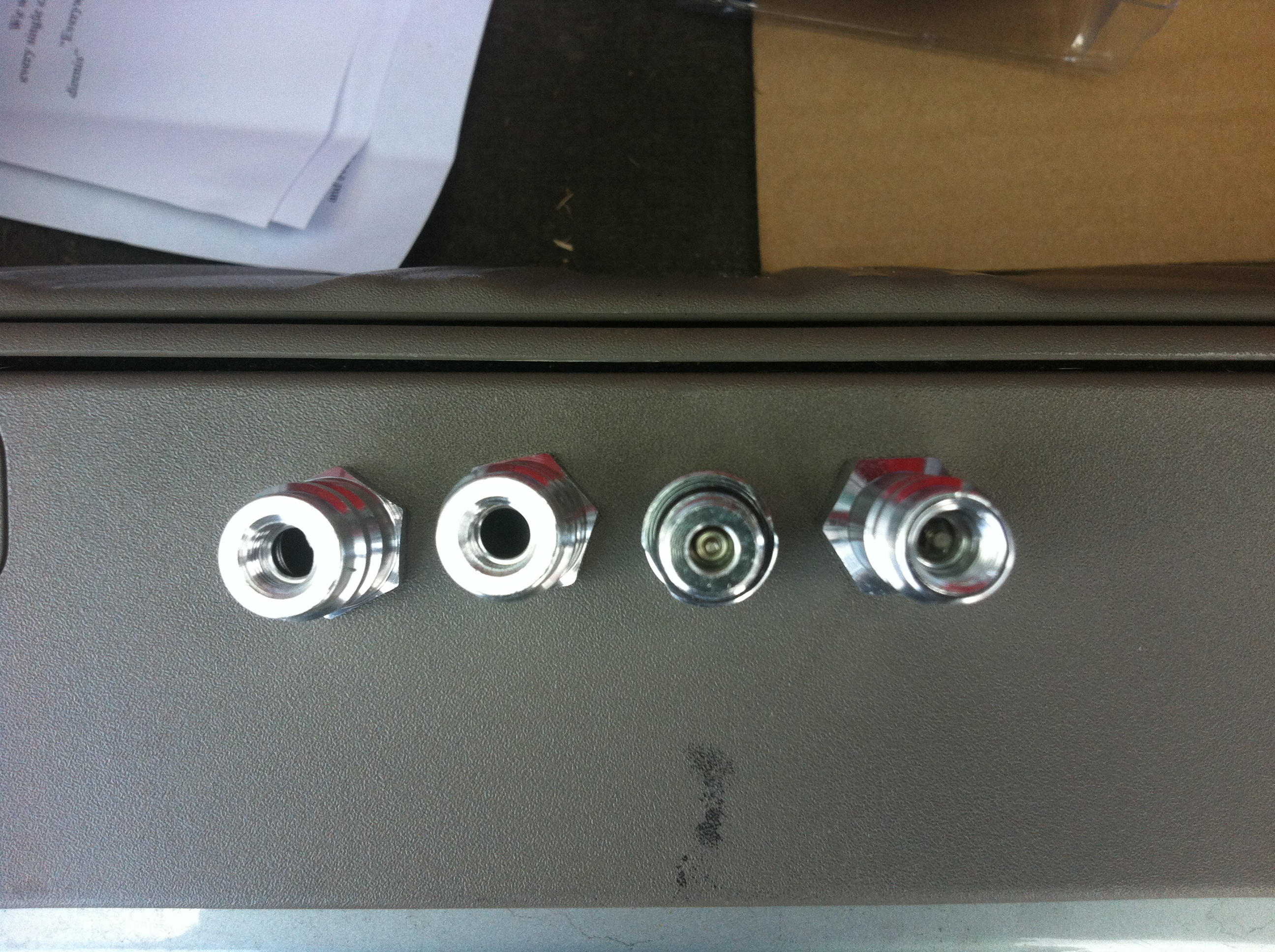

Thanks for the replies.
I had my 850's ac checked last week at the volvo shop, he hooked the ac machine to the low side pressure port, recovered it first and then charged it. I am not sure if they have a different machine just for these old model cars but I don't think so, the machine is pretty big with a big freon tank, i wouldn't keep another machine in this size to hang around in the shop just for the old model cars
. Therefore I bought this set to convert it. I am going to bring it to the same shop and wanted to be prepared.
The adapters in the pictures came with the kit, I don't know which ones to install at the moment. Since they use only low side pressure side when charging, do I need to install the adapter for number 1?
