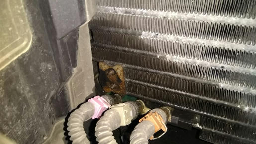

Metallo
Posts: 232
Joined: Sun Jan 18, 2004 3:20 pm
Year and Model: XC 70 AWD 2.5 - 2006
Location: Canada
Has thanked: 3 times
Been thanked: 2 times
Re: Condenser leaking green fluid
Post by Metallo »
Hi folks,
I think a picture will say it all...
Once I have disassembled the whole thing, I expect to find quite a hole in there...after 23 years, I do not complain though.
I removed all the screws on top of the condenser, apart the pressostats, is there anything else that is keeping the condenser in place, something at the bottom or on the sides?
Any advice is always very welcome!
