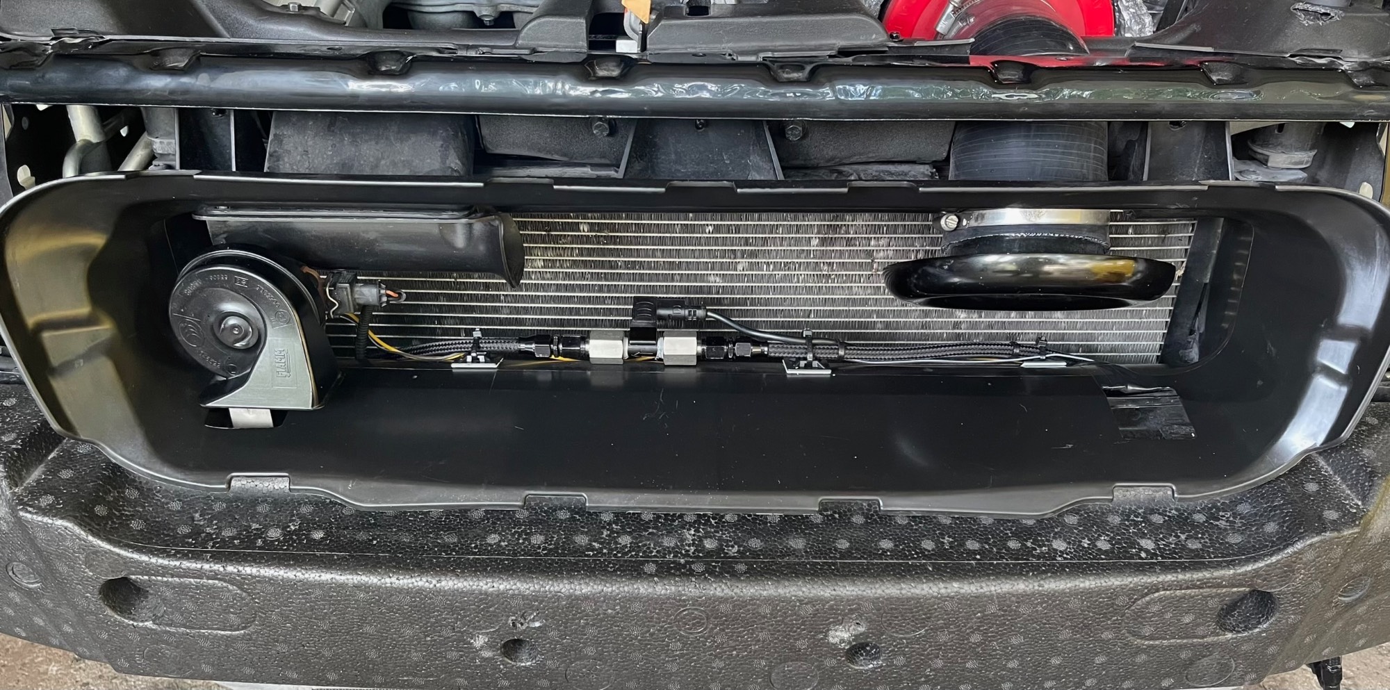

Water/Meth Flow Sensor/Vibrant Bellmouth velocity stack
AEM Water/Meth Failsafe Controller with Independent Power switch
Custom FMIC to TB with Sniper II Water/Meth and Solenoid
Using a solenoid directly next to the nozzles will eliminate the (dribble) on/off effect you get with check valves. All tubing and the stainless steel coupler can be found at SiliconeIntakes.com The Sniper II and the solenoid and nozzles can be found at ProMeth.com. I have spoken with them and they are machining some new nozzles that should be ready for purchase within 3 weeks. When you purchase the Sniper II it comes with really nice stainless T-Bolt clamps two silicone couplers of your choice and the fittings you need to attach the solenoid to Sniper II.

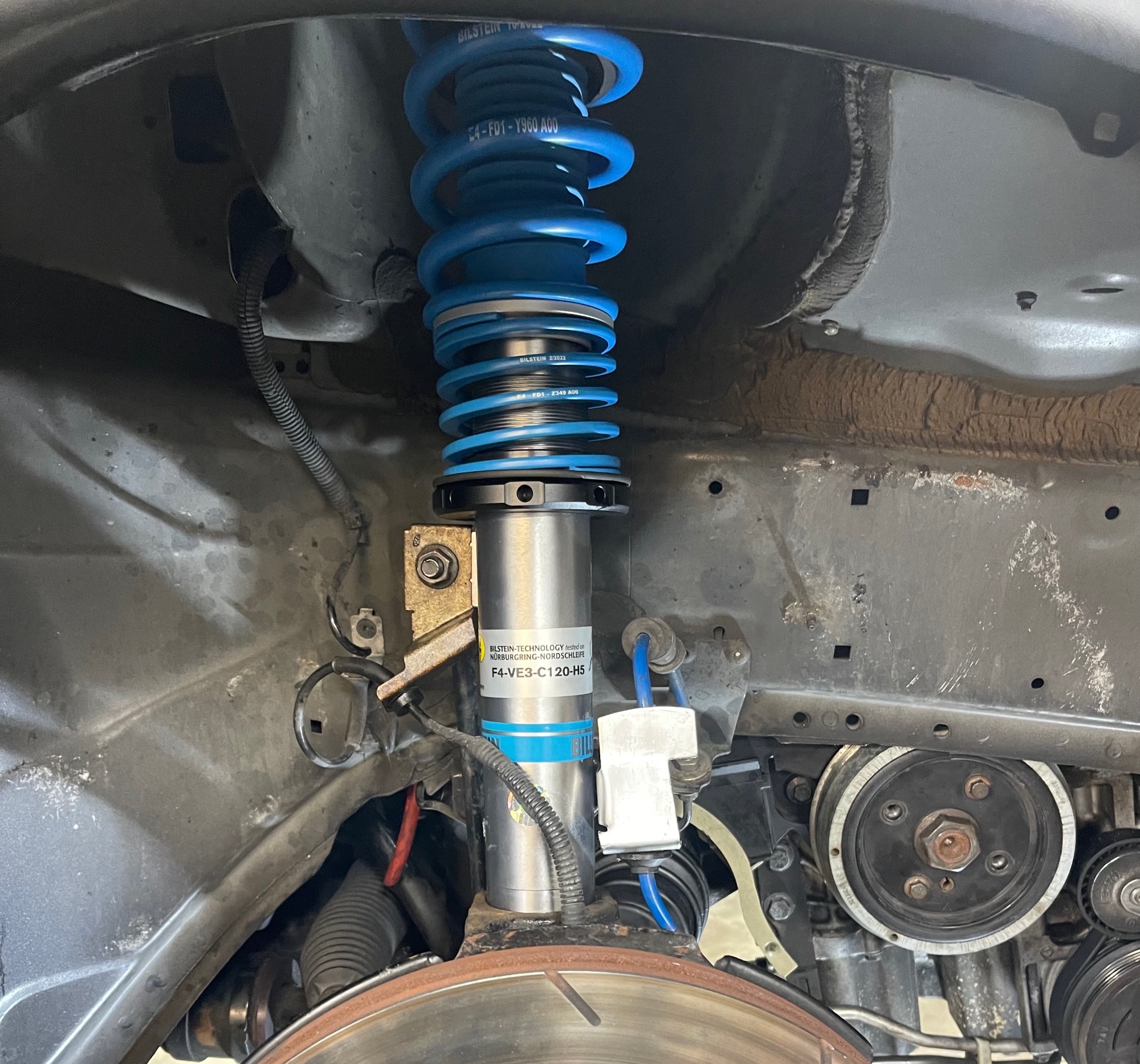

Elevate Sport Springs w/ Bilstein b4 Struts
Hardrace motor mounts with Powerflex Poly bushing inserts for Motor Mounts
iPd HD end links up front (iPd part#124645)
Meyle 90 degree rear end links to replace the "dogbone" style in the rear (KIT-P1SWYBRLNKKT2)
Drivers side (trans mount) w/ Powerflex poly insert
Bilstein b14 front
Bilstein b14 front

Radium flex fuel parallel split-flow flex fuel sensor adapter (part#20-0589)
Radium 6 micron in-line fuel filter with built in check valve (part#20-1220-0X)

Bilstein b14 CoiloversDriveShaft Shop custom axles when factory fail

Bilstein b14 rear
Bilstein b14 rear
