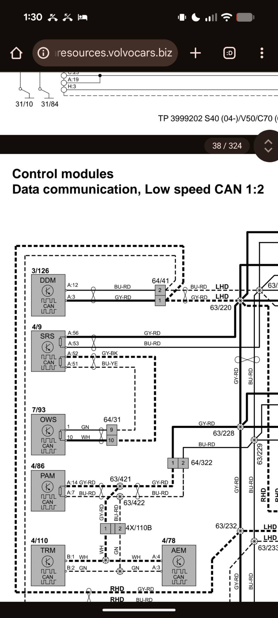

I realized my puddle lights weren't working and TLDR traced it to another corroded CANbus multi-wire splice in the drivers footwell. I first pulled the door card checked the wiring through the module, then checked the ground posts at the bottom of the A-pillar.
Adtee finding the corroded splice I figured it's best not to put it off, so I pulled the carpets and cleaned the floor pans. Tried to compress/wetvac the water out of the open cell insulation the best I could, but I realized I'd never be able to get it fully dry. I ended up stealing the dehumidifier from my house and closing it in the car with the mats face up. Hoping they'll be dry tomorrow.
--If anyone is curious how I got here, I noticed the puddle lights weren't working when pressing the yellow dot button, but the rest of the lights were activating (which made me figure is not a key fob or syncing issue). I first replaced the bulbs but nothing changed, at that point I looked online for wiring diagrams. The puddle lights seem to have their wiring explained under 'follow me home' lighting in the diagrams I found (from VolvoDiag). If I understand those CANbus diagrams correctly, both the heated mirrors and puddle lights share 'A3' and 'A12'. Those wires are Gray-red and Blue-red, respectively. The gray-red wires were corroded at the splice. I didn't explicitly test if the heated mirrors were working but I remember wondering if they were infact heated, as they weren't defrosting like my old s70. Either way, the wires are now properly spliced, double layer heat shrunk, wrapped, and taped. I'll update if the problem isnt fixed.
07 V50 T5 AWD M66 ~146k miles
