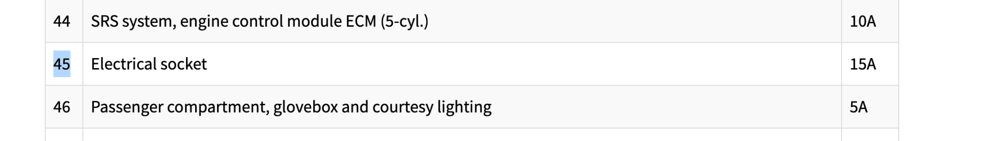

I checked the Electrical socket fuse 45 (15amp) was fine but replaced anyway.
(read somewhere here they share a fuse)

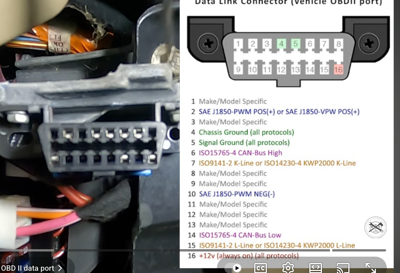

I checked the voltmeter on +pin16 and Grounds 4+5, no voltage
next steps suggestions?
can/should i rewire power to the port from another 12v?

That is strange. If that is your OBD2 port and the list on the right s what pins should be in use on your car, there seems to be the following issues:
1) Pin #9 has a connector in it
2) Pin #10 does not have a connector in it
3) Pin# 15 is missing a pin.

Ok,
It was fuse 57, 15amp.
Says it’s also the break light switch..
But without the fuse, break light is still working….
When I put a new fuse, it Immediately burns…
Any suggestions finding the issue?
