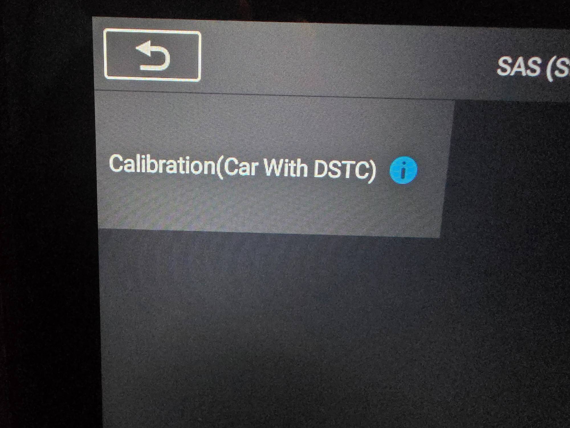

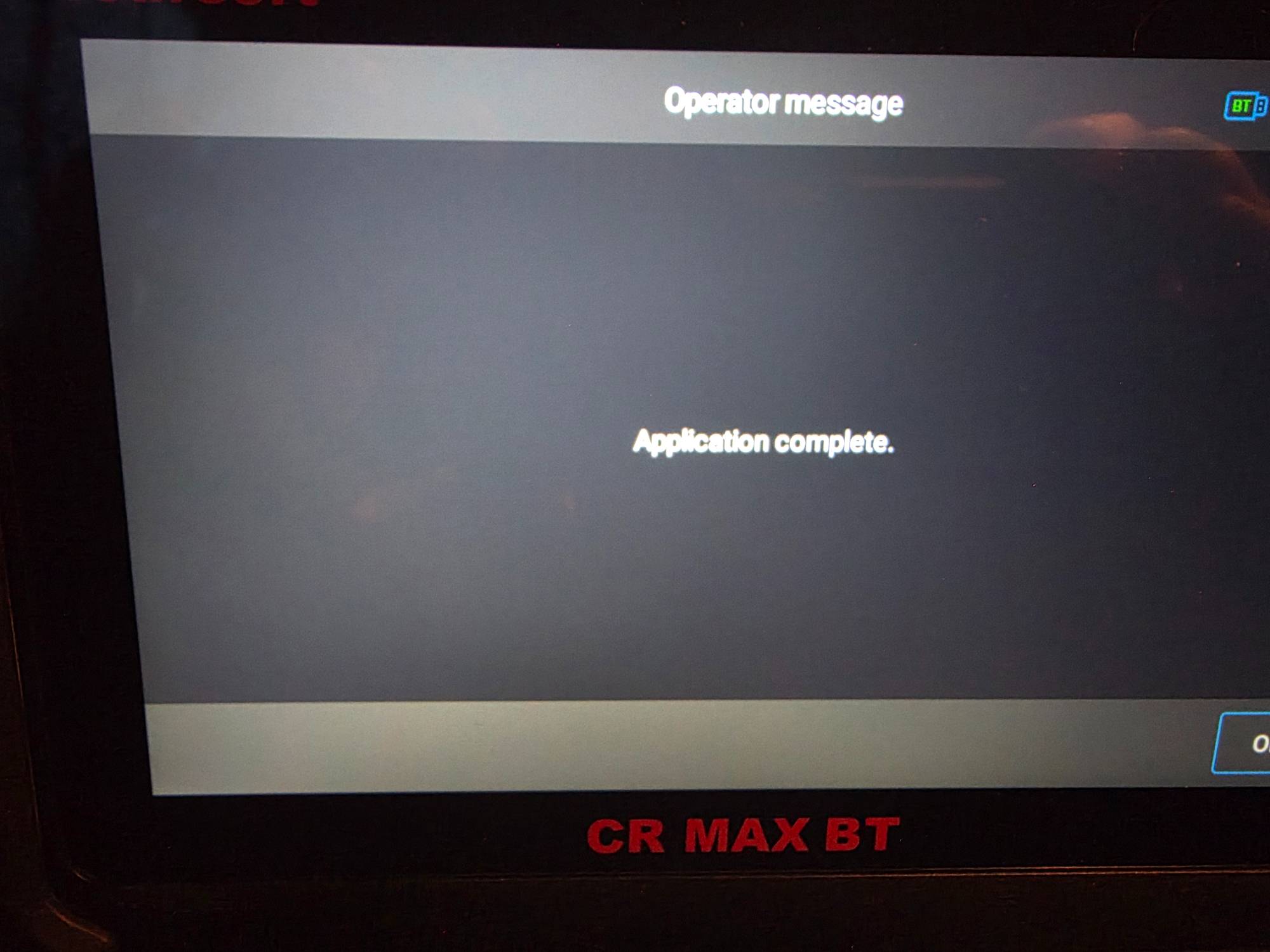

Quick update... I uploaded my diagnosyic scan to the icarsoft team and they said that I need to reset the Steering angle sensor through the brake control module.. Will try tomorrow and follow up
Pretribrapper
- Posts: 129
- Joined: 10 Dec 2016, 07:51
- Year and Model: 2011 C30 2.0 T5
- Location: Wisconsin
- Has thanked: 59 times
- Been thanked: 9 times
All fixed. I was off by a single rotation. My icarsoft device gave me live steering data and I learned that I had to reset the dstc in the Anti Lock brake function as opposed to Steering Angle Sensor function. When I went to ABS function on my scanner I reset the steering angle faults there and everything zeroed out. I then went to the live data and saw the angle at zero. As soon as I turned the wheel slightly the number changed to 361° which showed me I was still off by one rotation. Turning the wheel to the right the number went down so I pulled the steering wheel off and did one full turn on thw sensor to the right. I reattached everything and took it on a ride. Everything is perfect now. Thanks again
