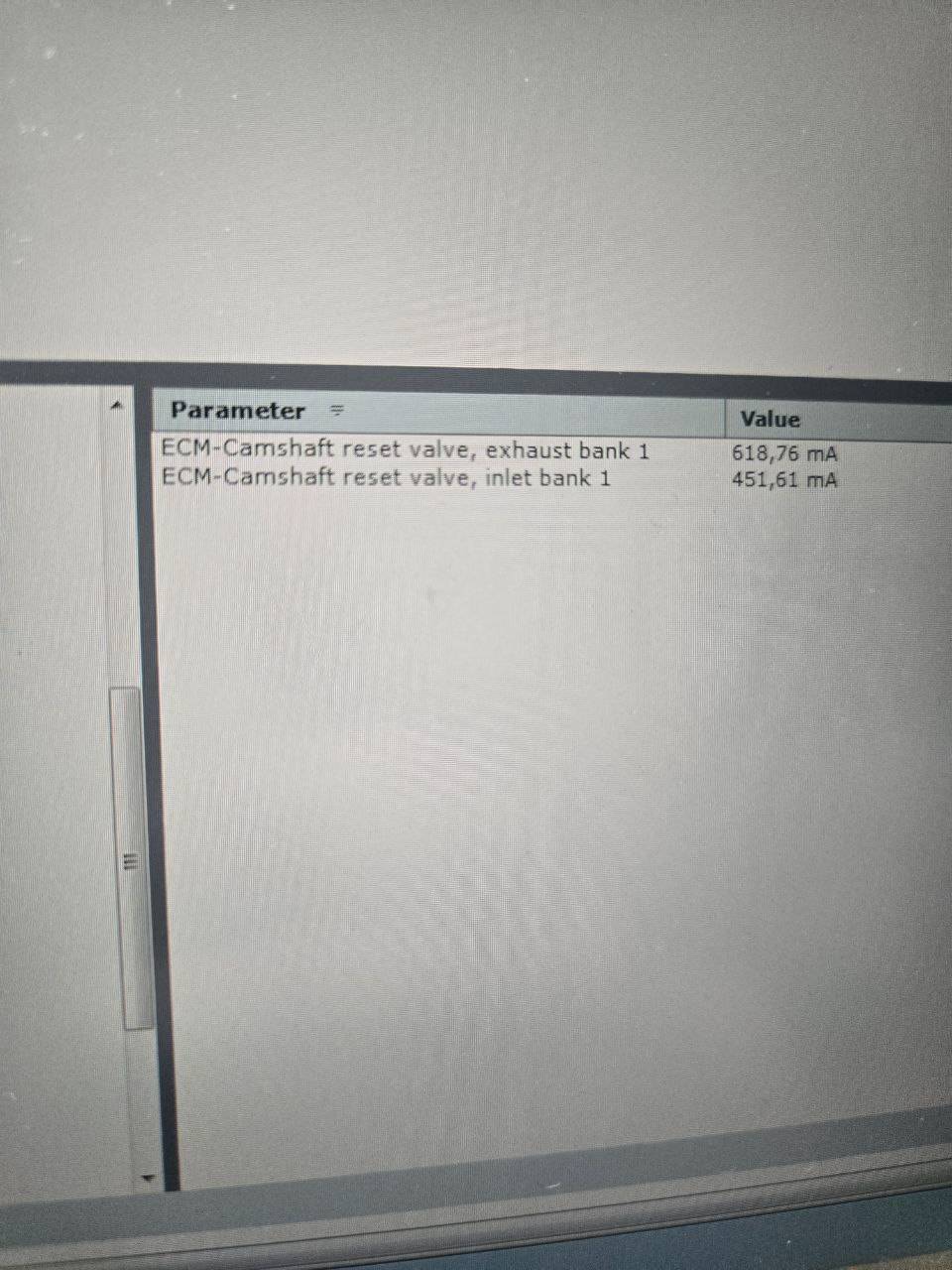

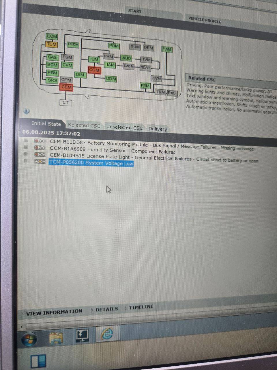

Hello! I replaced the timing belt and rollers along with the water pump for the first time. I followed the instructions, and the engine started without any problems. However, after checking the parameters in VIDA, I have some doubts. Specifically regarding the values: camshaft adaptation exhaust is 50.6, while the manual allows 54 CA ±8, but I’m still a bit concerned about this; the camshaft shifting angle — both parameters at idle — fluctuate in real time by about 4 units above and below the nominal value. Could it be that I made a mistake during installation? I’ve been driving for quite some time now, no new errors have appeared, and the car drives confidently, basically just like before the replacement.
