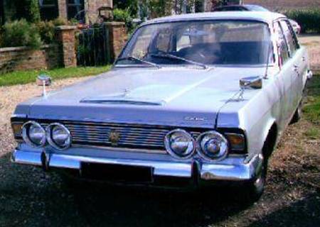

One final thing about paintwork, and this is for enlightenment only so don't try it on your own car. Many years ago I had a Ford Zodiac in Silver Grey. This car was a big, ugly brute and was often called the Dagenham Disaster. My friend, who as a master coach builder was allowed to buy Joseph Mason paint, was determined to paint my Zodiac black. Joseph Mason was the paint supplier to Rolls Royce and my Zodiac was duly prepared for its change of colour. He applied four coats of primer, each one being rubbed down by hand before the next was applied. He then applied seven coats of black with each one again rubbed down by hand but also using Fairy household soap on the wet and dry paper. By this time I was slightly tired as I was doing most of the rubbing down. I was then banished from the spray booth whilst he applied the eighth and final coat. This was allowed to bake overnight. The car was gleaming the next day. Now comes the truly amazing part. I was not allowed to touch the top coat because I didn't have the experience. He set to work with 2,000 grit wet and dry paper, Fairy soap and gallons of water. I was amazed as I saw the gleaming paint go dull. When he had finished he baked it for 30 minutes to thoroughly dry it then applied a coat of Joseph Mason's compound followed by Joseph Mason's polish. The result was absolutely amazing. As I said, don't try it on your car!
And this is a picture of a Dagenham Disaster. The bonnet (hood) was extremely long as the spare wheel was mounted behind the front grille.
