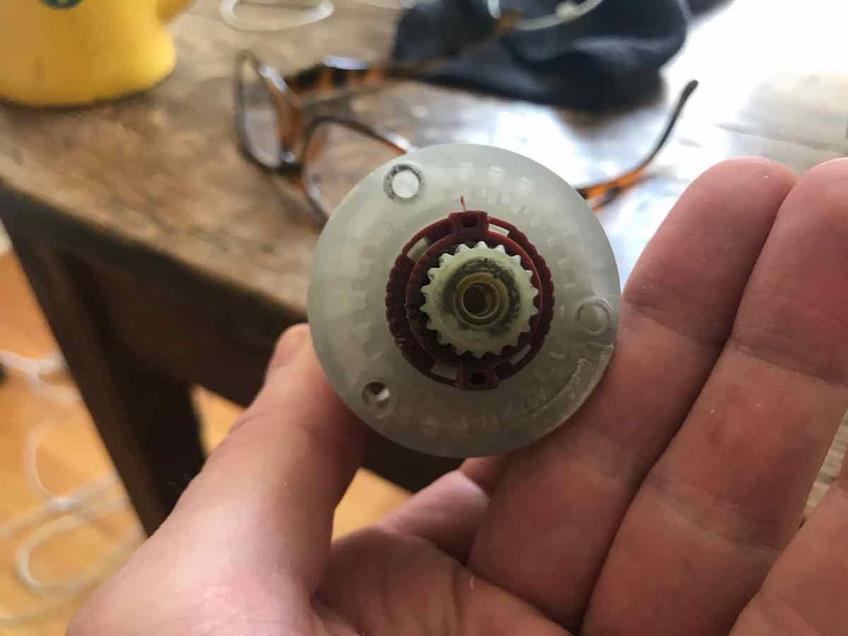

Both the water flow cold->hot balance and the noise popped up yesterday. It's very loud, louder than the video suggests.
I didn't do anything to it. It's been working fine for years. Any ideas? Do I need a new valve mixer thing? I don't know the name of it.
I took it apart today in a DIY effort to recon what's happening, but everything looks fine and looks like it should work. Upon reassembly and reinstall, same problem.
No water is leaking into the basement.

When you go to get one, it's called the shower diverter. If you can figure out which brand and model you have, then you might be able to get a re-build kit from a plumbing supply house or online.

I'm thinking that some rubber parts are loosing their tension and beginning to act like a reed and vibrate / hum with just the right amount pressure.

I was just going to say the rubber has hardened and is causing some kind of resonant frequency as the water passes by a certain flow rate.Sveedy wrote: 08 Jun 2021, 17:32 I'm thinking that some rubber parts are loosing their tension and beginning to act like a reed and vibrate / hum with just the right amount pressure.

New valve ordered. Should be here Thursday.
I tried tightening down the cartridge screws even more, but it didn’t help.
