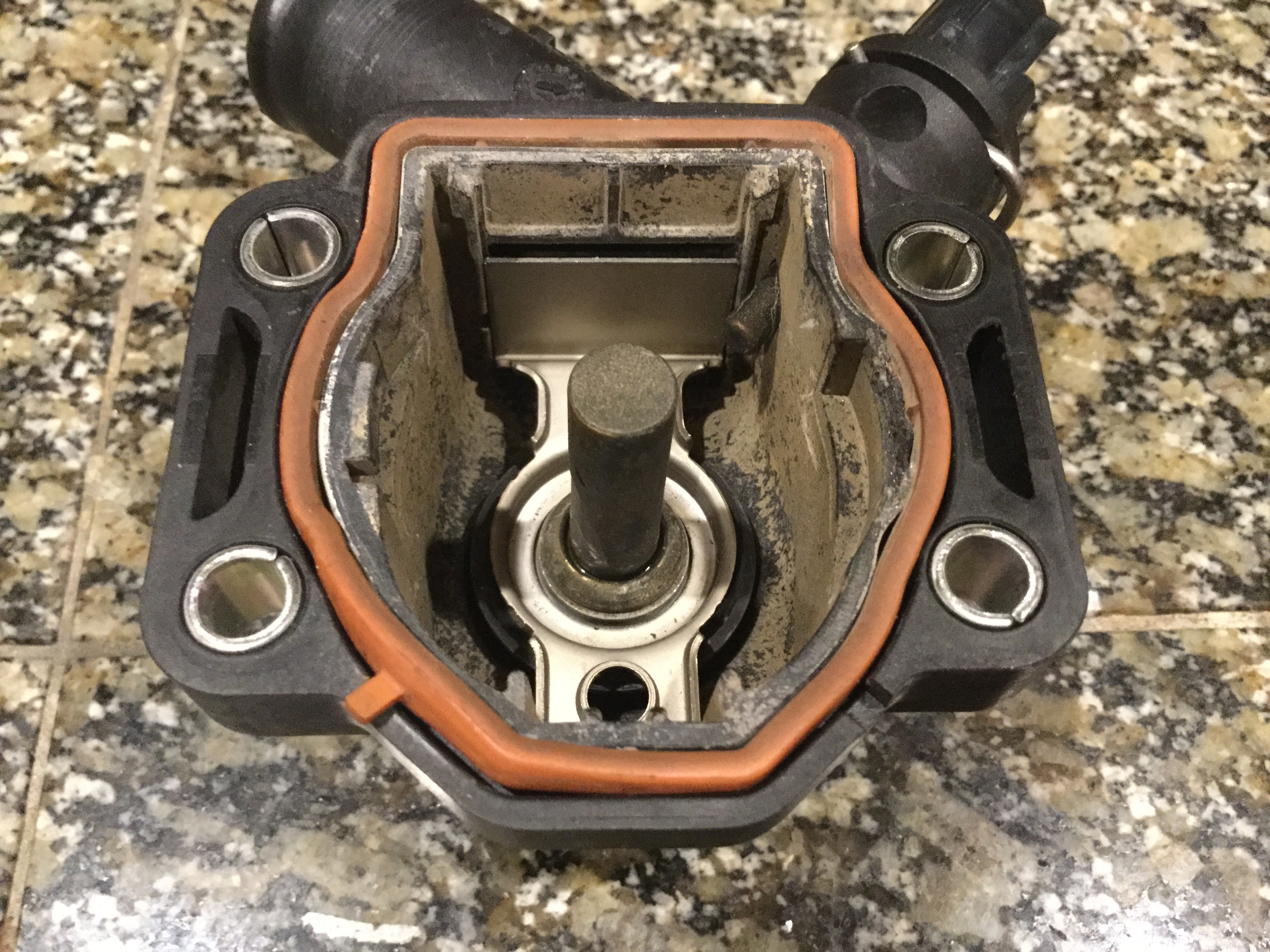

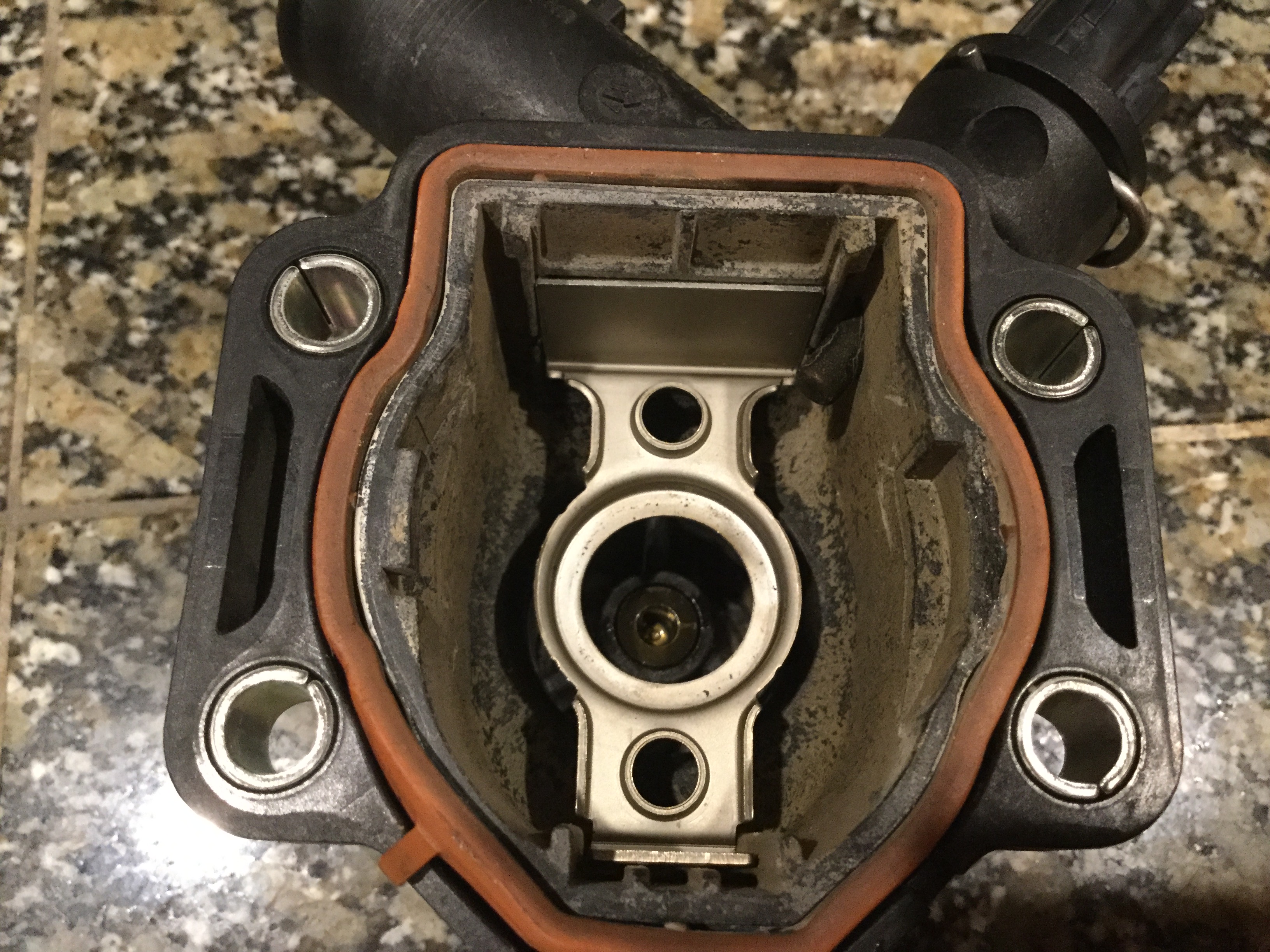

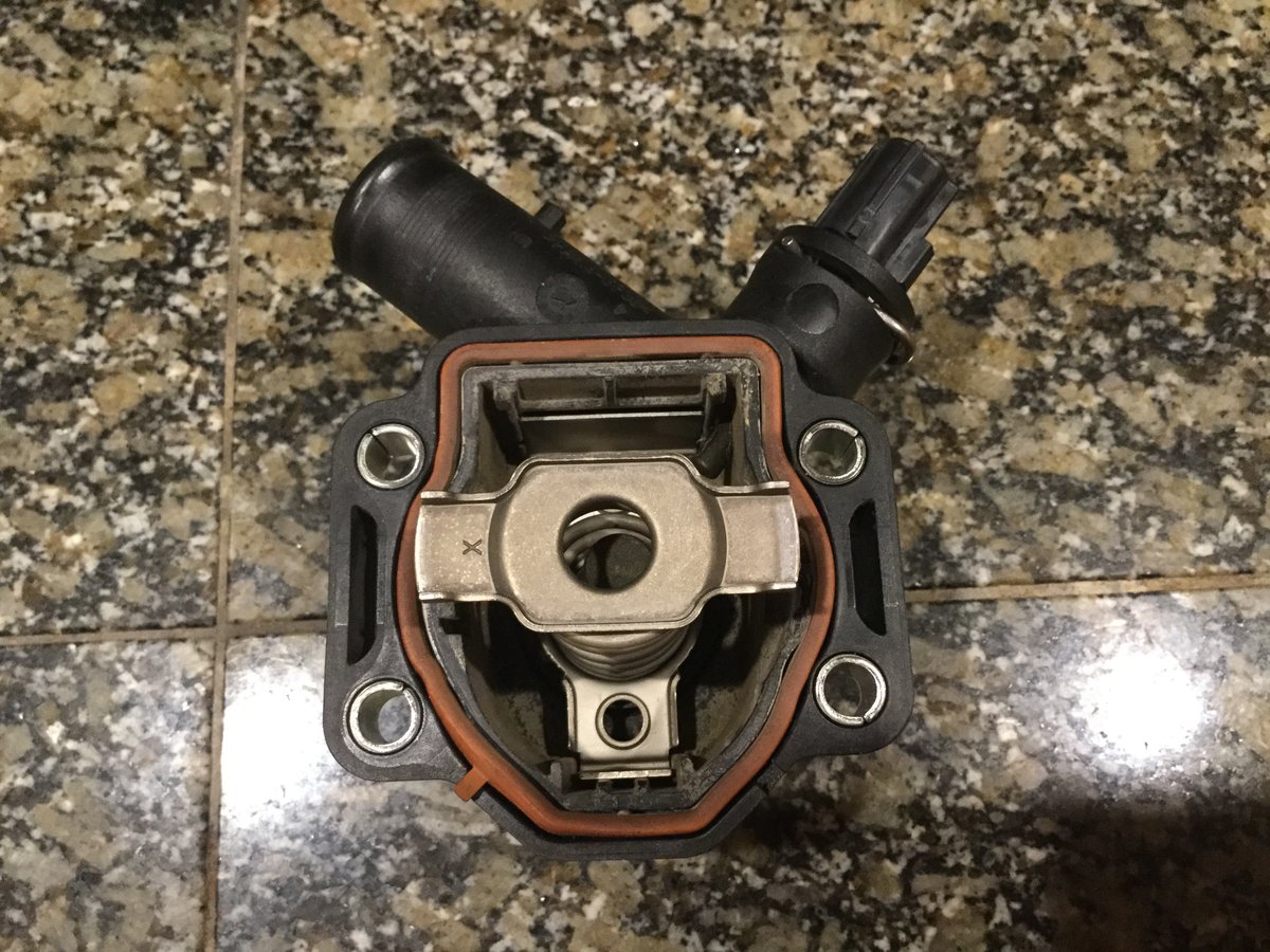

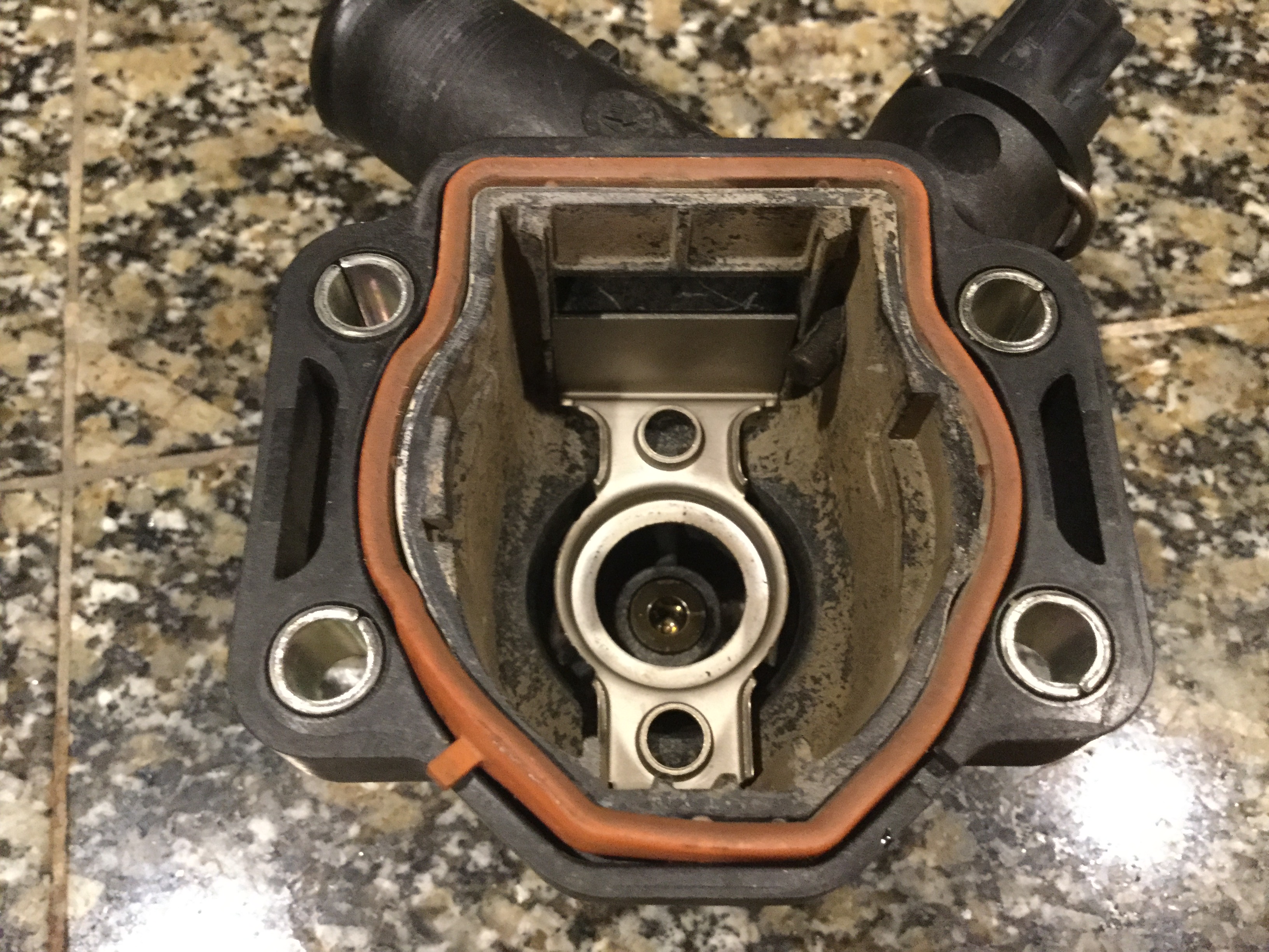

I agree with your assertion that thermostats should fail open but the thermostat in the 3.2 is not your typical thermostat.
Hot thermostat - the silver bracket is blocking the recirculating port
Note: silver bracket moves up and down as thermostat opens and closes Better picture of recirculating port blocked Recirculating port open Picture shows two paths for coolant (recirculating port or radiator) Open thermostat Closed thermostat

I'm a bit confused on this housing design.. so normally the thermostat part (the black unit with the pin) extends the pin when hot and retracts it - in fact the small spring puts pressure forcing the pin to retract - as it cools down. As it gets old, the pin in these wax thermostats won't fully retract when cold even despite the coil pressure (I guess the wax inside gets dry and doesn't melt any longer, so the pin doesn't have place to retract)
I'm rather under the impression that in pic#2 the pin is fully extended and the recirc port opened (radiator gets flow), while in pic#3 the pin is fully retracted and the port is closed?

The Thermostat design is complicated

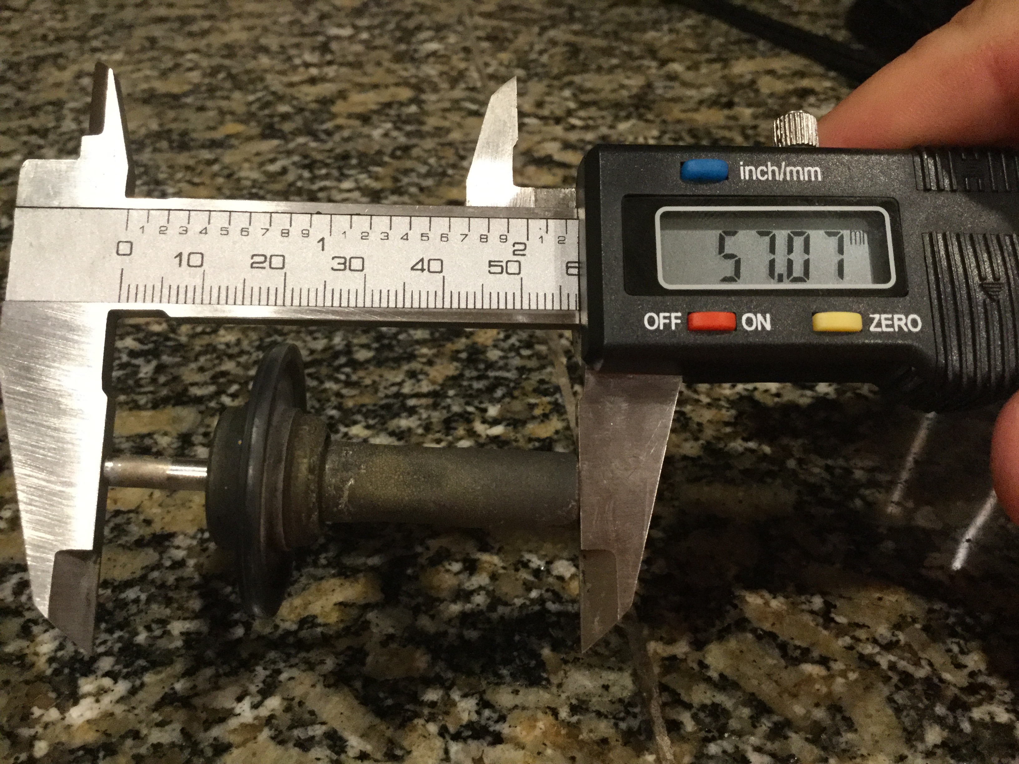

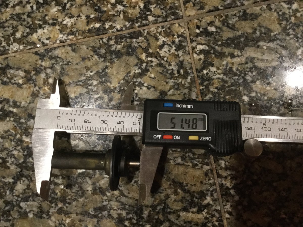

Note: I did heat up the actuator to get it to extend, the shorter measurement was with it at room temperature. (see picture above)

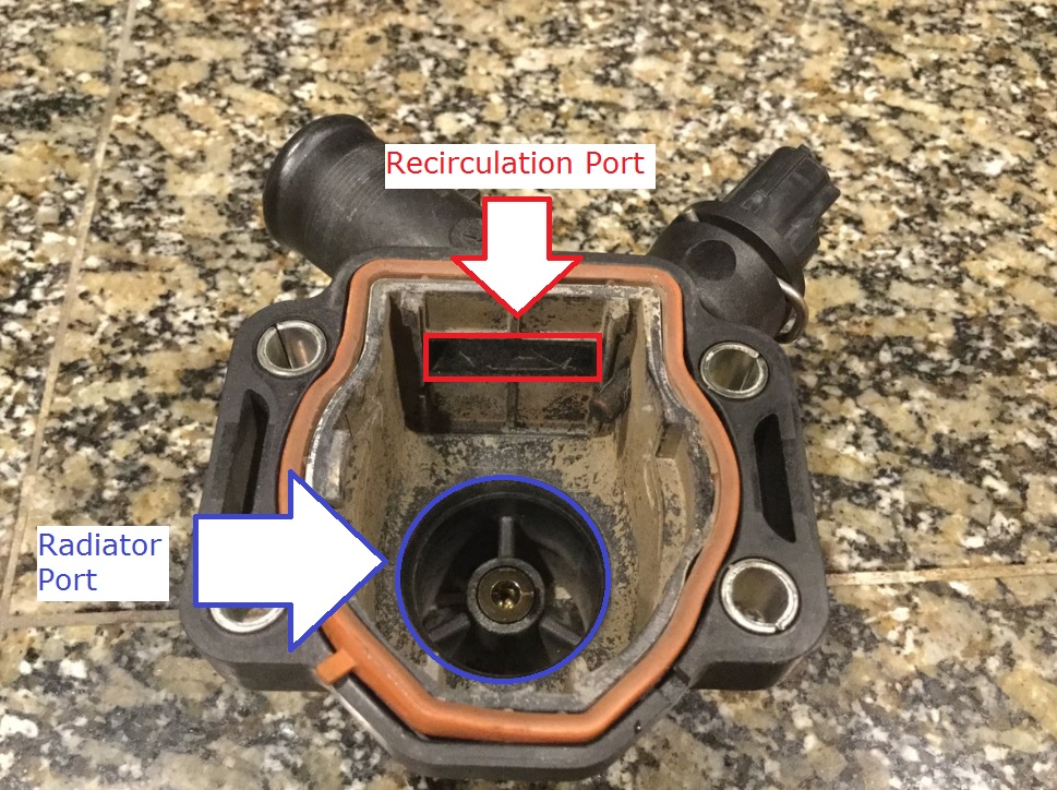

This first picture below shows the two paths for the coolant
- Recirculating (back to the engine)
- Radiator
Engine Cold
Actuator is retracted pre load of the spring is blocking the port to the radiator
Open - Recirculating (back to the engine)
Closed - Radiator
Engine Warming
Actuator is partially extended the port to the radiator partially opens and the recirculating port partially closes
Partially Closed - Recirculating (back to the engine)
Partially Open - Radiator
Engine Hot
Actuator is fully extended the port to the radiator fully opens and the recirculating port fully closes
Open - Radiator

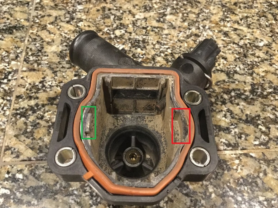

For the next picture I highlighted the failure point of the housing
The black plastic tab breaks off and the spring is no longer under tension
Note: mine broke 5 minutes after removal, another XC70 owner had his break in the same location and he got a temperature warning
The Red box shows the broken tab (missing) and the green box shows an unbroken tab
The plastic tabs hold the cross member which maintains the pressure on the spring
The failure mechanism is not the typical actuator wear out
Thanks
Paul
- Radiator
Engine Cold
Closed - Radiator
Engine Warming
Engine Hot
Open - Radiator

I just pulled my thermostat yesterday and found that one of the tabs circled was broken with the spring and cross member sitting in the block... I also received eng temp warning after sitting with AC off for a while then starting to drive.

Very interesting, appreciate the details. Simply it's a very poor design with plastic parts exposed to heat that keep the spring under tension. Normally it should have been the actuator that would fail as mentioned above, but since the housing is this fragile, you guys have a much worse problem on hand.
I assume these tabs gave up at close to 10 years age? If so, this part becomes a must be replaced item at no more than 7-8 years old.
Is the thermostat easy to access?
