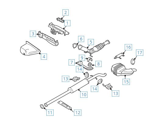

  • I currently have an exhaust leak. The pipe right after my cat has completely rusted and will need replacing/patching. However, after surveying the exhaust system, it's looking pretty rusty, and I've decided that I might as well take this opportunity to replace and upgrade some exhaust components.
Here's a picture of the exhaust system:
I'm thinking a 3" downpipe, followed by the stock cat [5] and then a straight pipe to the back muffler [15]. The middle resonator/muffler [10] is quite rusty, so I was thinking of taking it out.
I'm hoping to get a nice sound, but I truly have no idea what it's going to sound like - kinda just hoping for the best.

  • Went to an exhaust shop to see if I could get a custom downpipe made and the resonator deleted, but the guy refused to do anything... said the car was too difficult to work on. That was the first and last time I go see that guy, but at least he fixed my exhaust leak for free!
To-Do
  • Going to look into aftermarket exhaust upgrades - I particularly want a downpipe upgrade and a new cat converter.
