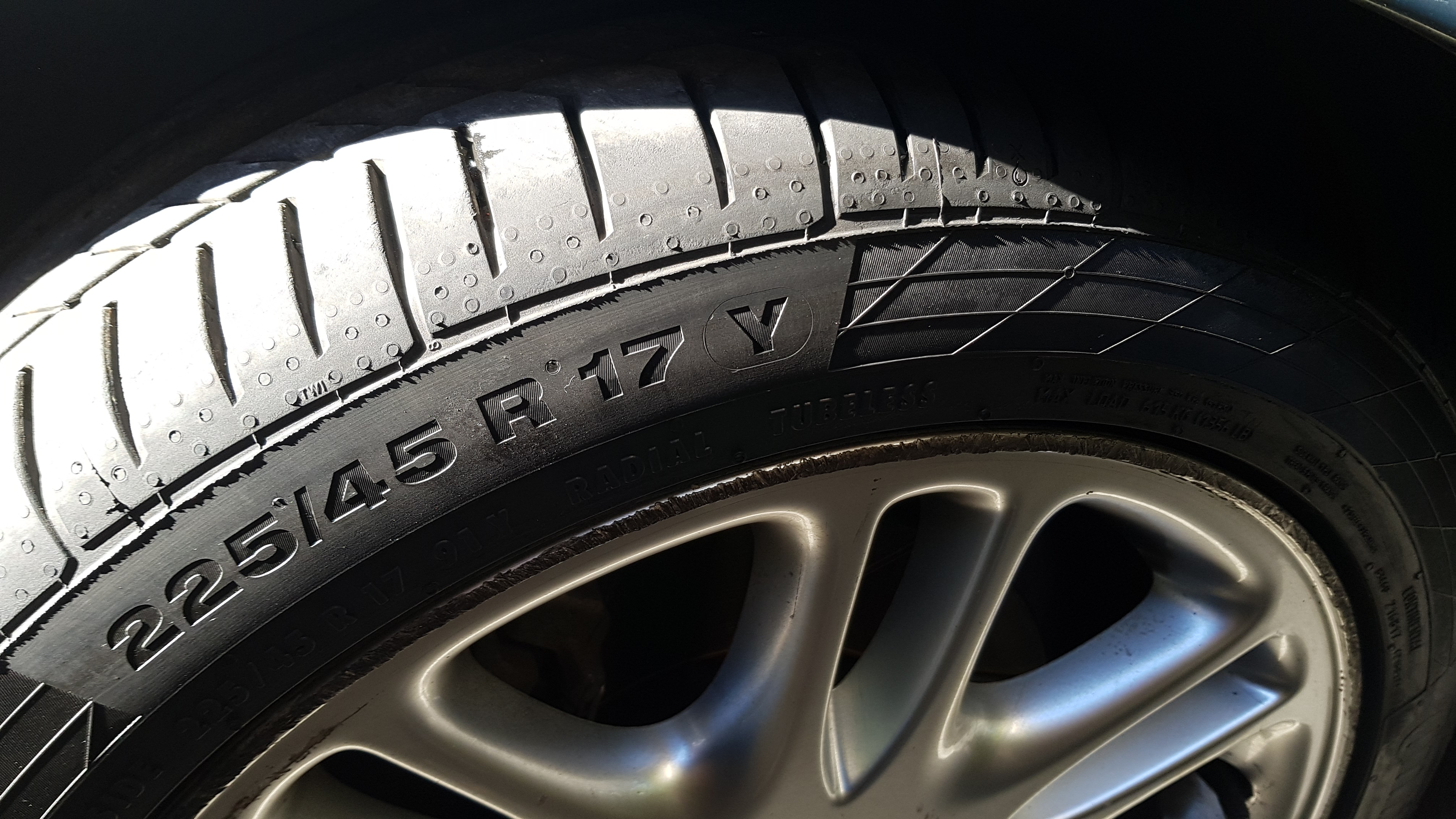

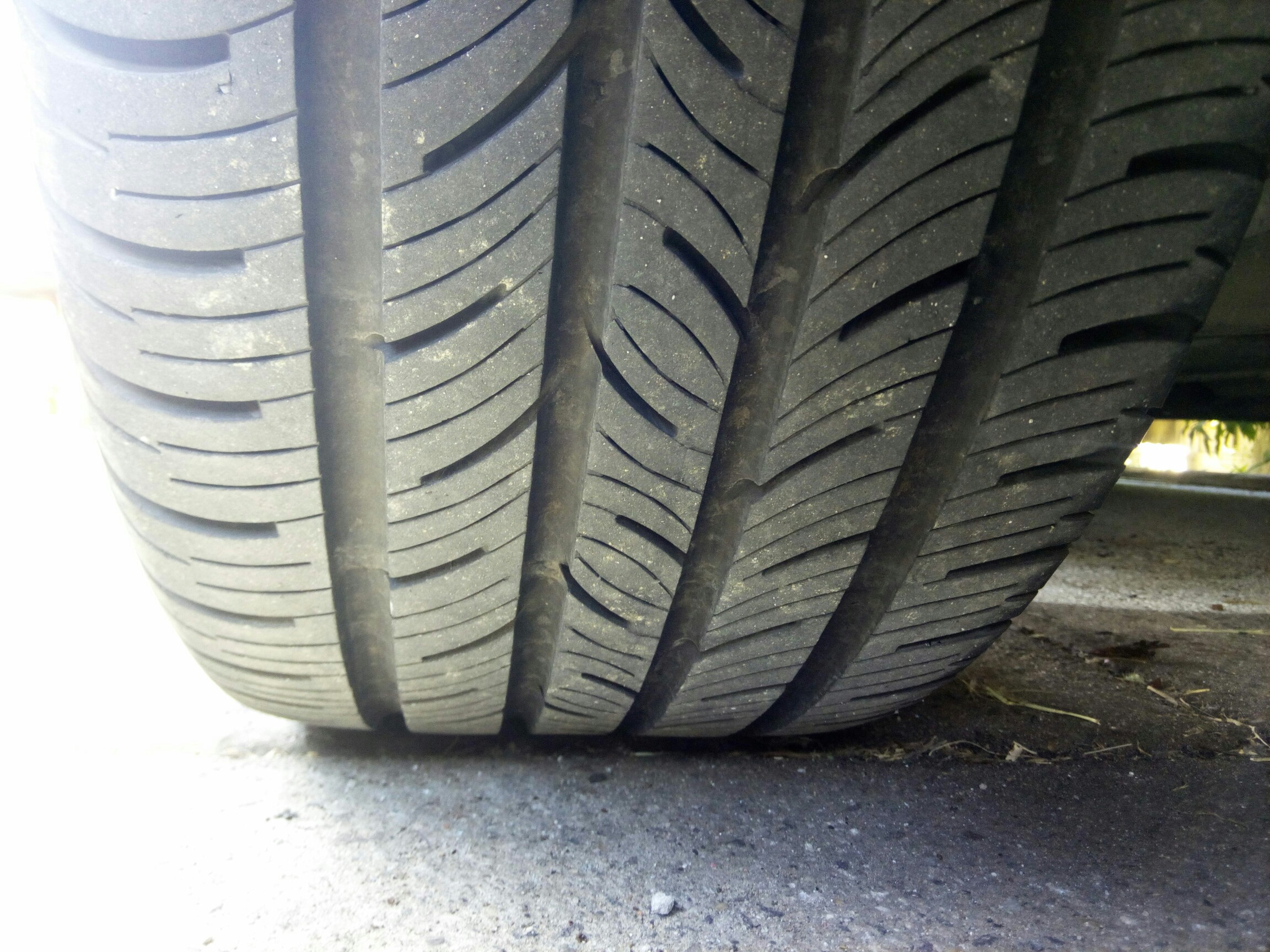

Front tyres with Maxxis Victra 511s 225/45/17 and rear tyres with Continental ContiProContact 235/45/17
Conti tyres were about 7 years old and were in storage in my shed
Alignment was done at Continental Tyre Service Preston

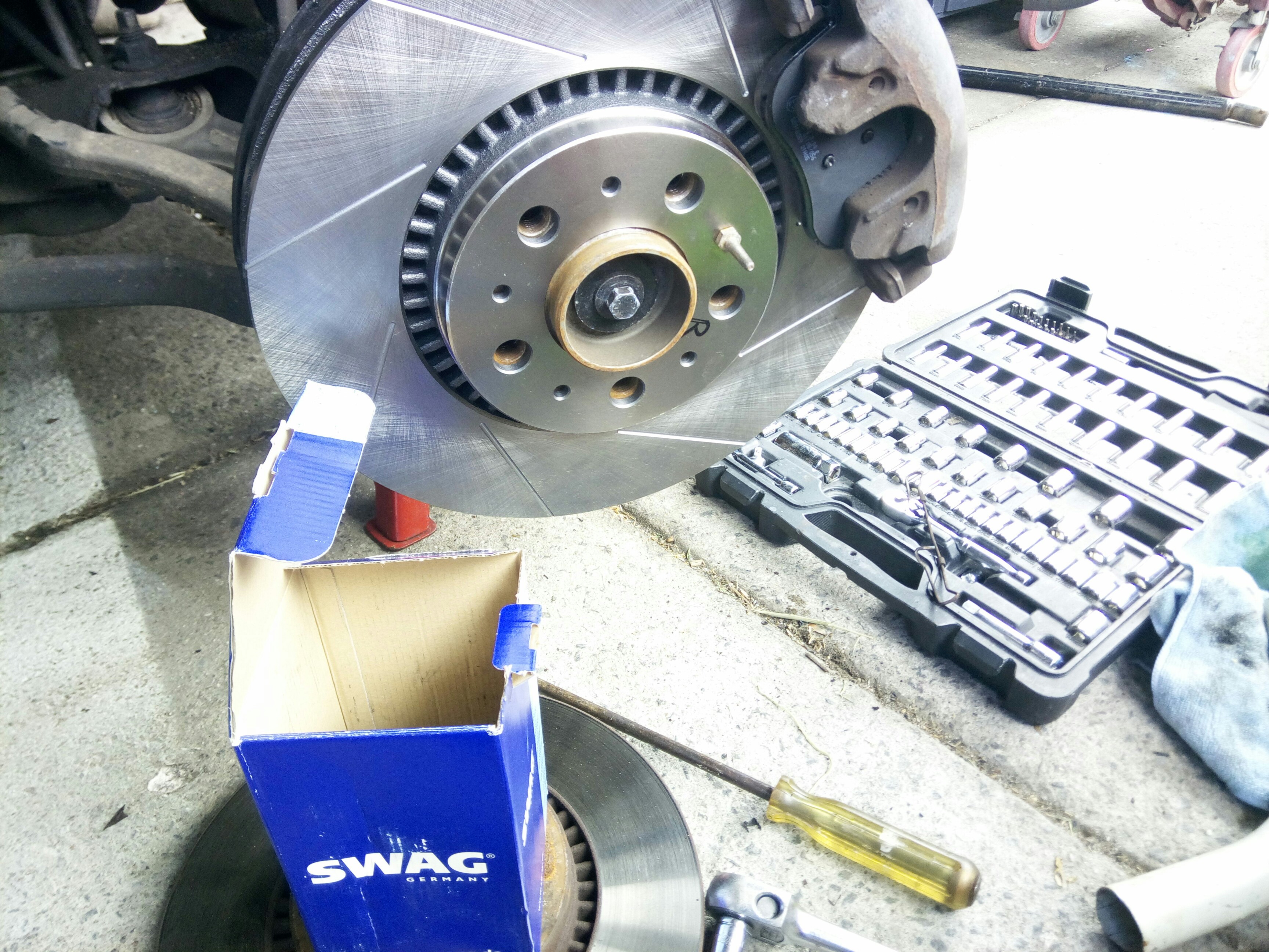

Front rotors (V Max slotted from eBay seller performancecarpartsonline) and front pads (Swag)
Rotors have 20,000km warranty

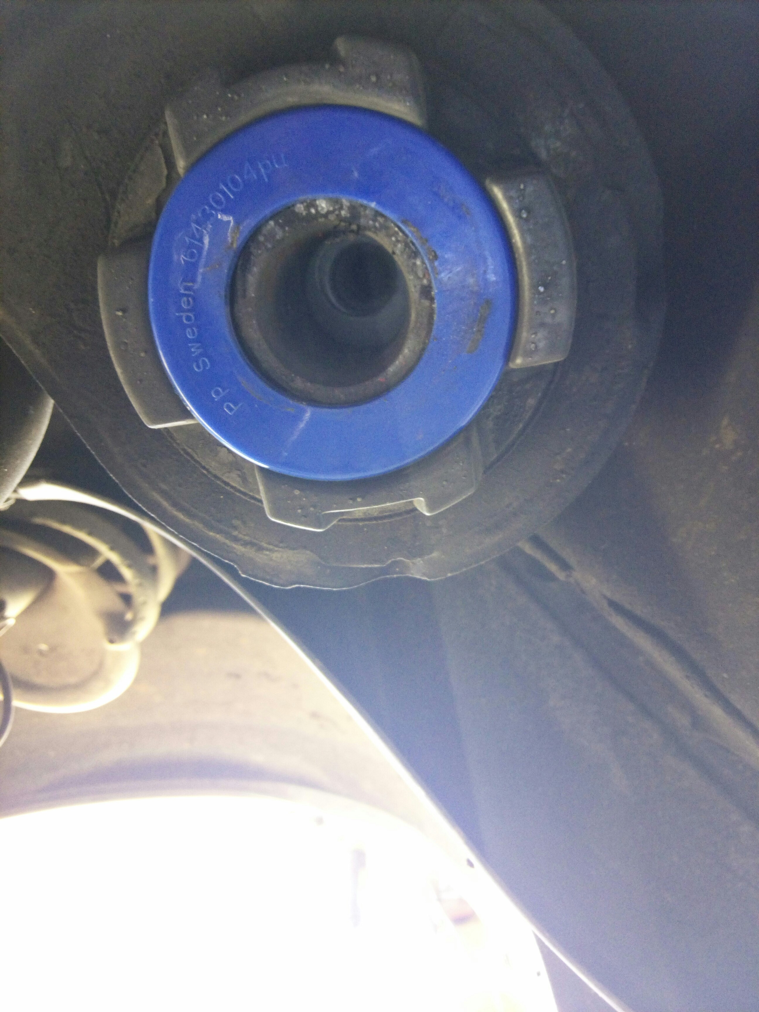

Polyurethane cross member bushing inserts from Pro Parts

Creaking and groaning from front suspension when changing direction at low speed seems to have stopped. Brakes feel great with good bite and no more vibration.
In fact the whole front end feels tighter and better tied down on tight turns.....noise from front end is gone.

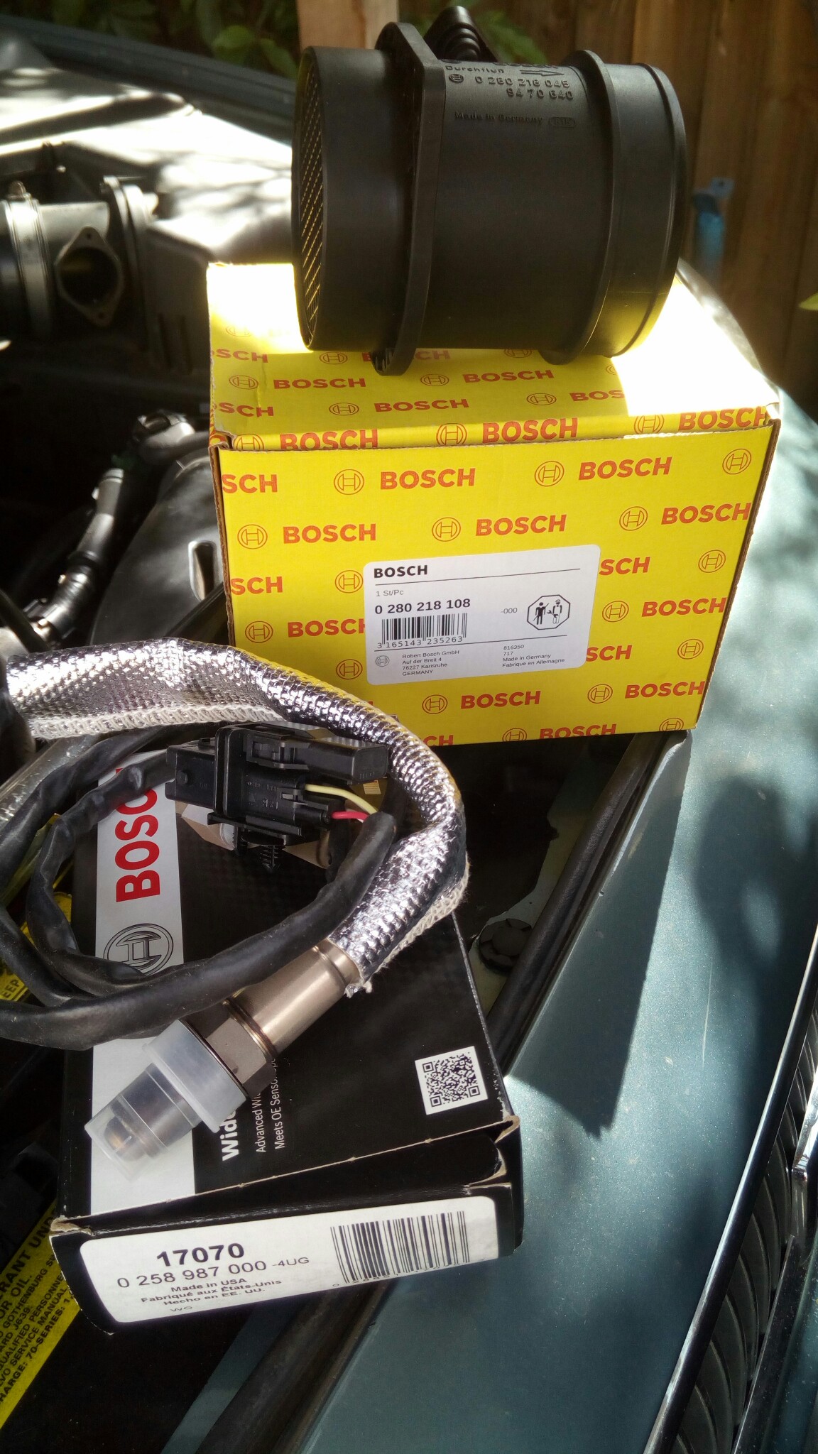

Fitted a new Bosch MAF. Box was marked 0280218108 yet MAF was marked 0280218045 (the old OEM number) I ordered 2 MAFs and opened up both of them to check the inserts. They both had the same Bosch number on them even though body numbers varied.
Also fitted a new front Air/Fuel sensor p.n. 17070 or 0258987000
as the old one was open circuit on the heated element.
Cost was around AUD$250 shipped for both.

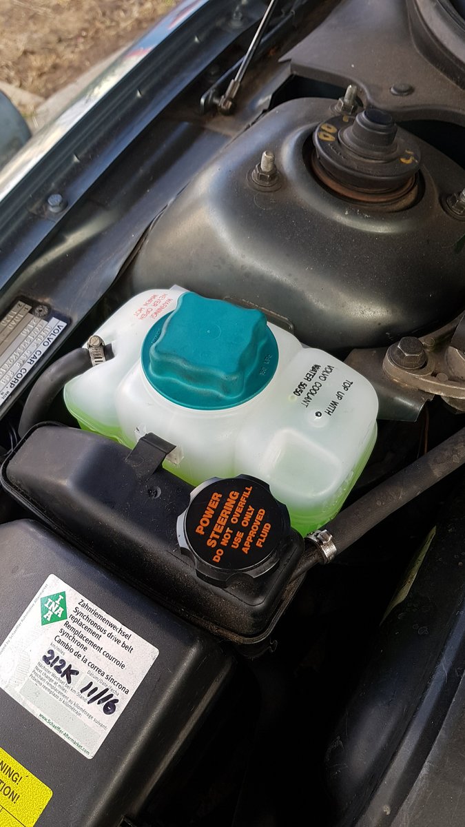

Replaced the coolant reservoir today with a Volvo genuine one part number 30741973.
Cost $81.50 from SMG

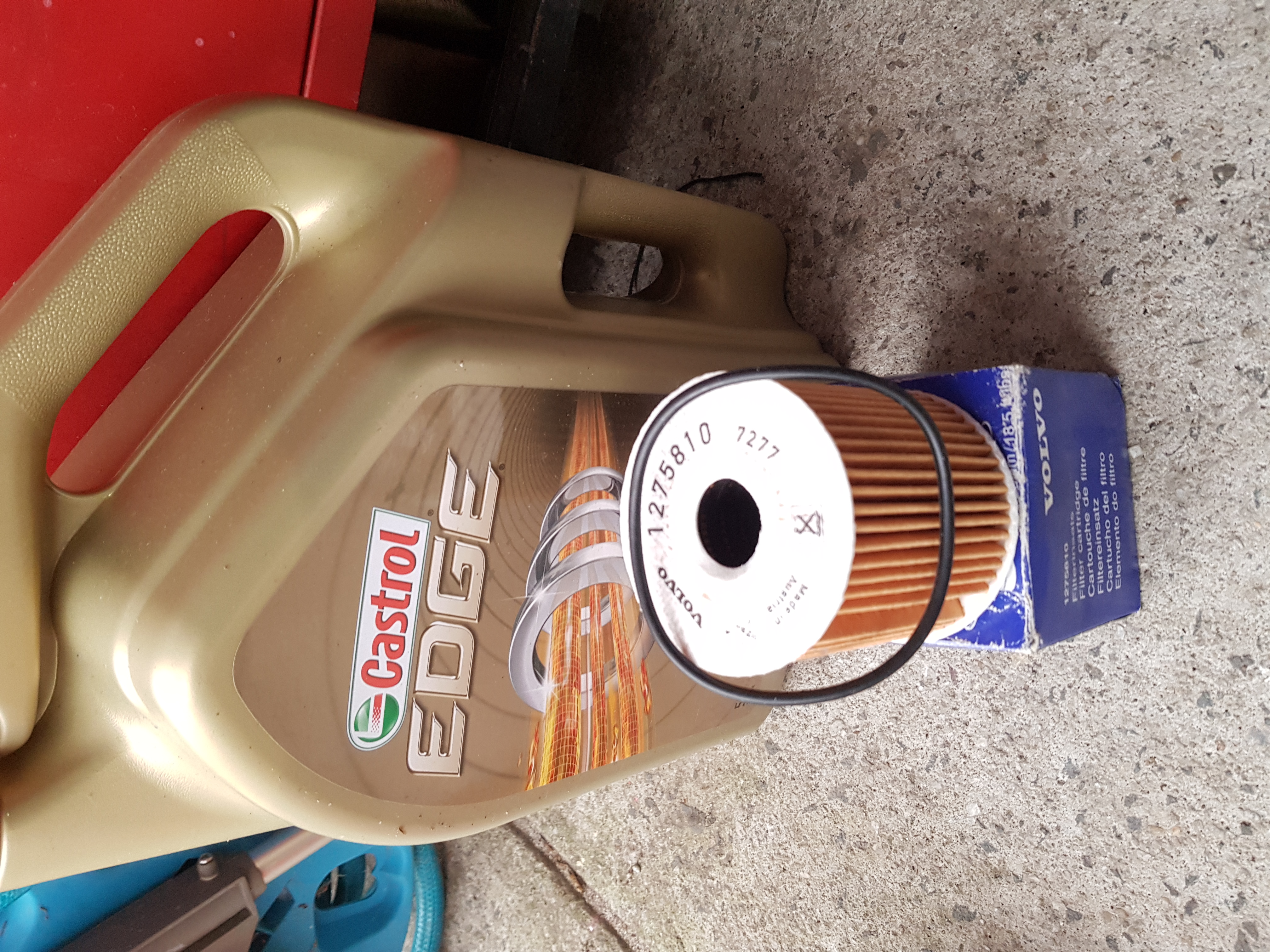

Replaced oil and filter with Castrol Edge 10W30 full synthetic and Volvo 1275810 filter @ 241,012 kms
New oil cap seal and crush washer as per all oil changes.
Cost approximately $65.00

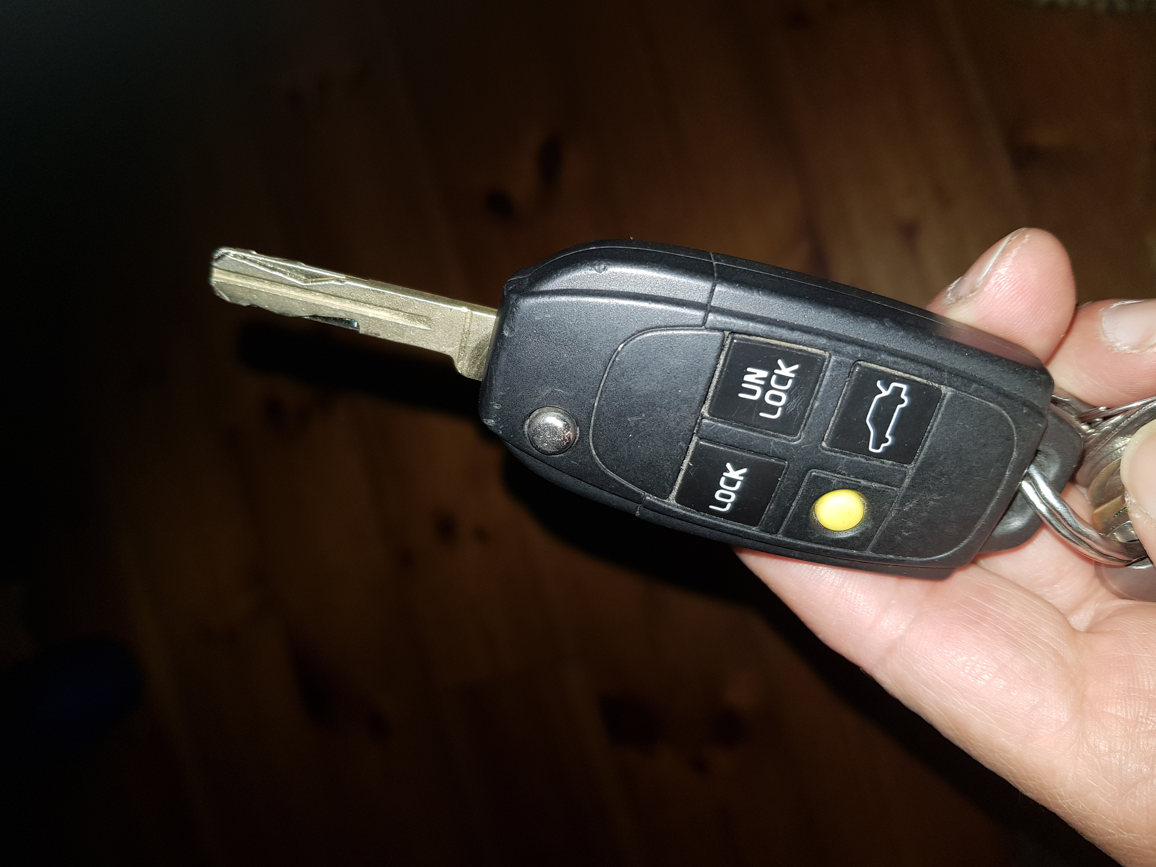

Finally cut a spare key at Amalgamated Locksmiths in Collingwood (great bunch of guys) who were able to get the exact key code for the cut by scanning the profile of my old key. They even gave me a printout of the key codes in case I want it cut again.
I had Henry remote in and program a new ID48 transponder for me.
All up cost about $120 but well worth it to have a fully functioning spare key
